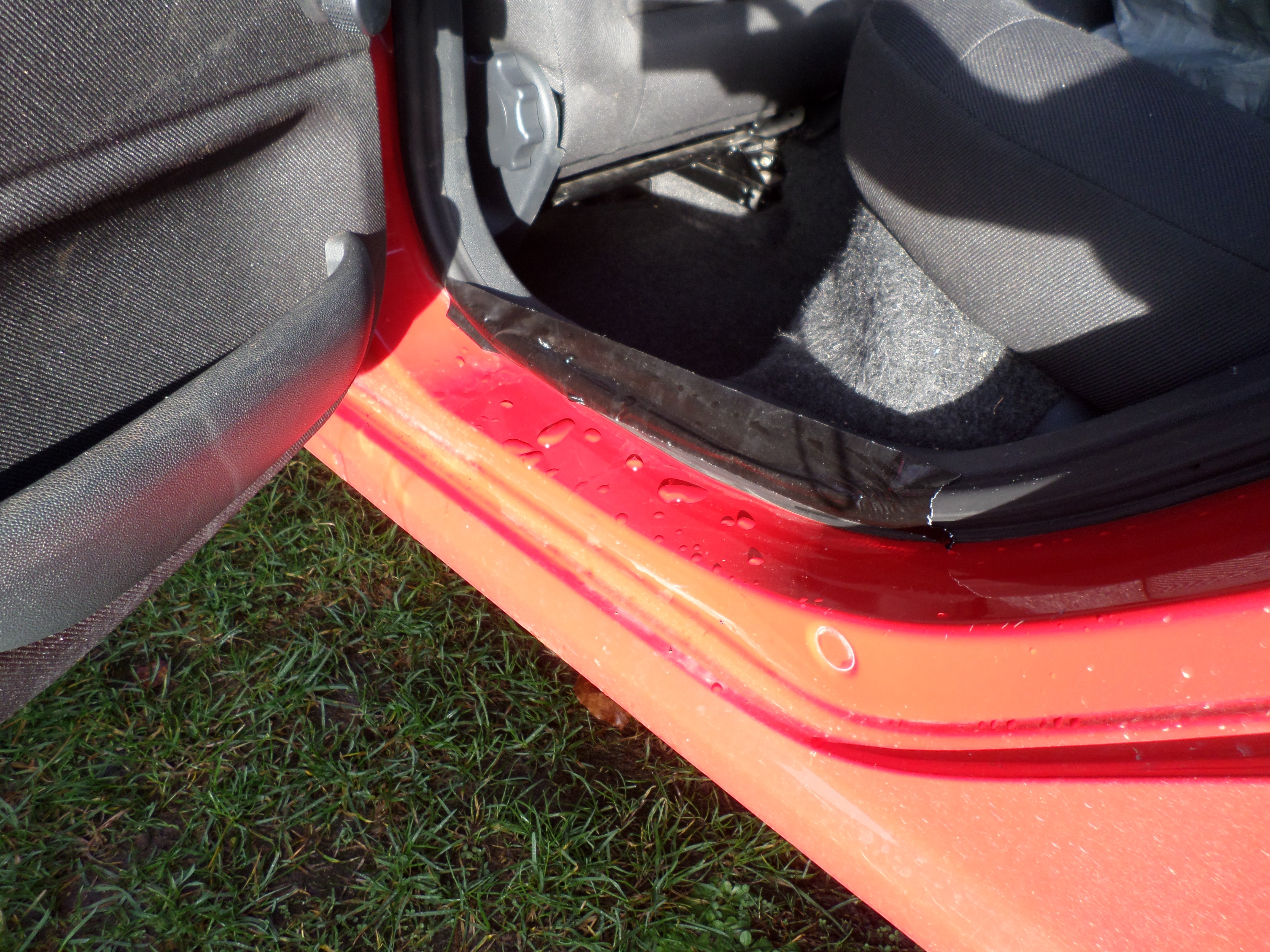

And if you don't fancy doing the fix in this weather someone did post a photo of his temporary fix- waterproof tape over the rubber seals on the sill/rubber joint. I did this temporary fix at the end of summer and my rear floors are drying nicely. Hopefully once we get another warm summer, the damp will be gone. And if my round tuit arrives I'll sort it out .

I did a temporary bodge using gaffer tape and posted a photo..
I note that the photo is dated December 2018, the tape is still there, still doing the job.
Looks like the one I posted about. Strangely enough I had my fronts done under warranty in 2007 and I've had no problems since. I never found out if they sealed them as service manager said if the cards were screwed in they replace the seals ,if riveted they seal . Now if I could only get the Skoda techs round to my windows . Fitted by ( IMHO) botchet & scarper , their maintenance team have spent 3 years trying to eliminate drafts.
