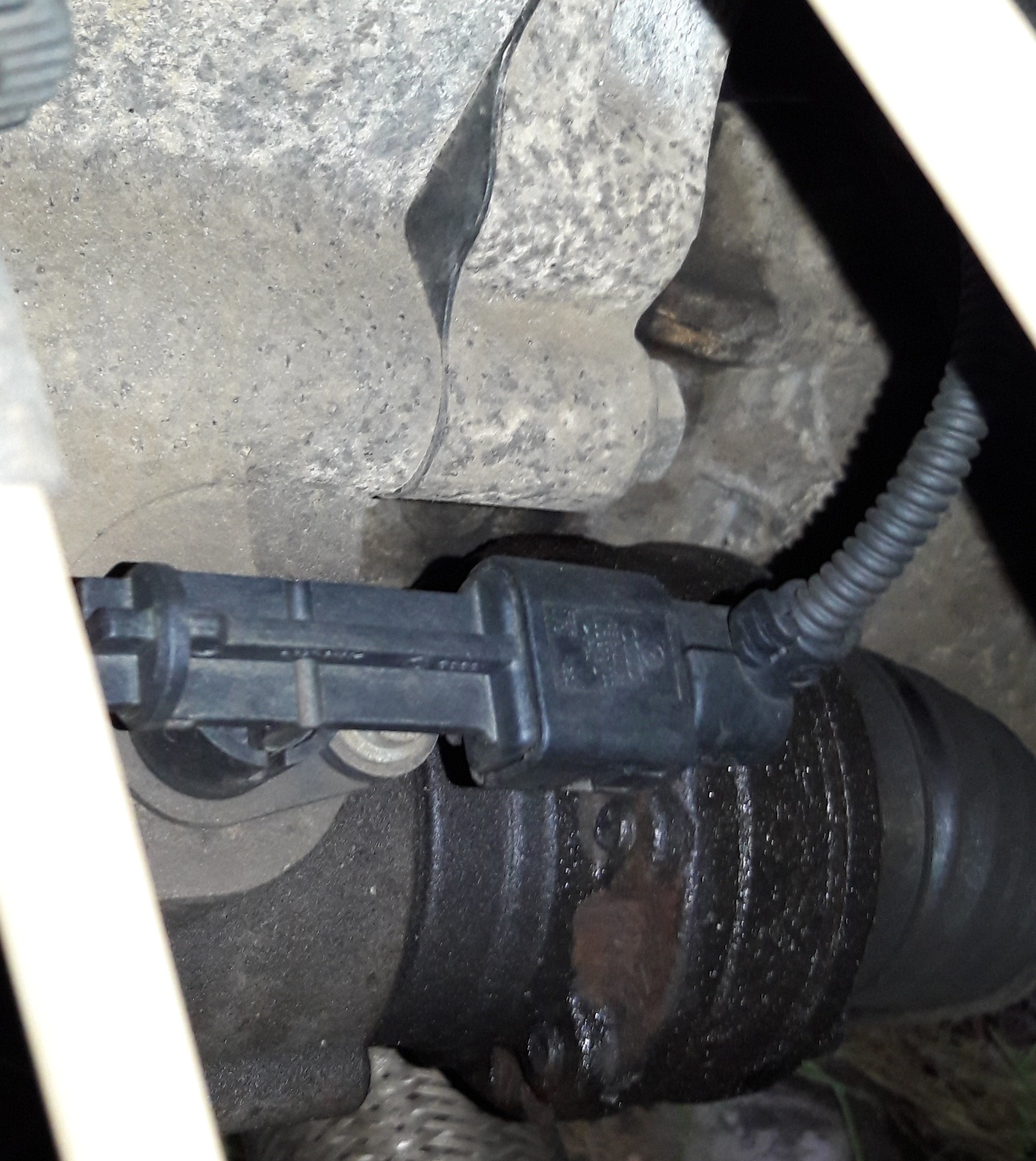

what is the sensor on the gearbox then I'm confused?

A dummy speed sensor. Plastic thing? Unplug the cable and look at what it goes onto, no electric connections?
yes there is an electrical connection.  This is a speed sensor on the gearbox.

Please read again what I wrote.
Look at the part that the electrical connector goes onto. Are there any metal bits?
  • Sponsor
If it looks like this, it's a dummy sensor. Inactive.

I replaced the speed sensor on the gearbox.  the problem has been solved thank you for your help.
