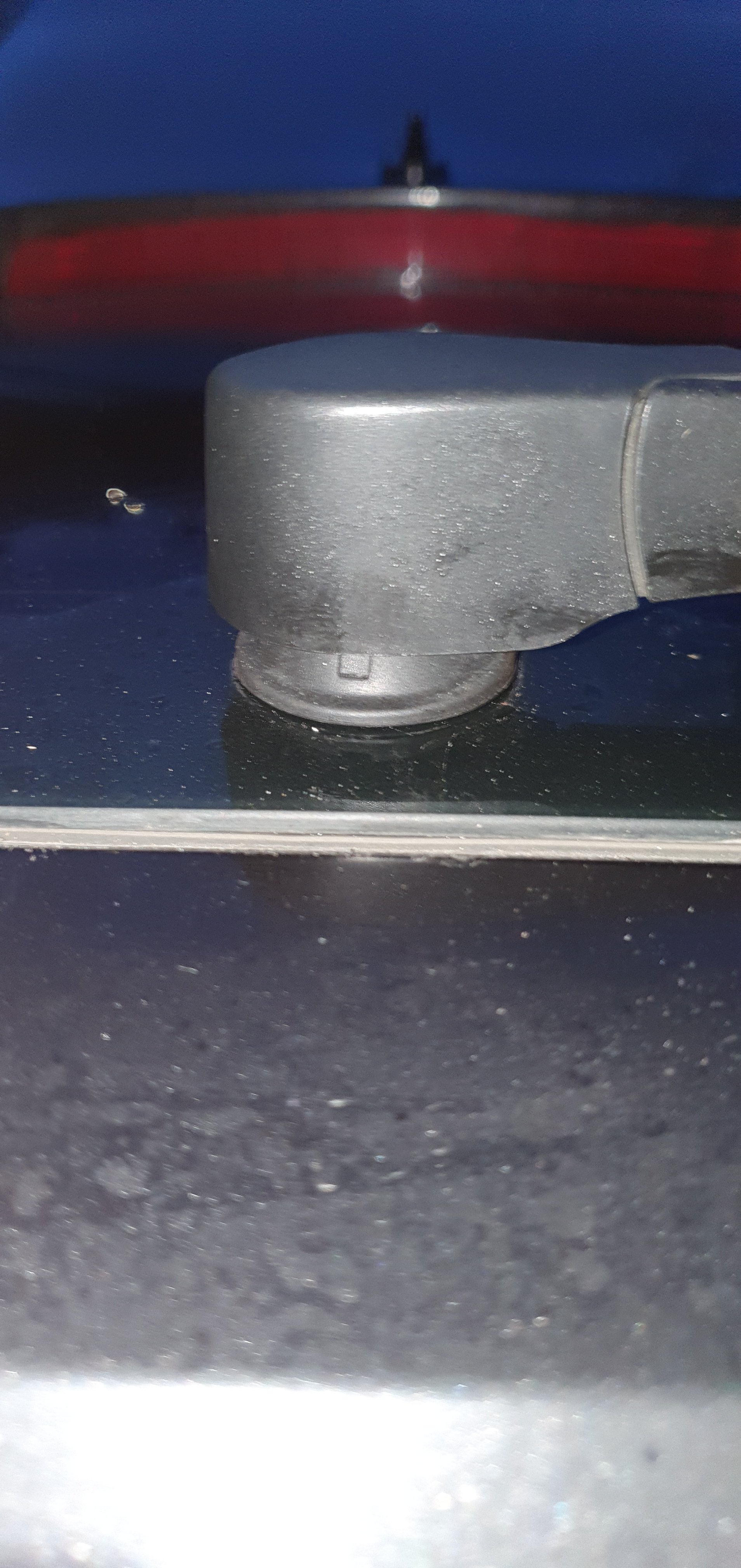

I took the car to the Skoda service today, and they said that the rear wiper and between the glass there was some gummy ring that was leaking.

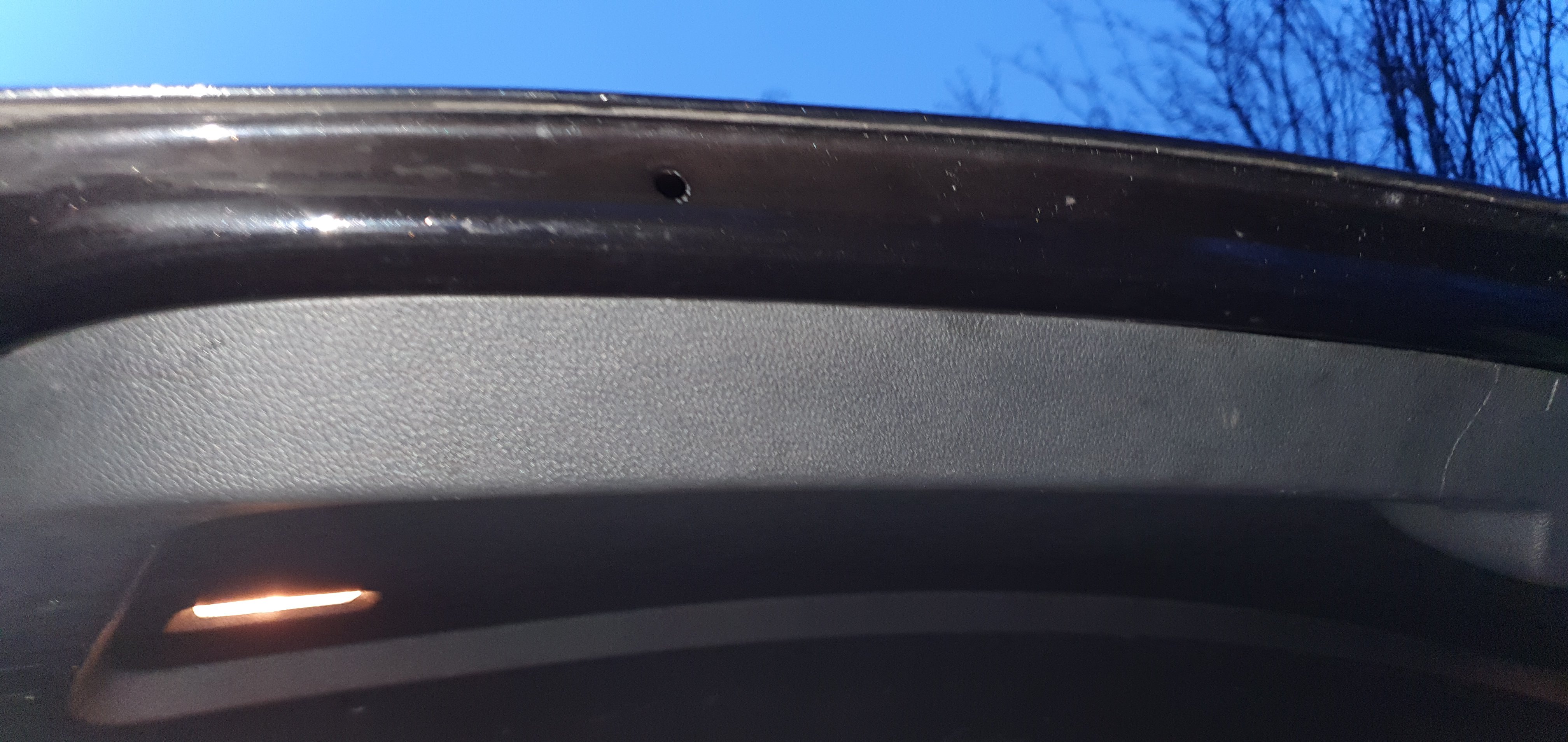

Plus they removed 3 bungs(gummy rings) from the holes on the bottom of the tailgate l, so the water can come out. I do not think it should be removed (rust problems later on) but they did it anyway. I would like to ask somebody to take a picture of those bungs from outside (if you have a stationcar/wagon).
