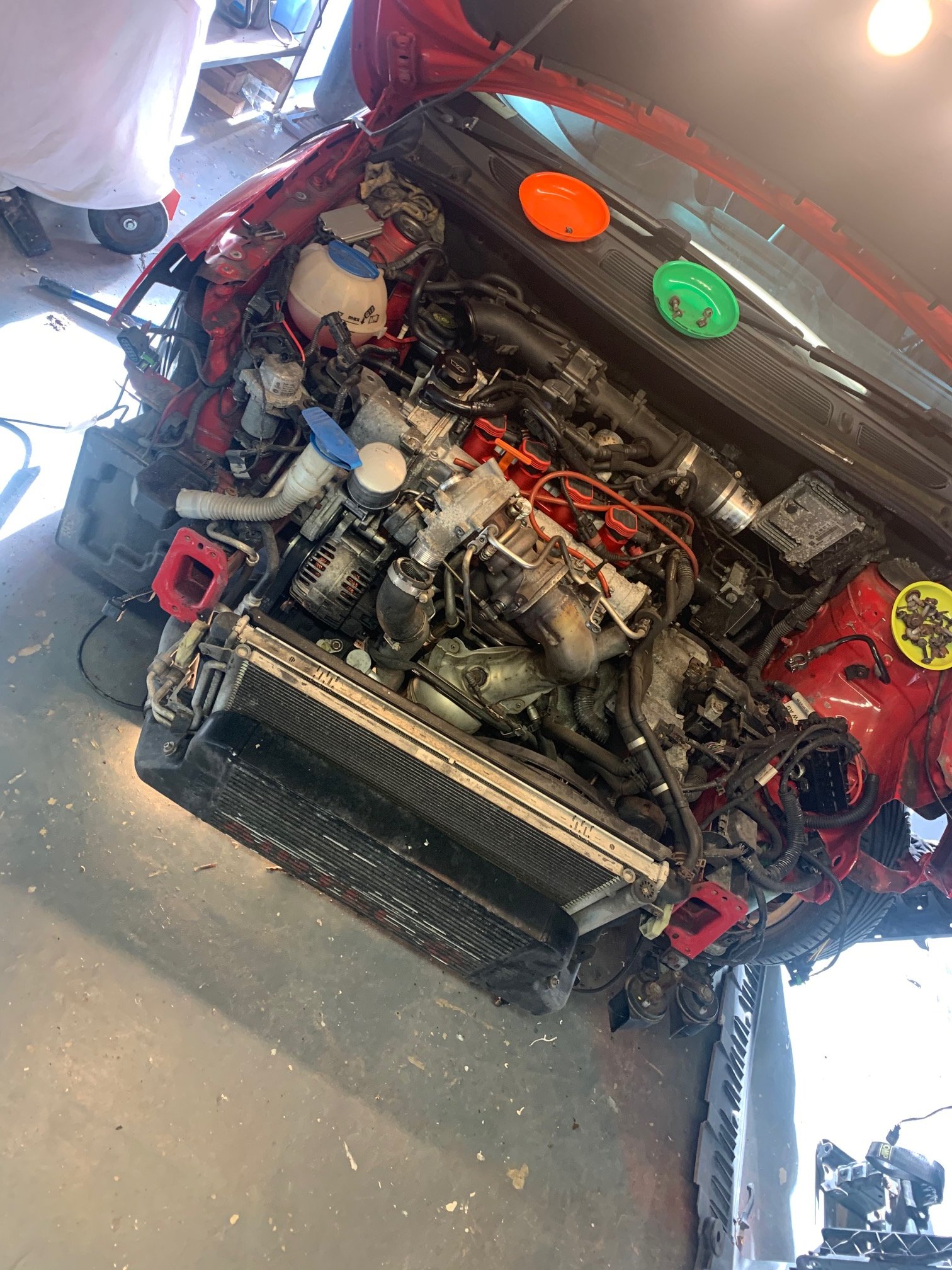

The crash bar + front bumper need to be removed to gain access to manifold if anyone tells you they can do a turbo change without doing this i really want to see it
39DCE221-972F-4163-B84F-33A85C6A5867.thumb.JPG.9da72b6733a89c3a682650723ff4a09a.JPGb5e7919c-a1b2-4e0e-a92c-0fcd2d2c7ff0.thumb.JPG.dfda6ba949d58fe791c5c023b7a8ff87.JPG
OEM turbo removed now let the fun commence ^
turbo and all ancillaries back together she's starting to take shape
all done ready for mapping and santa pod

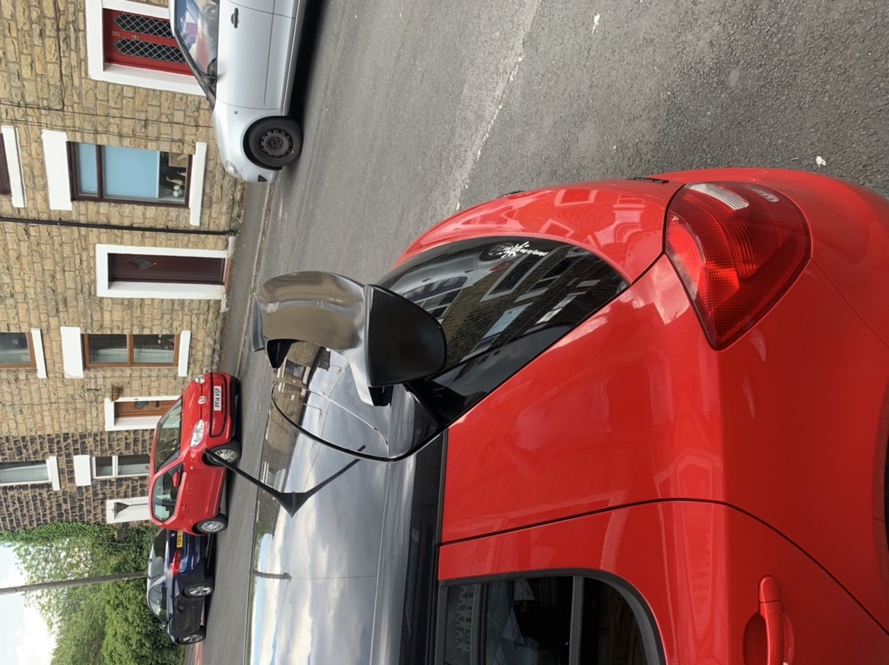

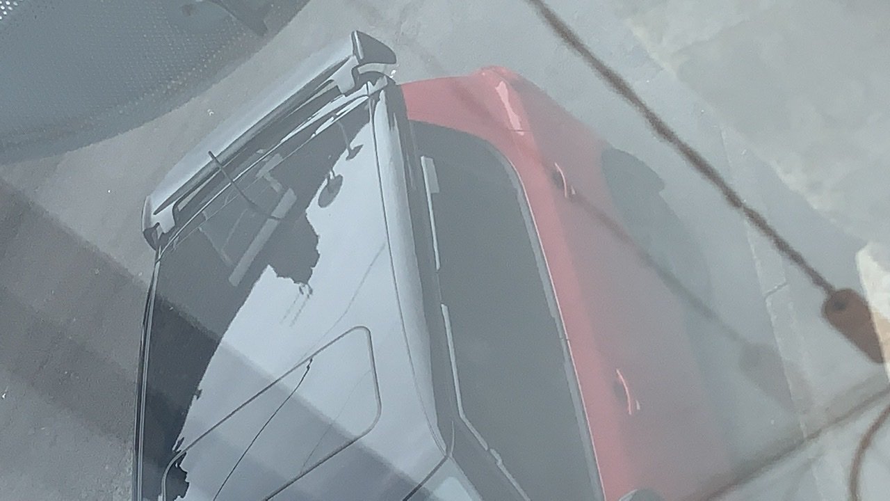

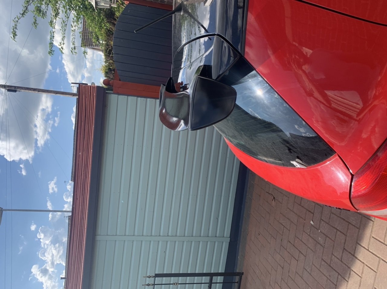

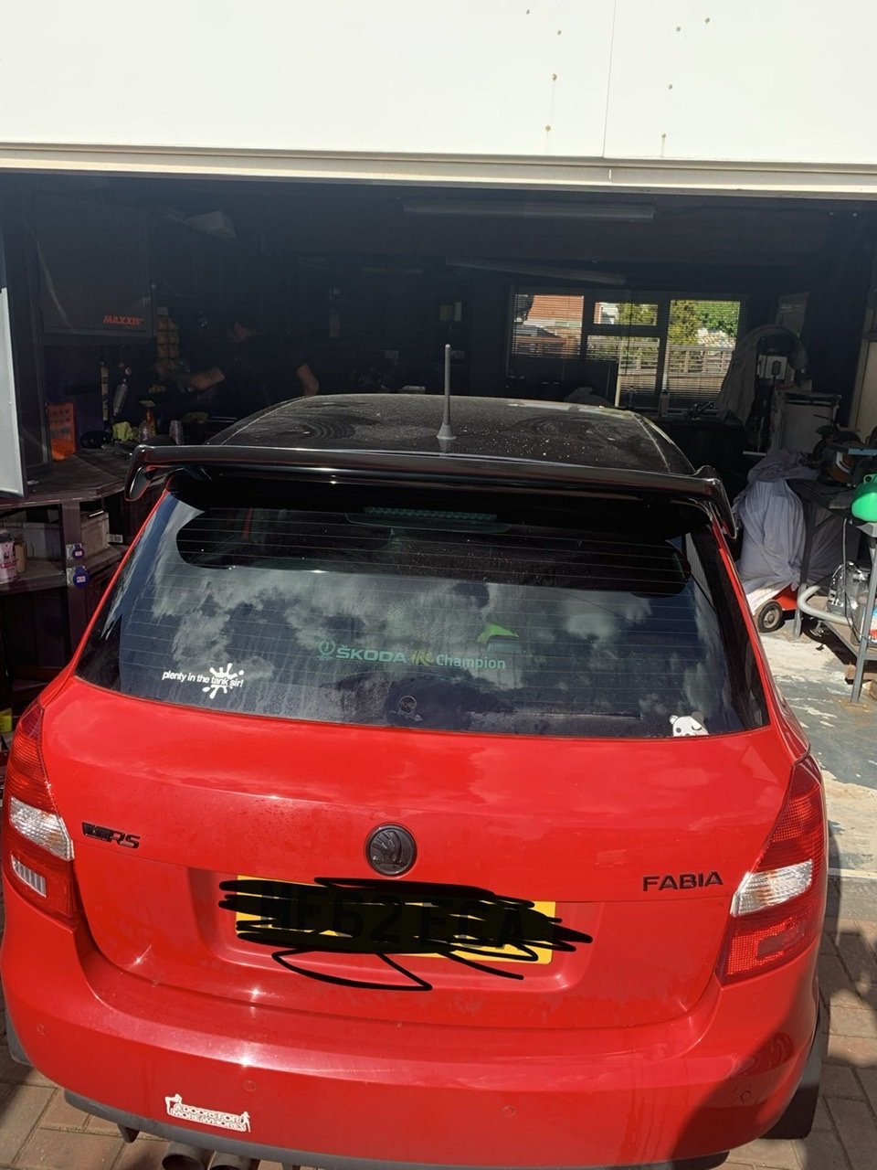

Some progress finally!

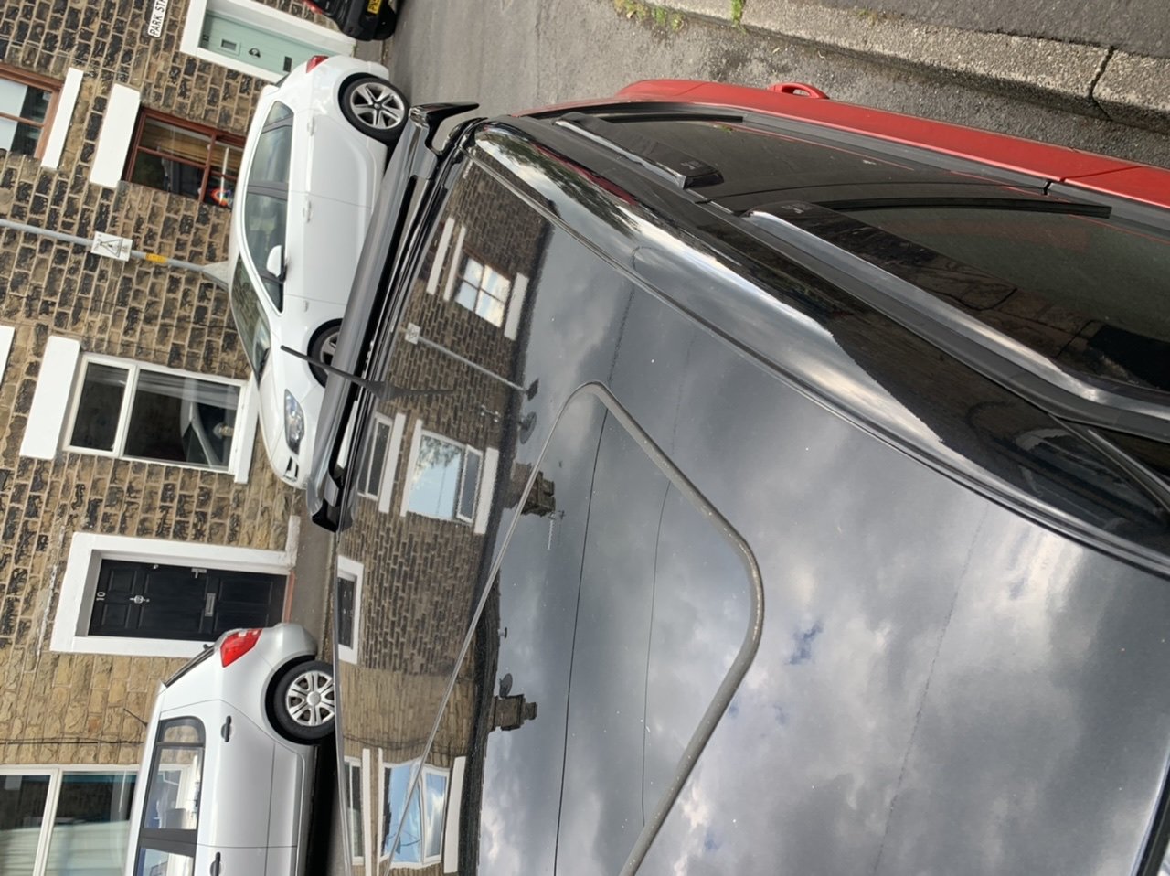

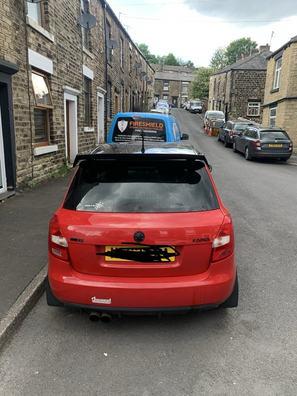

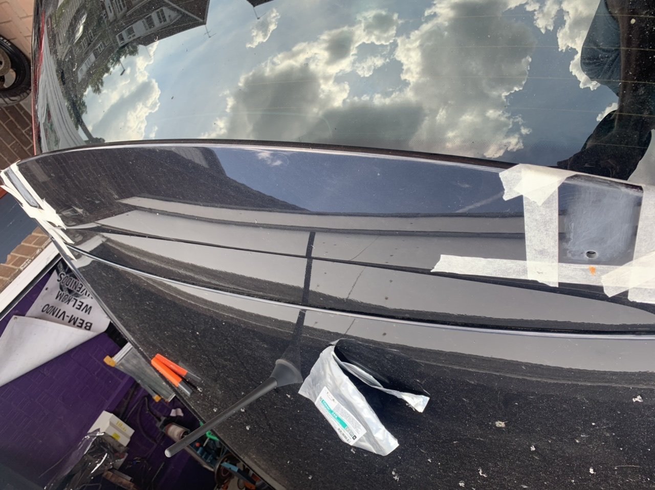

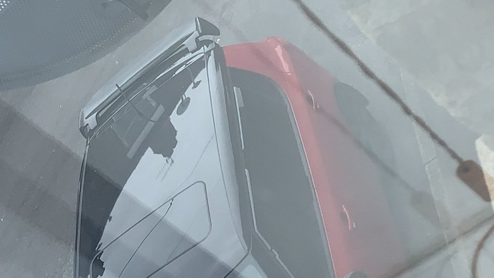

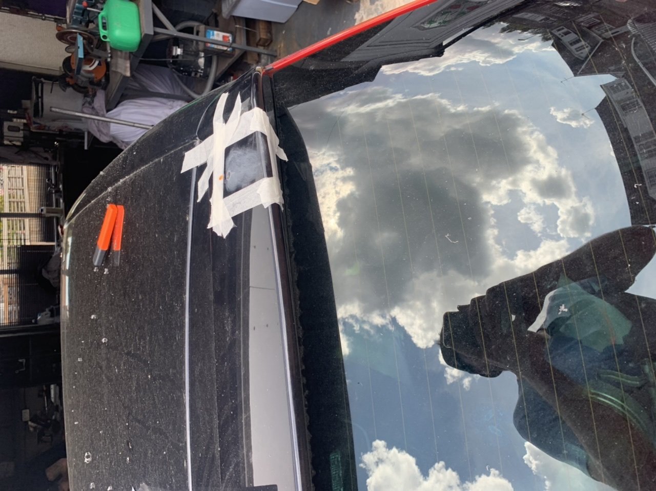

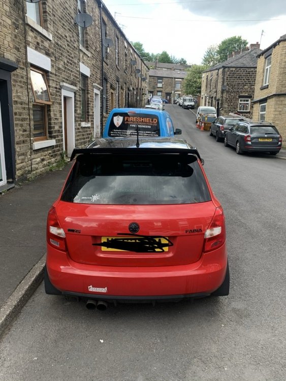

so today we started fitting the big wing spoiler and some other bits I will post later!
the spoiler is going to get a final lick of paint on the car as we have just used a can at the moment due to not being able to buy any due to this virus
first things first prepping the car 939C9306-3F23-450F-9A01-596CDB87859C.thumb.jpeg.fc8cac3ad829af4a70566ca4760e9eb0.jpeg
holes drilled a surface sanded to allow the epoxy glue to hold it in place
spoiler bonded to car
finished results until painted on car and joints filled in with car filler when everywhere opens

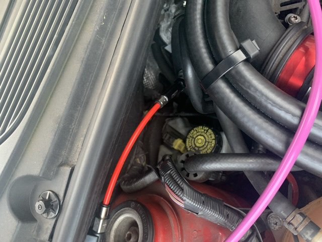

water meth nozzle fitted awaiting full kit fitment

How you finding the diesel dog mount? That's the spoiler another member has.....Knew I'd seen it before.
Where did you get that spoiler from?
No sure where the Op purchased it but you can get it off AliExpress/Wish etc
£15.92  46% Off | For Skoda Fabia 2006-2017 Spoiler Skoda Fabia  High Quality ABS Material Car Rear Wing Primer Color Rear Spoiler
https://a.aliexpress.com/_dZstyVB
That’s the one cheers mick! but I got mine off eBay and they don’t sell it on there anymore if I have any advice They have the A45 AMG ones on eBay already painted gloss black for £130  that comes unpainted so if I was you I would get the A45 one as it cost around £150 to get it painted
Could be an option to vinyl wrap it, if painting is a hassle

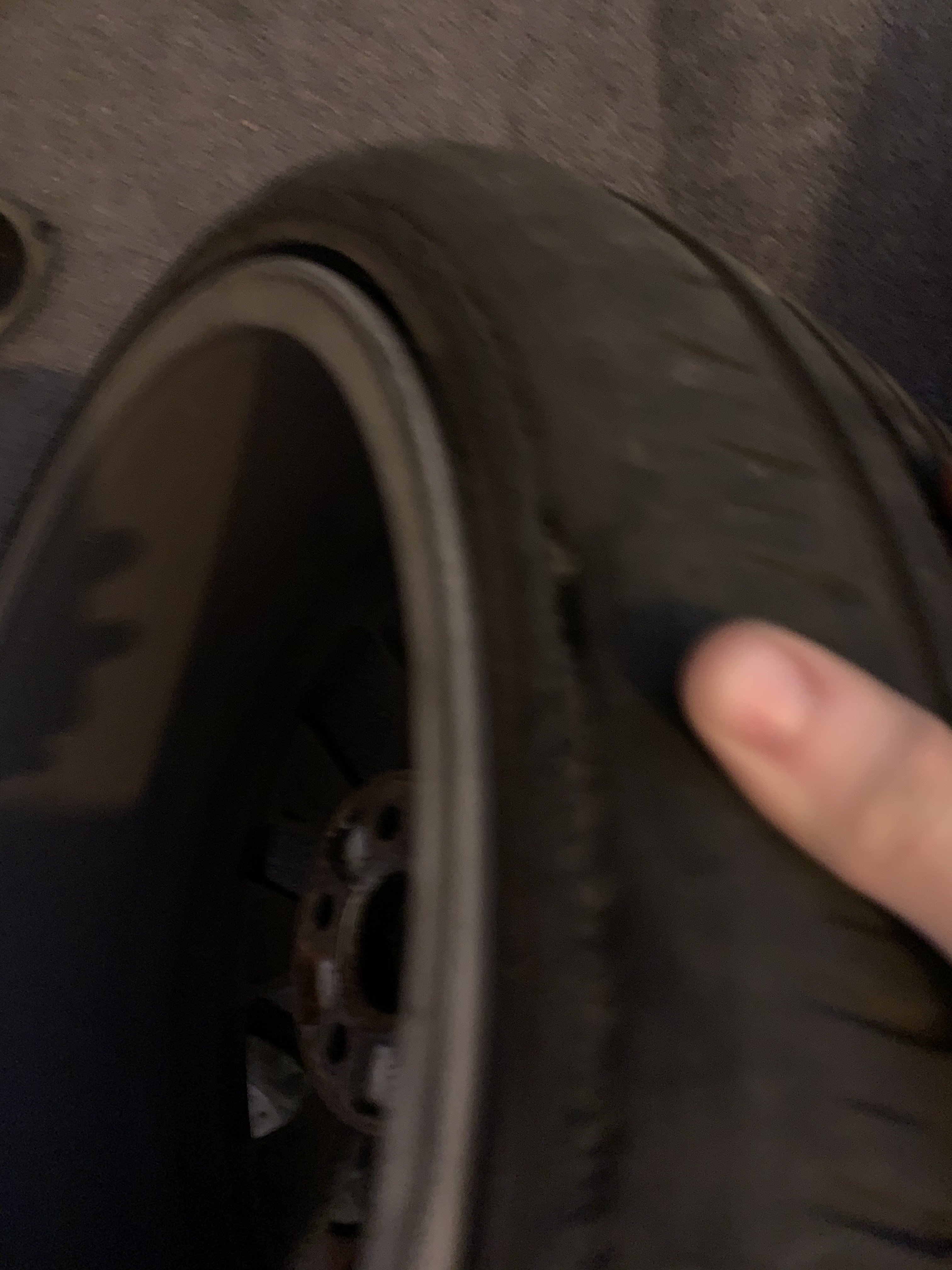

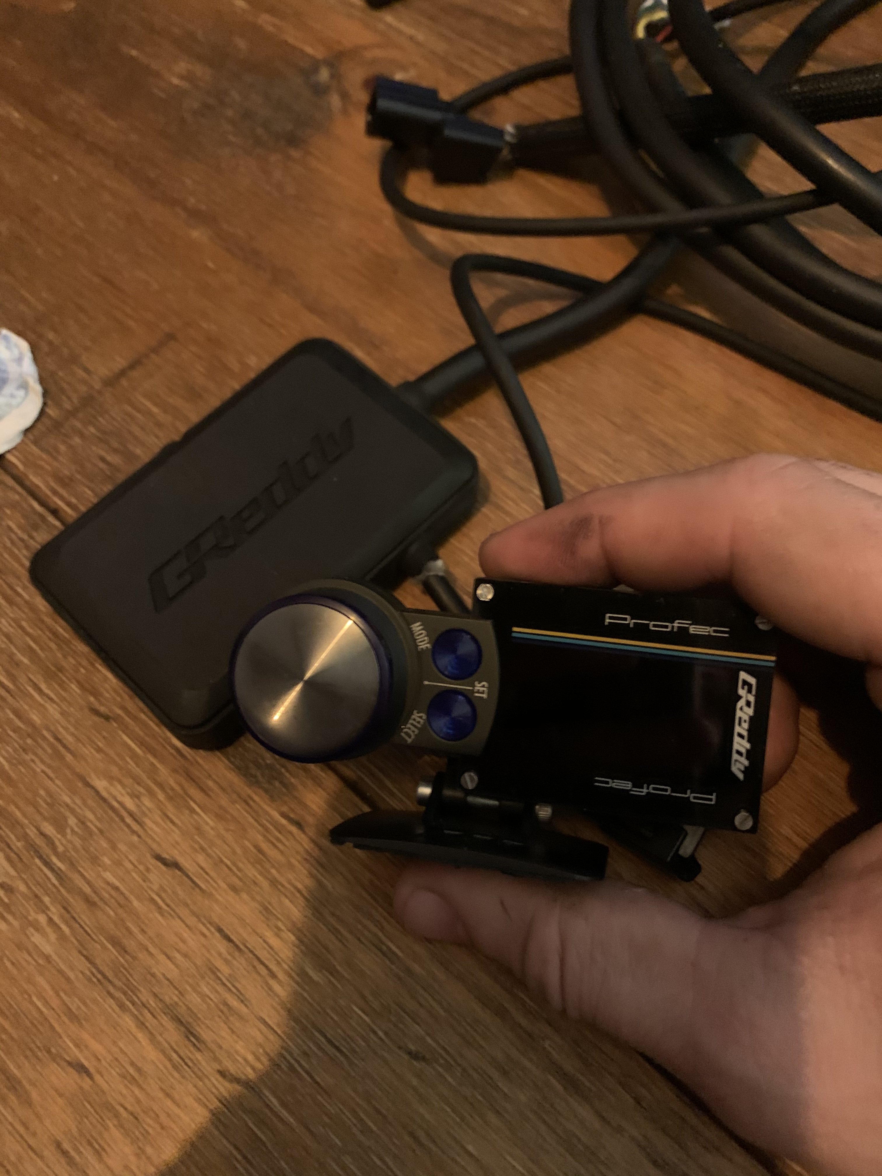

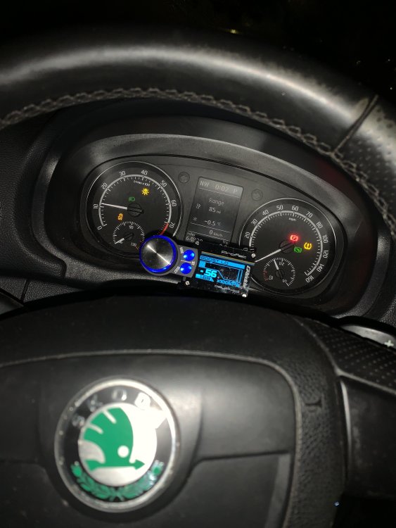

Mixed weekend this week as the postie brought me a new toy to fit the GReddy Profec OLED 73D2D830-FA77-47AC-9A02-0369A8B493BD.thumb.jpeg.b380d97bbf535220cb69c25470a7f45b.jpeg
and he also brought me a gloss black badge from the front of the car make it look more stealth C6C854C5-1293-4372-832B-15FE1DB1A7C4.thumb.jpeg.7b4fb0cd77238029ecc3bf967df33182.jpeg
but on the other hand for
some reason had a Practically brand new tyre do this £60 Down the drain 7E70BEF3-F409-44E6-AE56-4276CB7B9623.thumb.jpeg.9dbf1e13569f35d8e30d4713087d0e99.jpeg
hope everyone else’s weekends have been good 💪🏻

That Greddy Boost controller is spot on mate, I’ve seen it being used in a few cars now although my mate did have a bit of bother fitting it and had to get a garage to do so.
I don’t think you mentioned if you forged it yet? and have you had a chance to get it on the rollers?

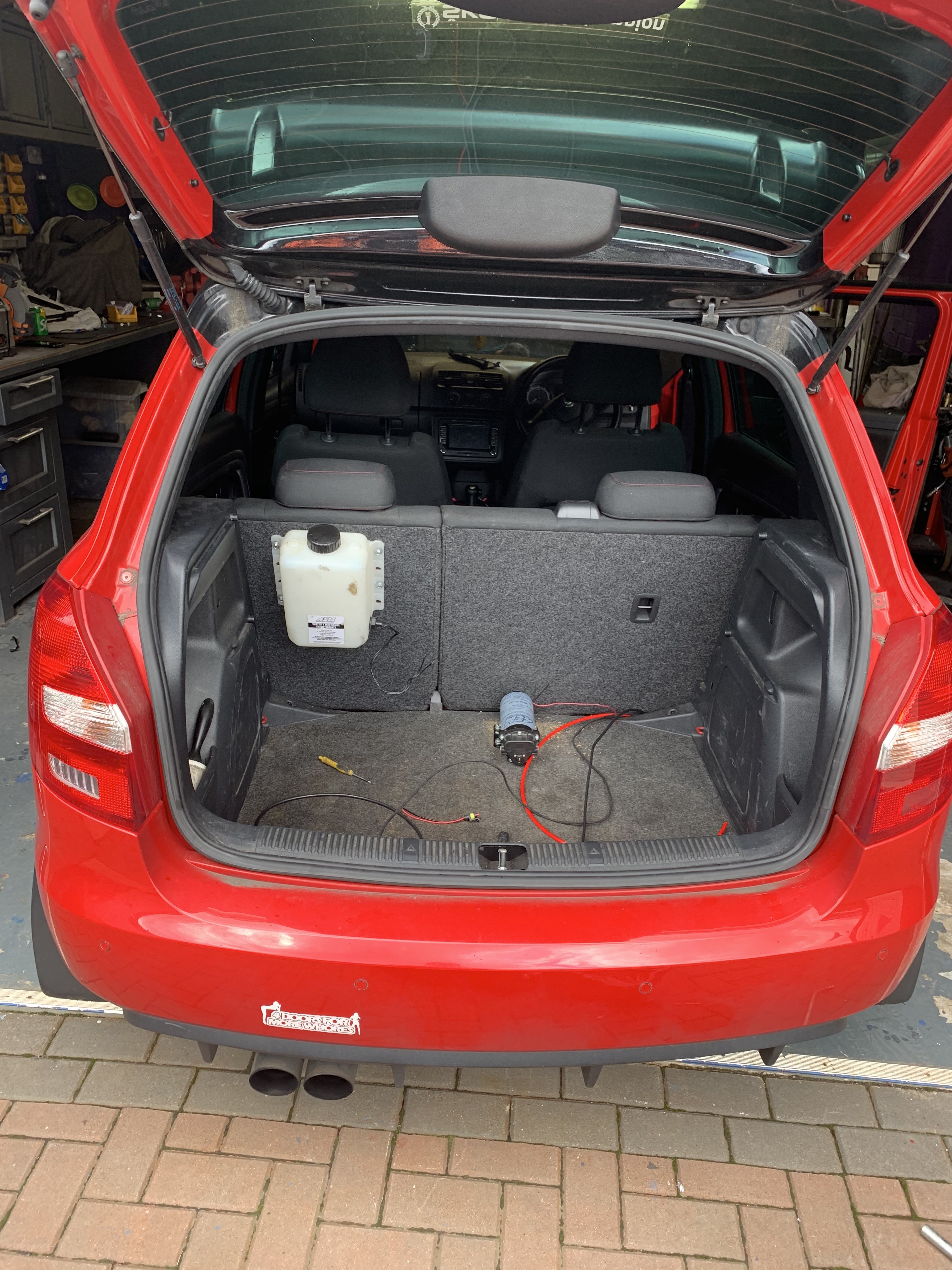

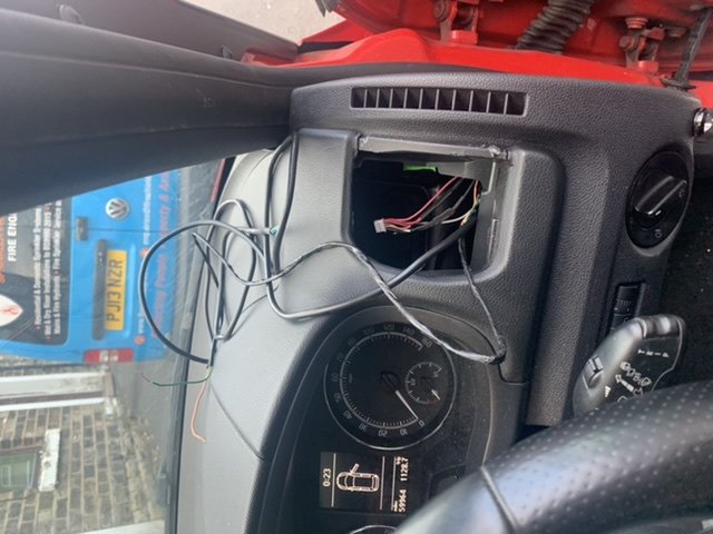

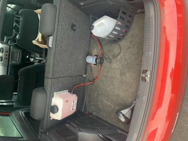

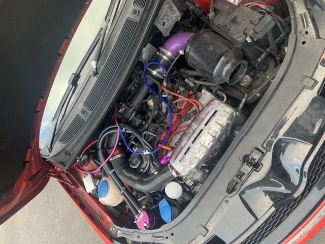

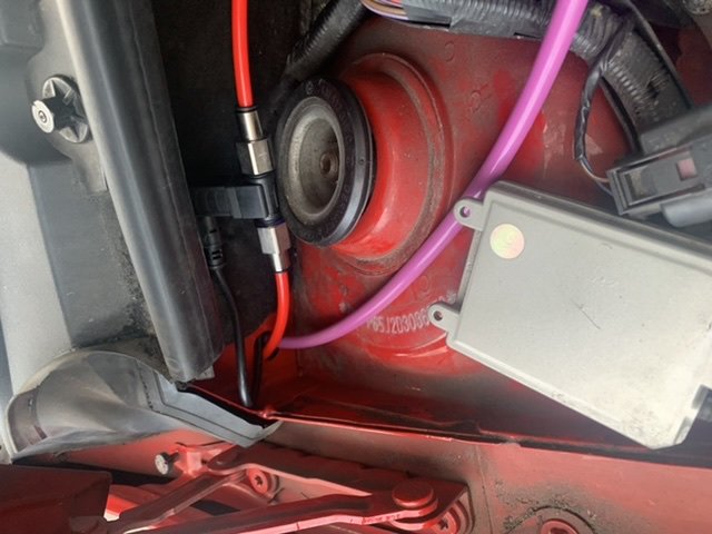

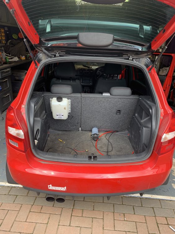

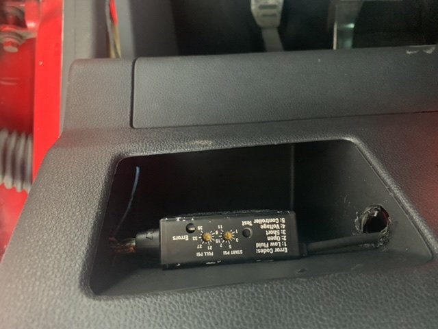

small update guys been fitting the water meth kit all day fitted the water meth kit but need to interface it with the failsafe gauge and the greddy Profec OLED and do some wire management (cleaning the wire routes up 🤣😂) I need to interface it with the boost controller so it can cut the boost pressure to wastegate pressure to protect the engine incase anything fails while under load
Happy with the placement though!
Nice one mate! I know of a few folks running meth now on our engines but all been a ball ache to set up , You gonna need to head back to RTMG to get the maps set up for meth?

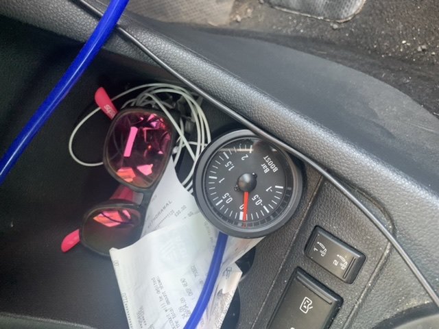

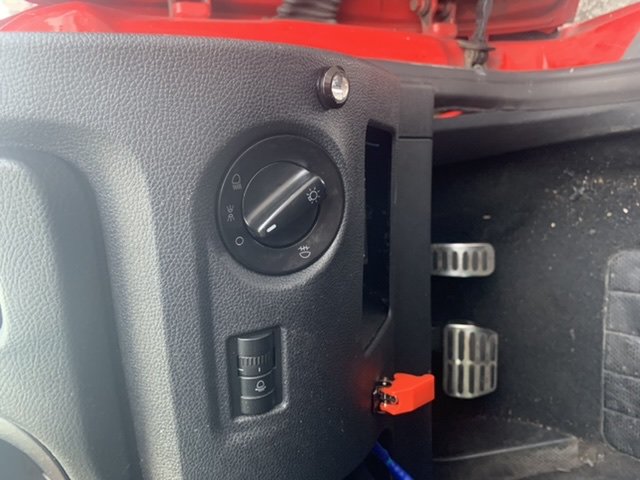

Few WIP picks from the weekend of my install hope everyone appreciates all the placement of everything, also fitted some quick release brackets on the front bumper BD8A8993-6DAA-4CA6-A98E-ED77C7AB677B.jpeg.dd3ca015d68b35e4923f8dbf42a7f48c.jpegAD3B97A5-84DC-487A-9397-FFCE094D206B.jpeg.943d8de00d9aaabd90c61a1fe297f78e.jpegDBEB4238-8210-48A3-BEFB-2DE1384E5544.jpeg.b70972a7582e18a9990128dbb6de9931.jpegC1578367-60B5-45E9-8AA7-1DE4AC5F7CCF.jpeg.e9860273f015c97f30c1f8ba2f63159f.jpeg6BBD787C-7BA6-4E1F-93CF-C567AAEC7D58.jpeg.c9178638fde3bb8d9a67170d27af15c5.jpeg20C38692-0FD6-4240-89E6-7B27B83FAFFB.jpeg.16664ec2c5e8c2a2bca478203cbfc540.jpegC61FDEE7-154C-40C3-BFCC-F2D64AF43ED9.jpeg.d77e8a038679adc174a7991b60498678.jpeg31D6CCC6-3592-485A-AC36-E870FF737D8A.jpeg.cea10102304bb24d0603ecdad14b1593.jpeg77752CB6-5DBE-4944-BB1F-8C612C647CCE.jpeg.64f5ddf24ebd07f1e79e50b12cfeea20.jpeg2AD6D6D8-72F9-473E-AE05-FE5A03EDEDA7.jpeg.7232f1aff8b1092eae091ae325349efe.jpeg422C0EBA-976B-4794-9DE9-13EDECD207D1.jpeg.0bfe0ff1582df839d9298a252338a1d8.jpeg
the boost gauge is there as a reference for when we get to the mapping part 💪🏻

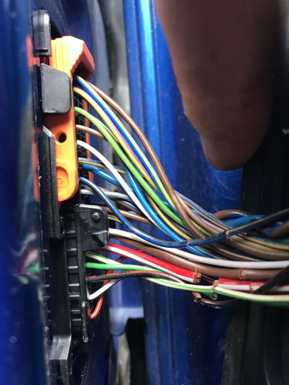

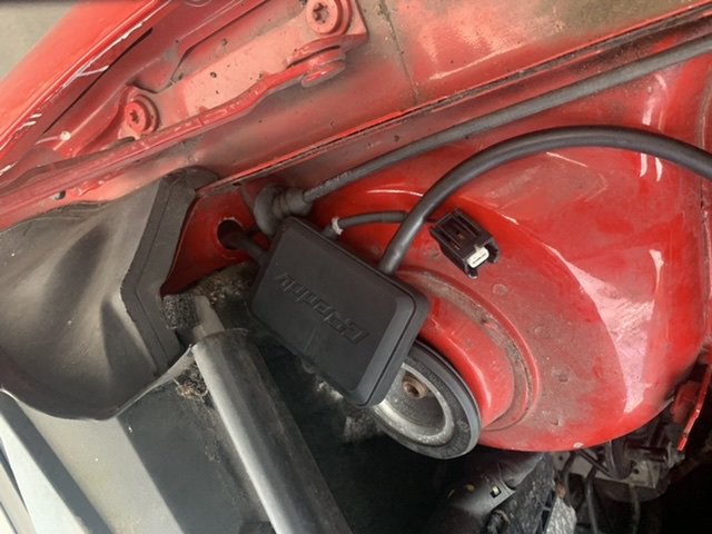

My FMIC is cracked and leaking boost and the Fabia decided to present me with another great surprise earlier......
1 minute ago, Mickmartin said:
I’m in Scotland my man, Hopefully get to one of the R-TMG Days out in the future, Christos came upto a scotland and mapped mine and a few other cars in November, Can’t speak of him highly enough.
Mate the wiring on these is a complete joke will have to get the crimper or soledering iron on that mate , what kind of issues was that giving you!? Need to get yourself an Airtec intercooler mate can’t praise mine enough
Edited by thomasaspin
Left a post on the mk2 Fabia Vrs Facebook page and a few bodys have had the same problem, If I Can find a cheap door loom I’ll fit it and wrap those wires up properly, other wise it’s getting attacked with crimps and tape.I've got the intercooler from Rtmg, Being  brutally honest it’s just a chinese intercooler Rebranded and sold on, but it’s done me for £80 I paid for it.

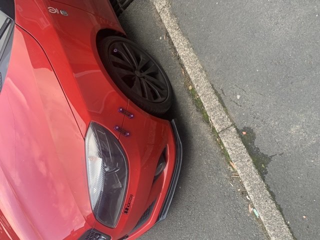

I’m liking those quick release brackets for the bumper, they solid? I see one button for the meth on/off....what’s the other orange switch for ?

Those brackets are nice and solid mate just need to make sure the rubber is under tension when marking them out on your car would look very nice on a blue car, was sick to death of spending an hour each time removing the front bumper , the orange is the arming switch and the big thing next to the headlight switch is the warning LED that flashes on when low level or pump failure etc , the air vent is where the failsafe gauge goes but need to find a air vent gauge pod for it but can’t find them anywhere you haven’t got any ideas have you bud where to get one surely they use the same vents on polo’s/golfs?
