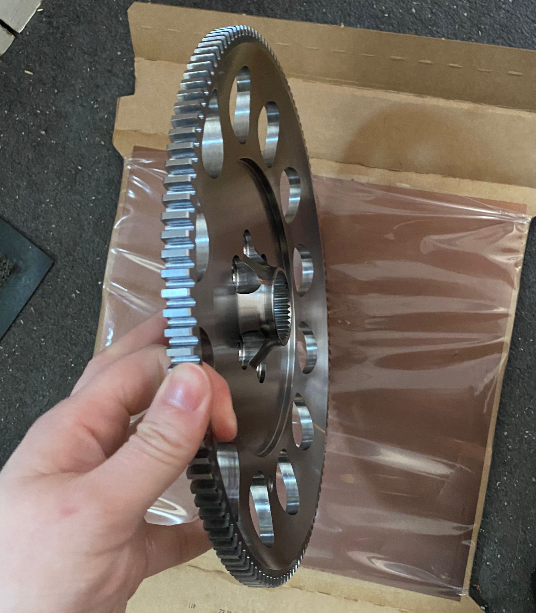

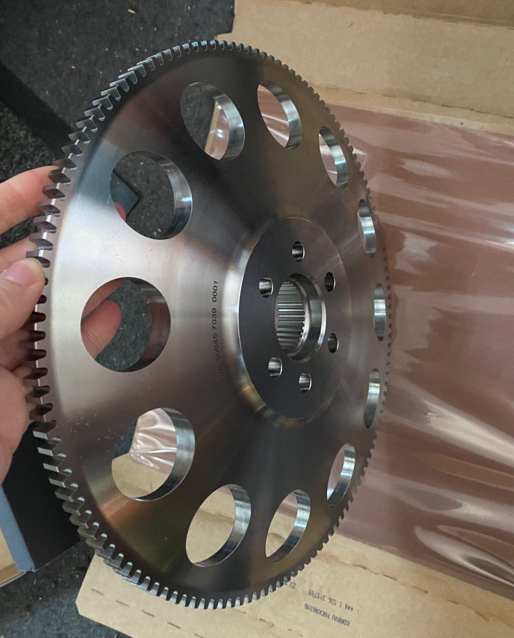

    2.5kg of metal goodness 🔥🔥🔥🔥🔥

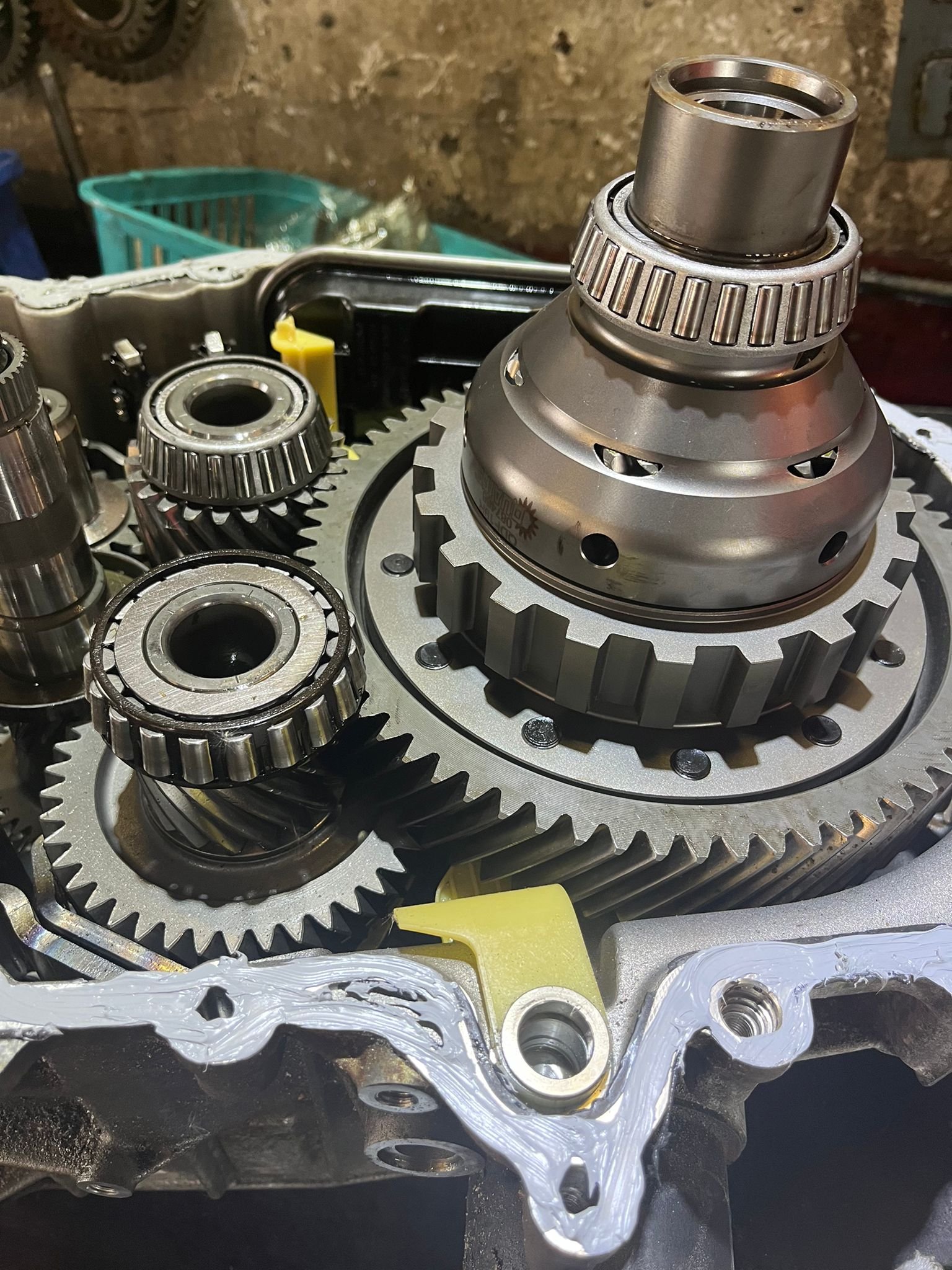

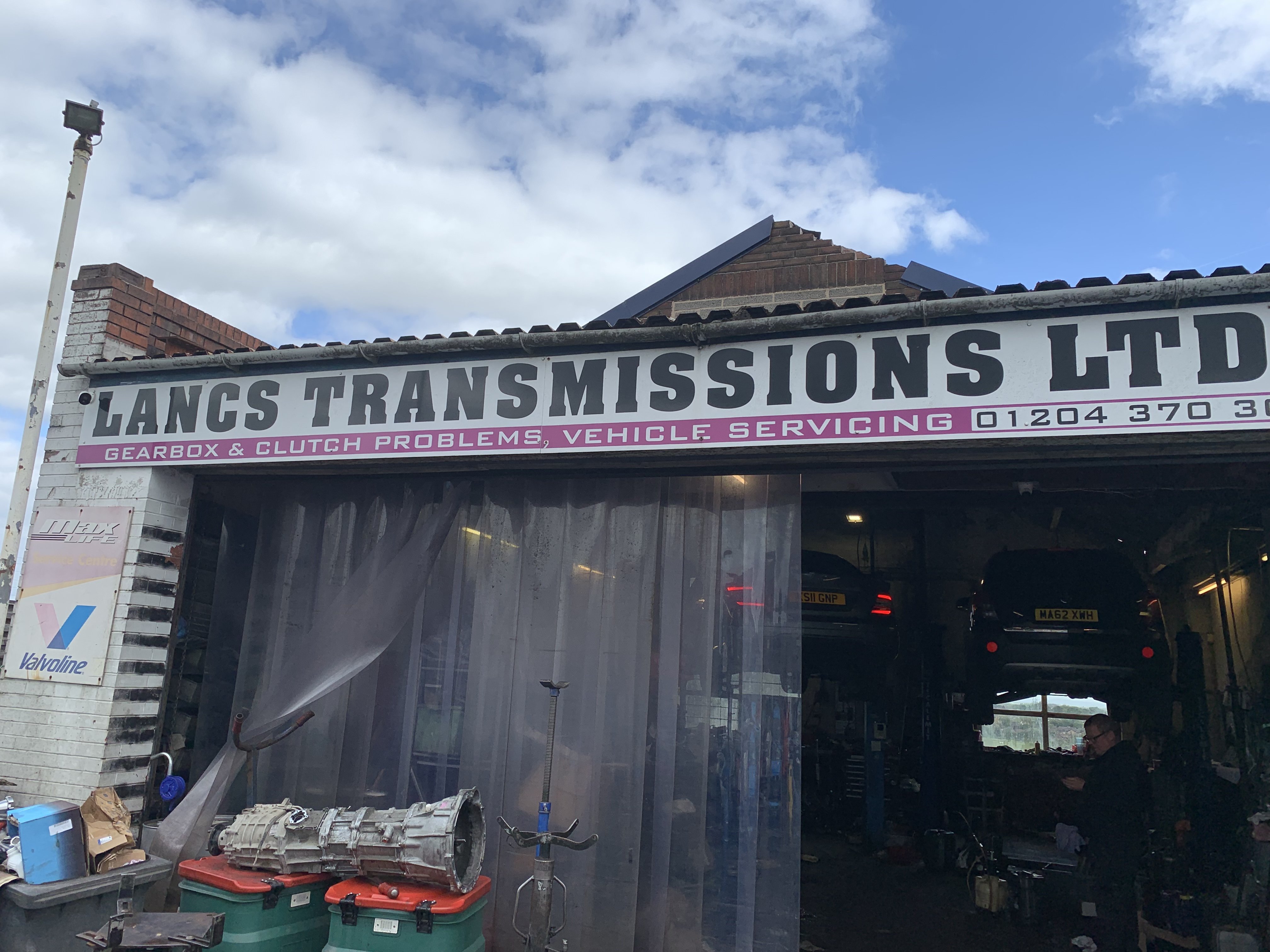

    picked up the gearbox today with the LSD fitted and rebuilt , would like to thank LANCS TRANSMISSION for the professional  friendly and well priced service , there’s some things that are beyond my cap

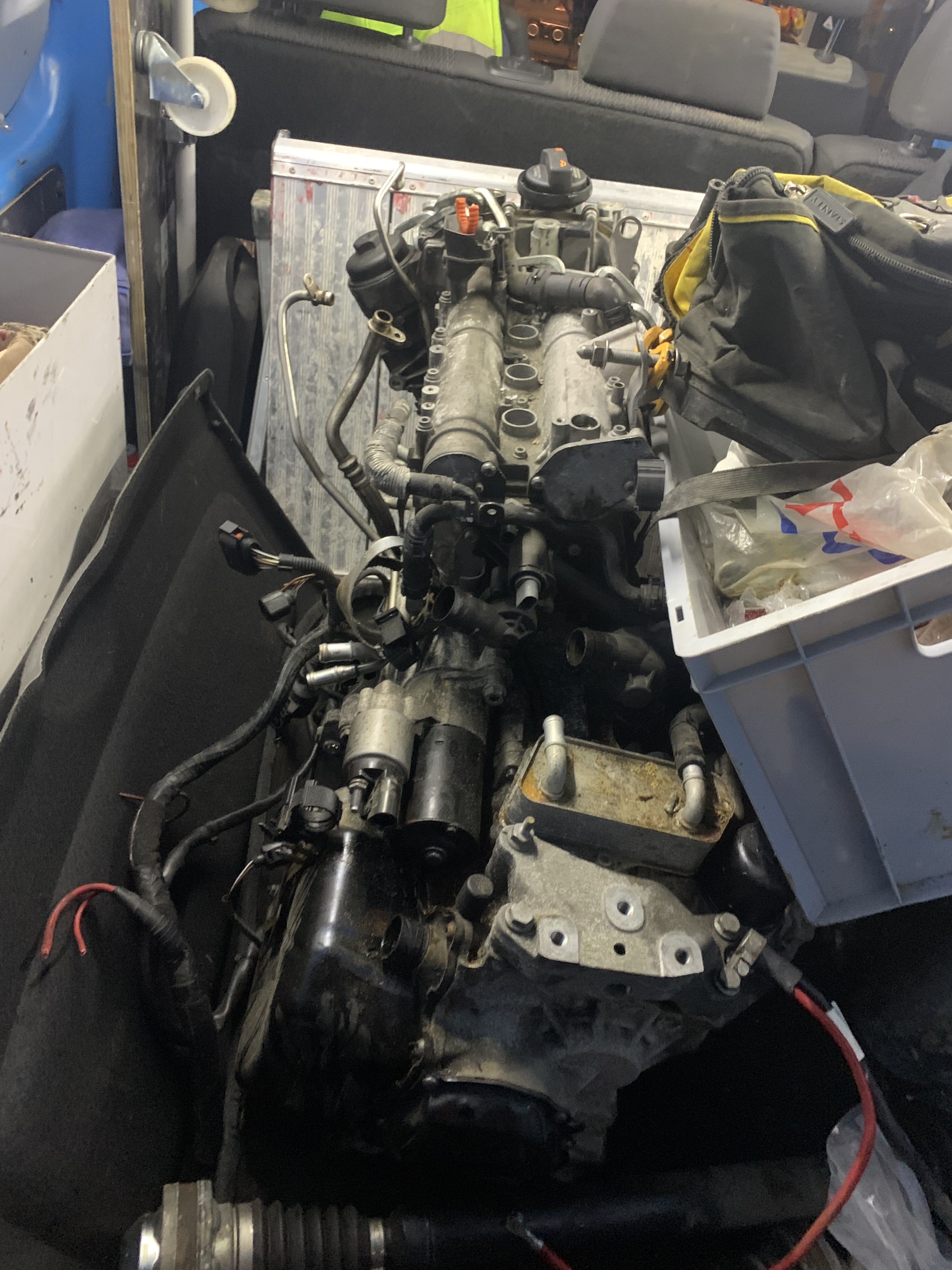

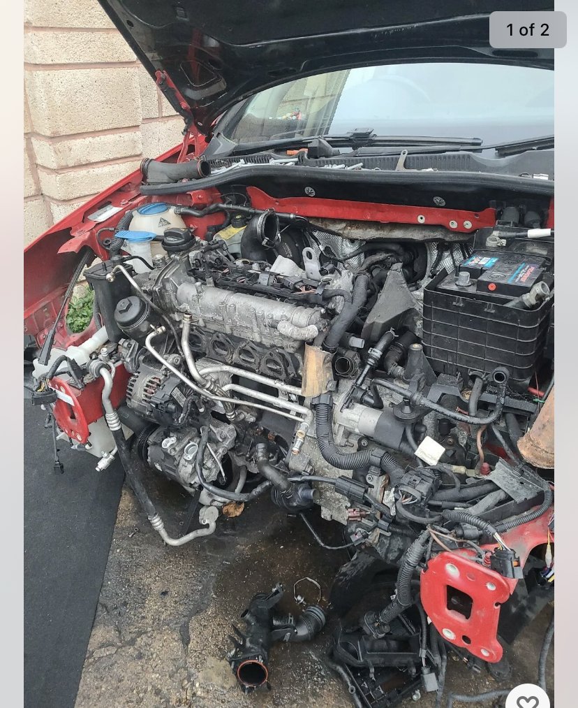

please welcome our donor (engine included)
im thinking of doing something crazy with the engine also 🔥😎003A48DB-1F34-44BF-A8EE-A5731D6467C3.thumb.jpeg.8b0c27fac9c71aec06633c795fe7517c.jpeg
many feedback welcome 🤗
Turns out a Vw caddy van can hold a lot in the back 😂🤣09A32D83-D781-43A8-9A63-B604905C41C2.thumb.jpeg.54d6f0f9fe04c5fdbceae3a53a4cd078.jpeg

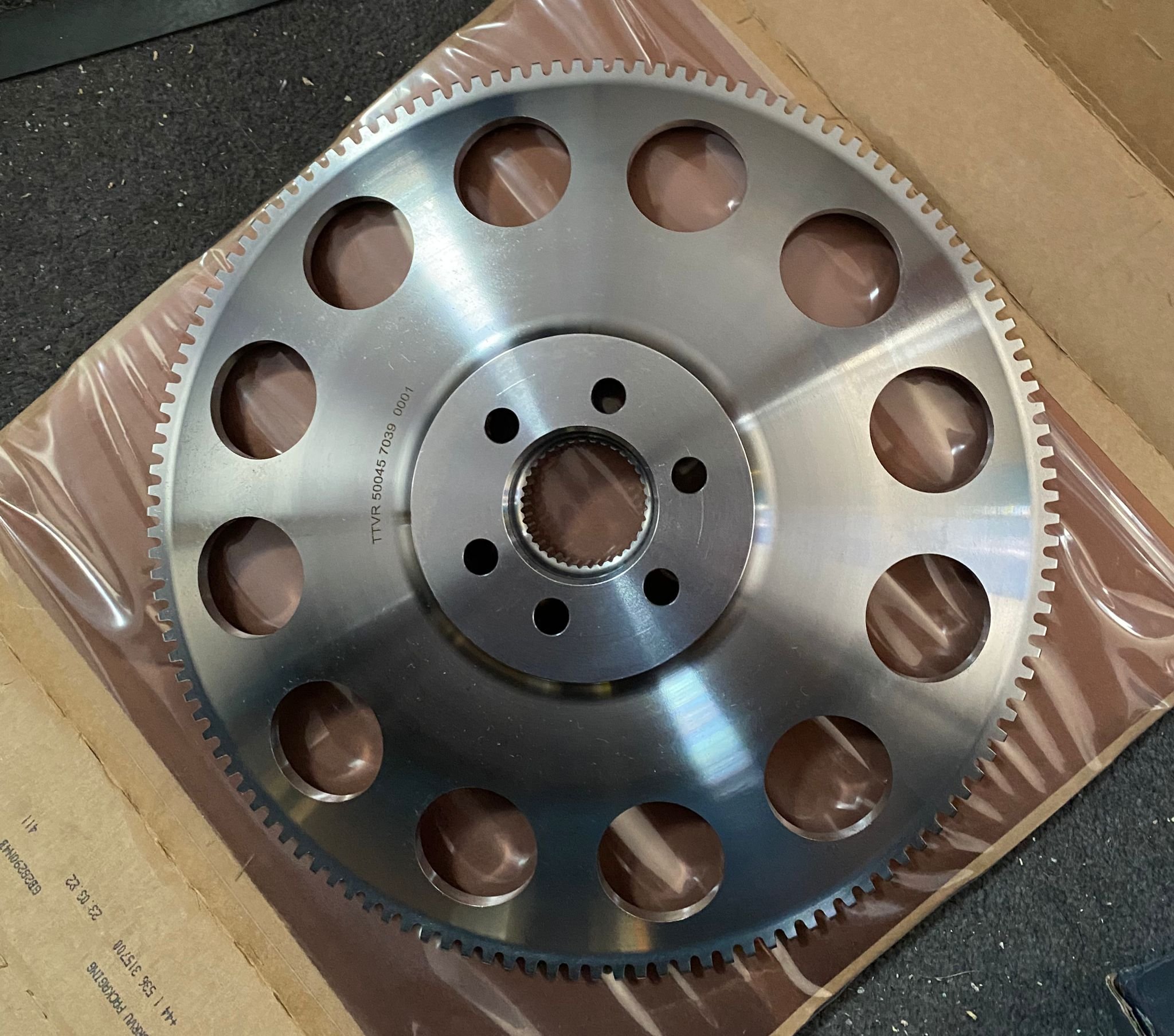

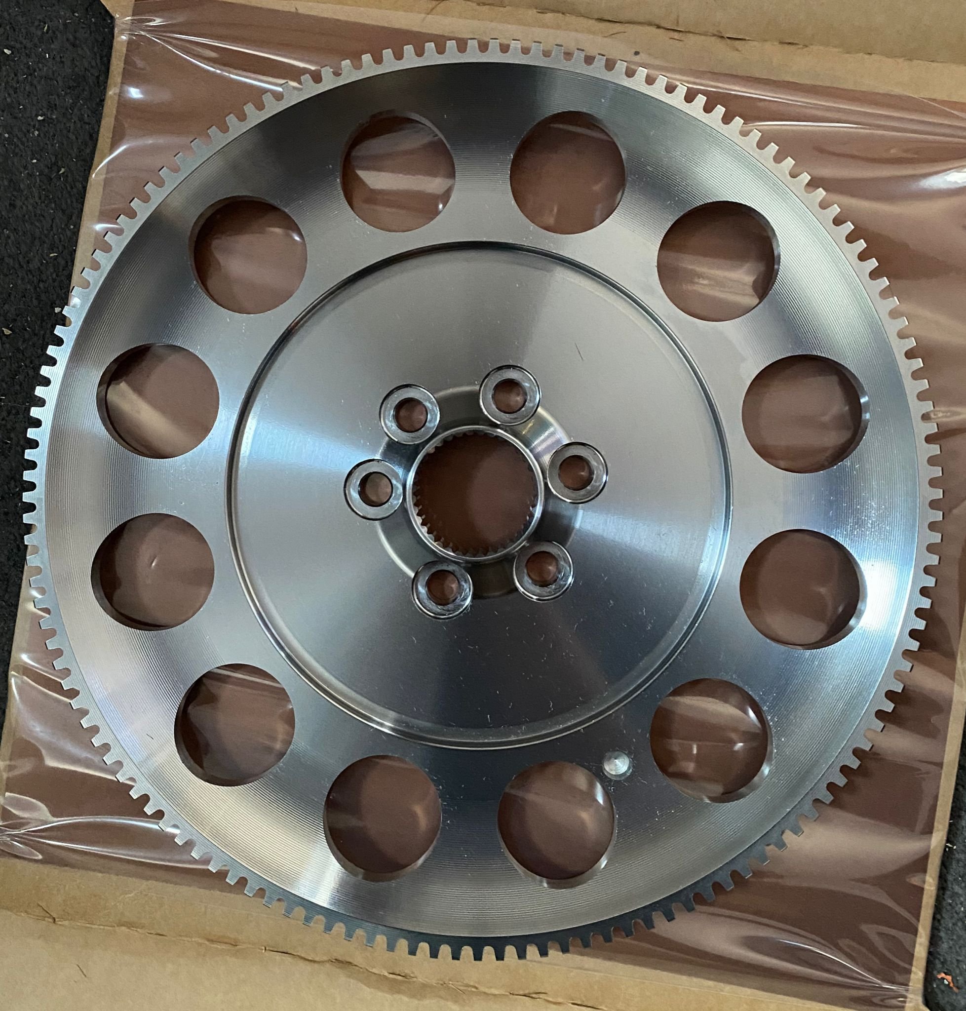

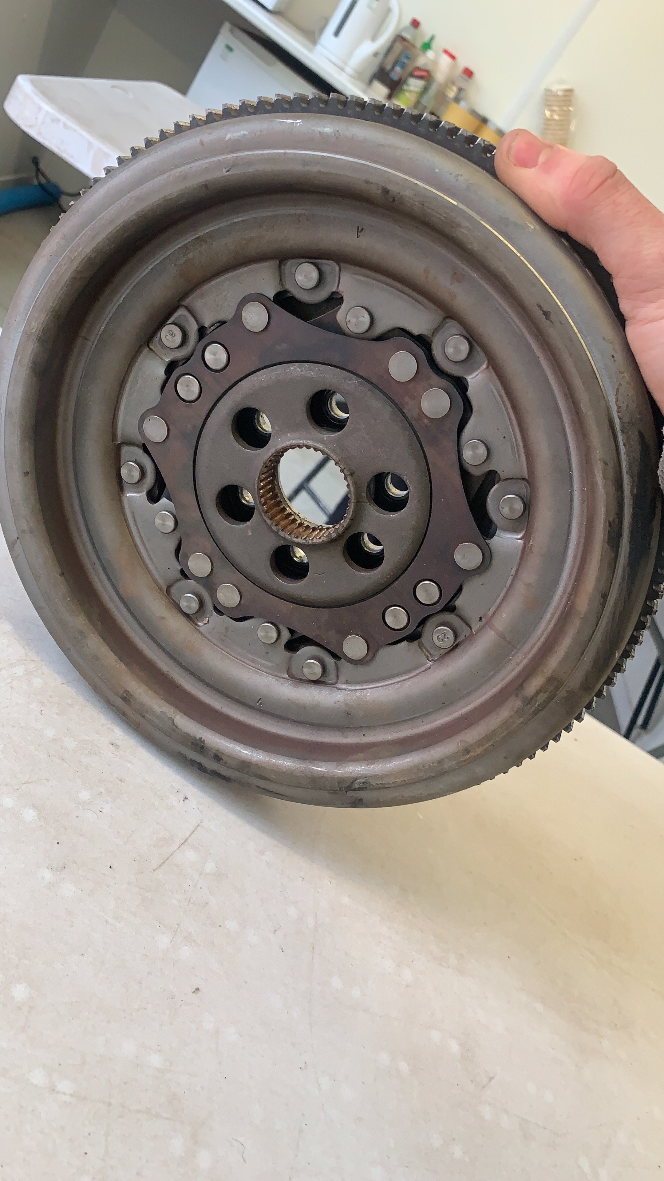

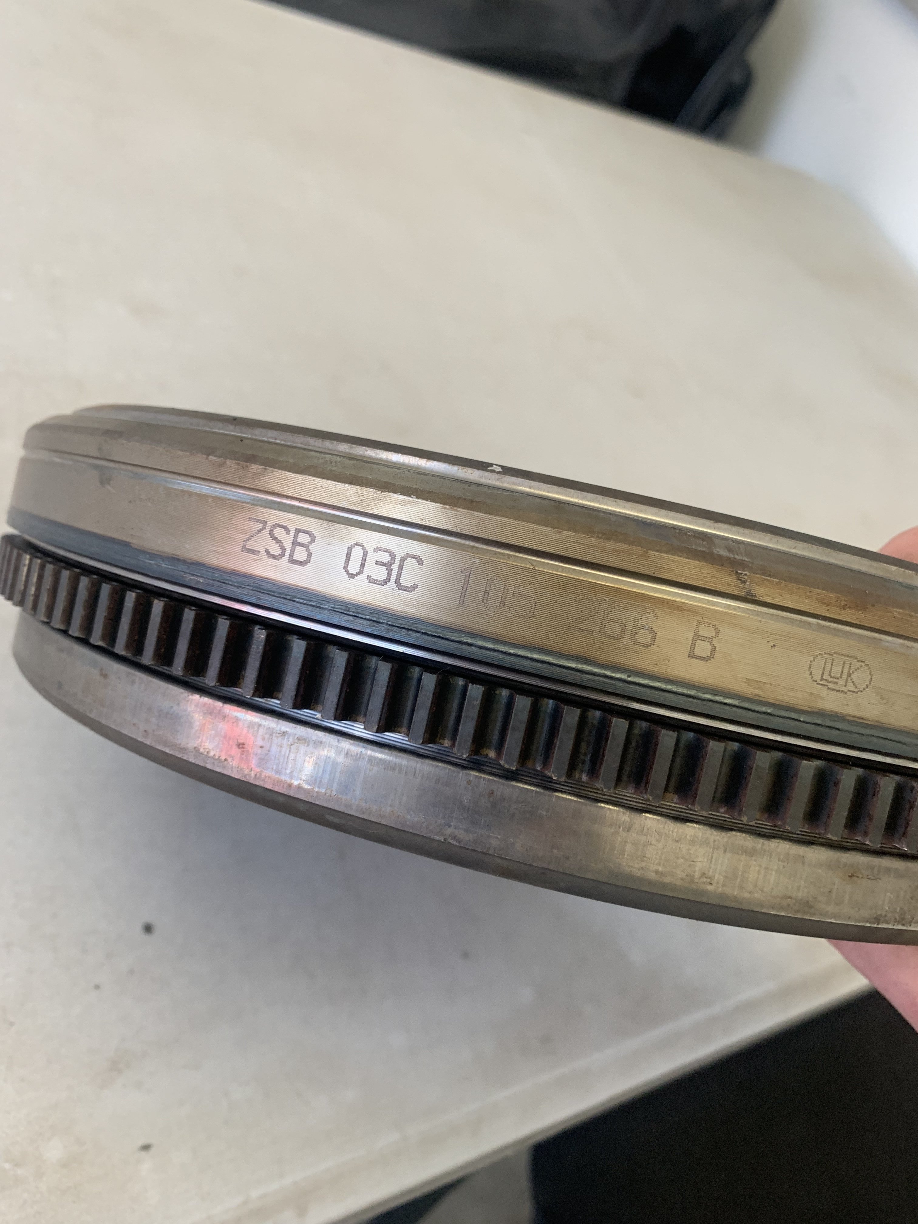

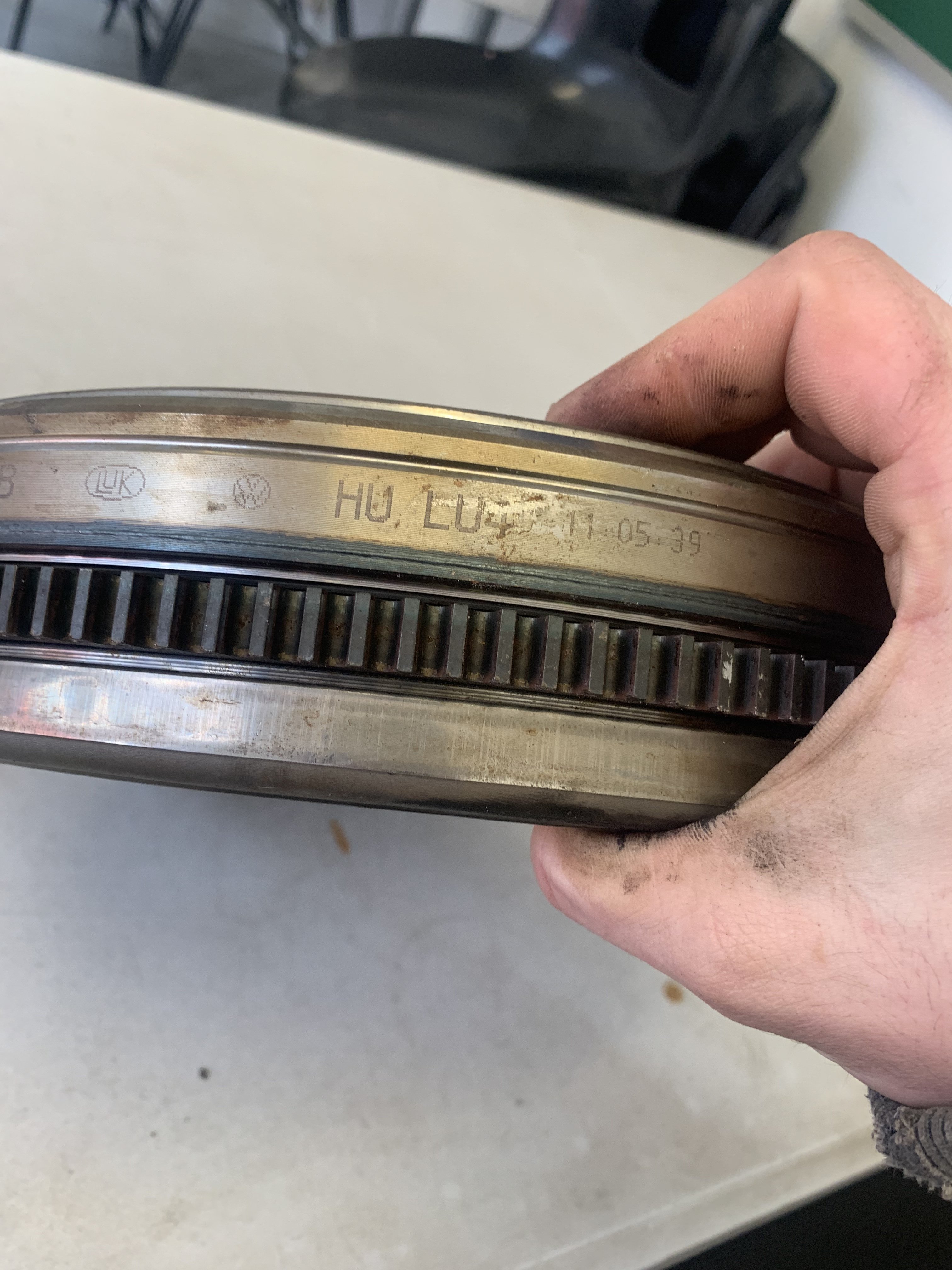

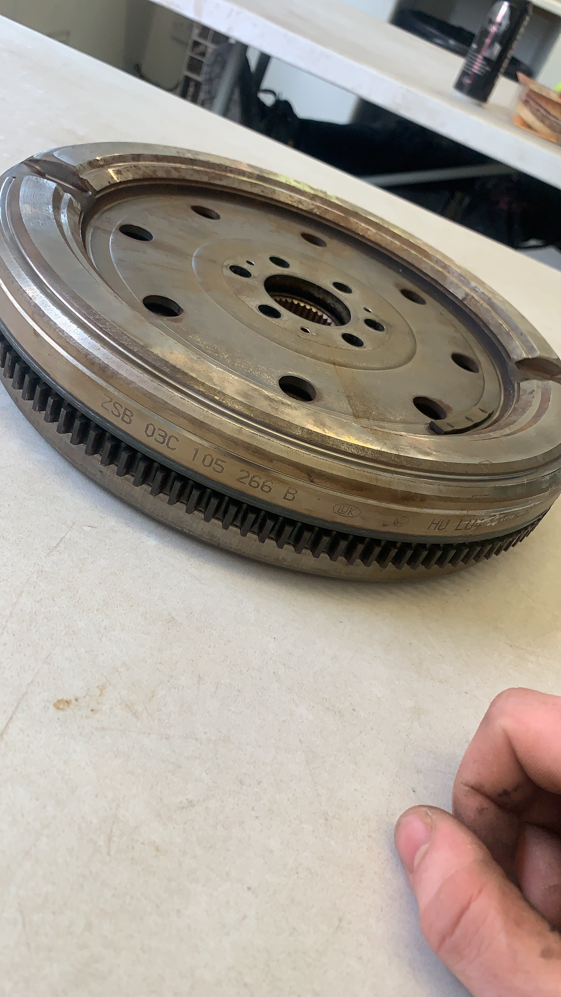

Hey guys and girls been very quiet lately due to work commitments but the project is still coming along , say hello to an OEM dual mass flywheel from a dq250 1.4 tsi golf , it weighs in at a whopping 10.6 kg so I have had it sent off to make a ultra lightweight flywheel here in the Uk 🇬🇧4421780B-0E11-4280-B5A4-7764BABFB123.thumb.jpeg.b7c1477a1287f0fcc20ae868dfae545e.jpeg61B74340-DB92-4334-817F-95F221B728F5.thumb.jpeg.7b3879724e74f5a19ca05d4488d33f26.jpeg96663472-06EF-4985-9350-94CE195ACF58.thumb.jpeg.624a67a2ac1ba3fcfb9f74edc5709fdc.jpeg0D4D9FE2-4773-4C91-BF30-509589BE8807.thumb.jpeg.ee0d6d86a4e273282a56d8914e3c6c73.jpeg
hoping to get it a single mass flywheel instead of a dual mass with a weight of 3.3-4kg will be an absolute rocket with a weight saving like that as the dq250 is slightly heavier than a dq200

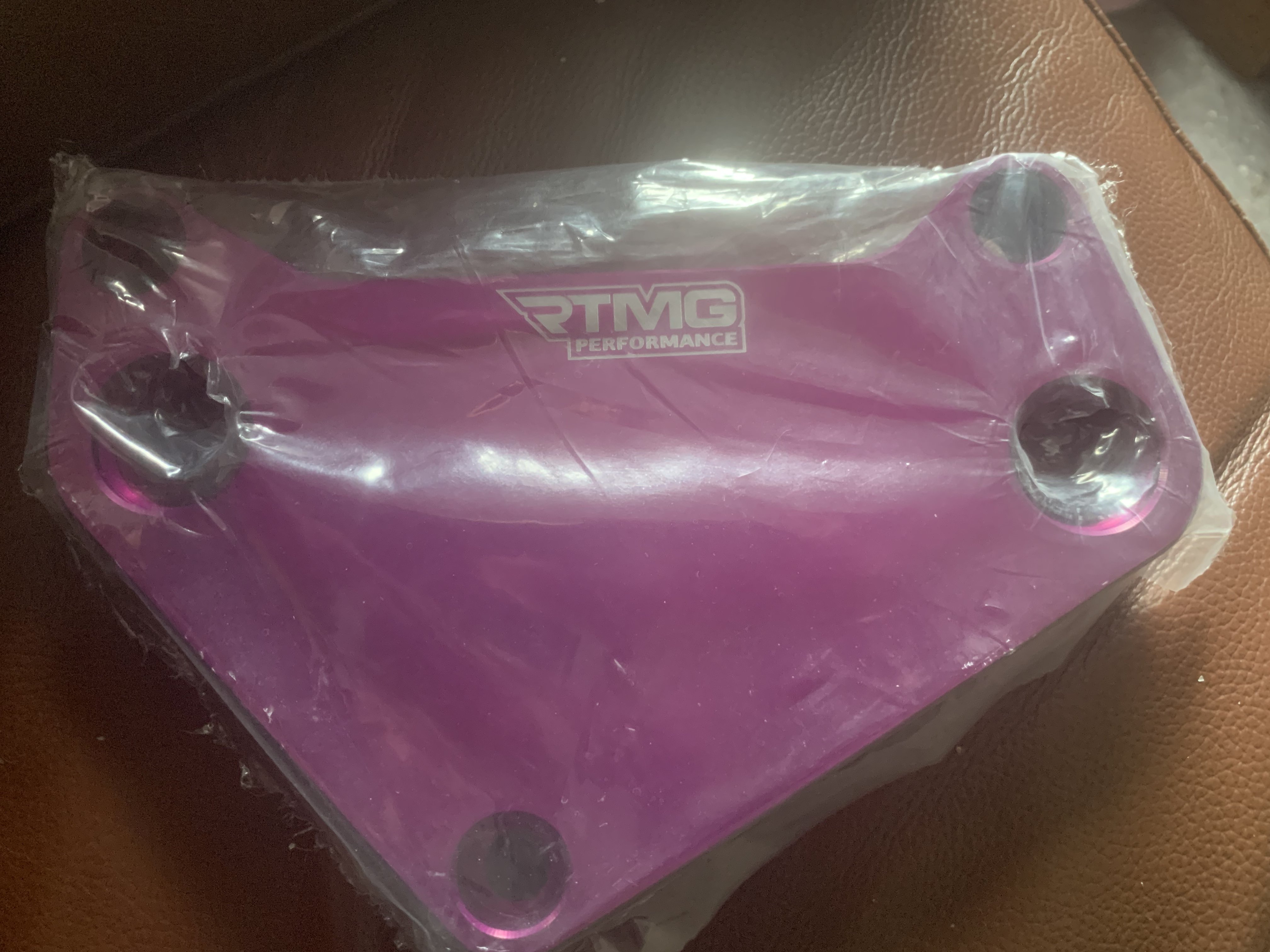

 few bits ordered today for the dq250 as the dq200 does not have any cooler lines or interface in terms of cooling but the dq250 does it has a heat exchanger on top that connects to the coolant lines , but rather than butchering the fabia lines and having to drain all coolant I have decided to get an adapter plate and fit an external oil cooler for the gearbox oil this should help with continuous use and hopefully launch controls so it doesn’t burn the clutch plates out, have also got a better looking Dsg oil filter housing so when I drop and replace all the oil and filter I will also be fitting that 4F3177C6-61D0-44A3-A308-68020D853975.thumb.jpeg.3ab524706273db5e2db76ab25339cae5.jpeg60489674-F1BA-406C-84D4-58DFA8AA294B.thumb.jpeg.9e469f682a1a5685dd7b71ff5bbfbf95.jpeg

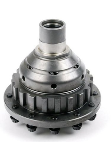

Cheers mate will do ,  just waiting on the limited slip differential arriving from quaife , for anyone else wanting to do this conversion it’s the 20 tooth LSD you need for the gearbox out of the golf mk5 GT D689F375-2BB1-4FD8-94D8-17967C9DE86C.jpeg.35e90a55dfc4fa800d3cec68cc7dea5f.jpeg

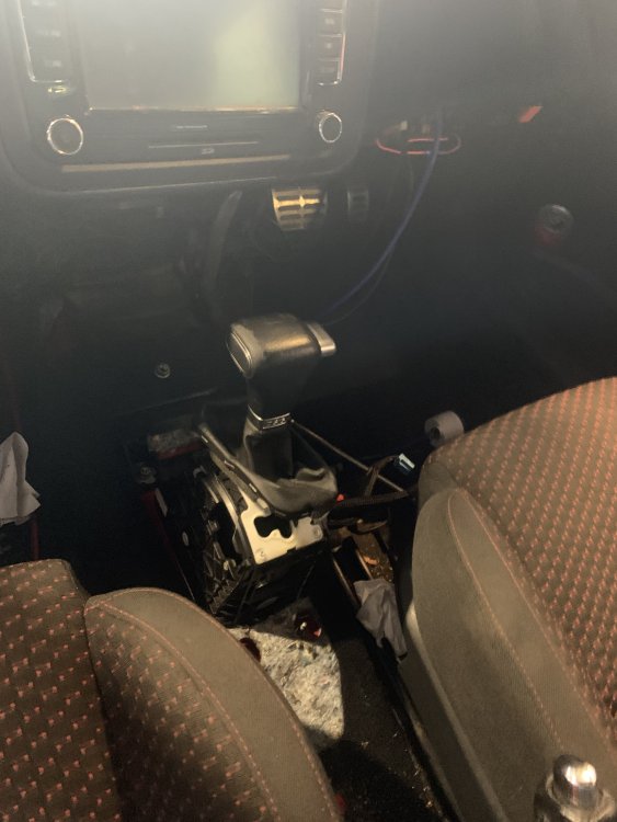

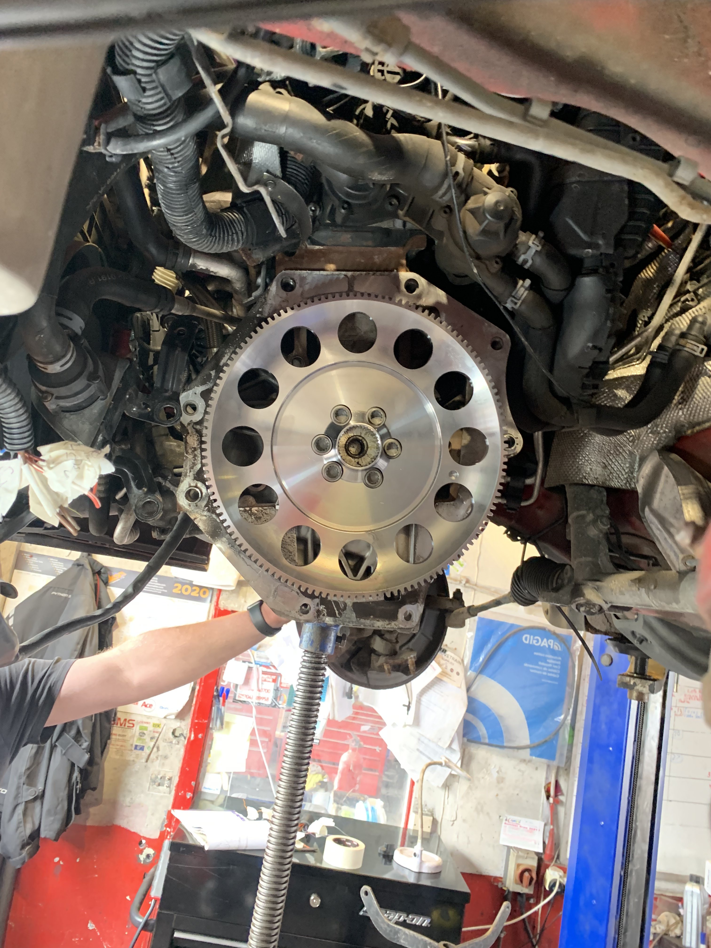

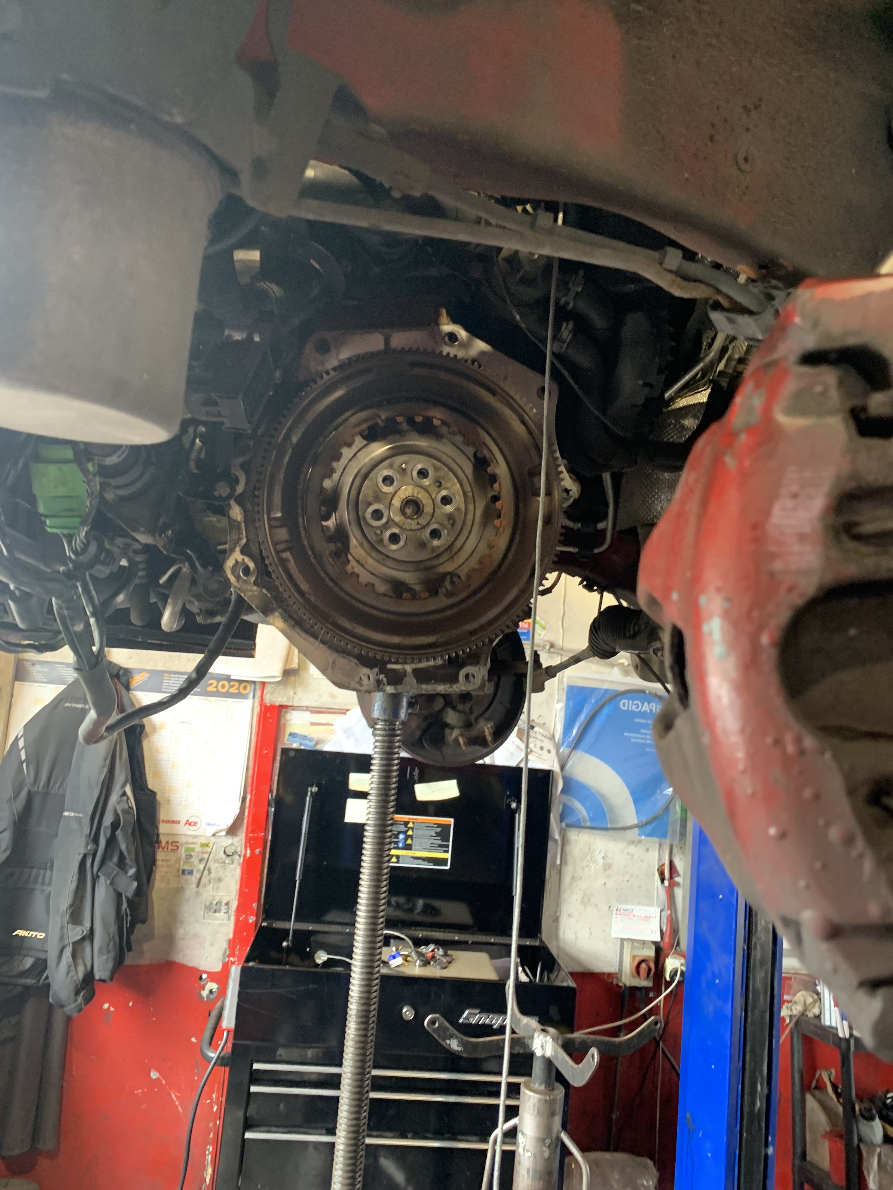

E36A9FEA-7833-4C4A-85C2-58816C60F5EC.thumb.jpeg.f0f65dfcf460397d47e0d456f214926b.jpeg34D06EB8-D50A-49F5-9BC7-2113AE4E2BE4.thumb.jpeg.7be13120d09551057664c58d029f6514.jpeg3DF81CD4-A68A-418F-81AD-3424EC3755E1.thumb.jpeg.b7dabbeda2d042e67077daa8c77b09fb.jpeg
bit of a photo dump but today was the day we fitted the dq250 just need to fettle the mount to fit and will be good to go
E05FD53B-15F0-4DD8-867A-CEDD43065168.thumb.jpeg.a9887aea3bb9efa7dda8b8e8bc13c756.jpeg3A10249D-93F3-4332-862C-4F50843D2689.thumb.jpeg.42dbc1e6fe5fe4314425b0ff23fe9839.jpeg
quite possibly the hardest mechanical task I have ever undertaken but all that is left is putting it back together

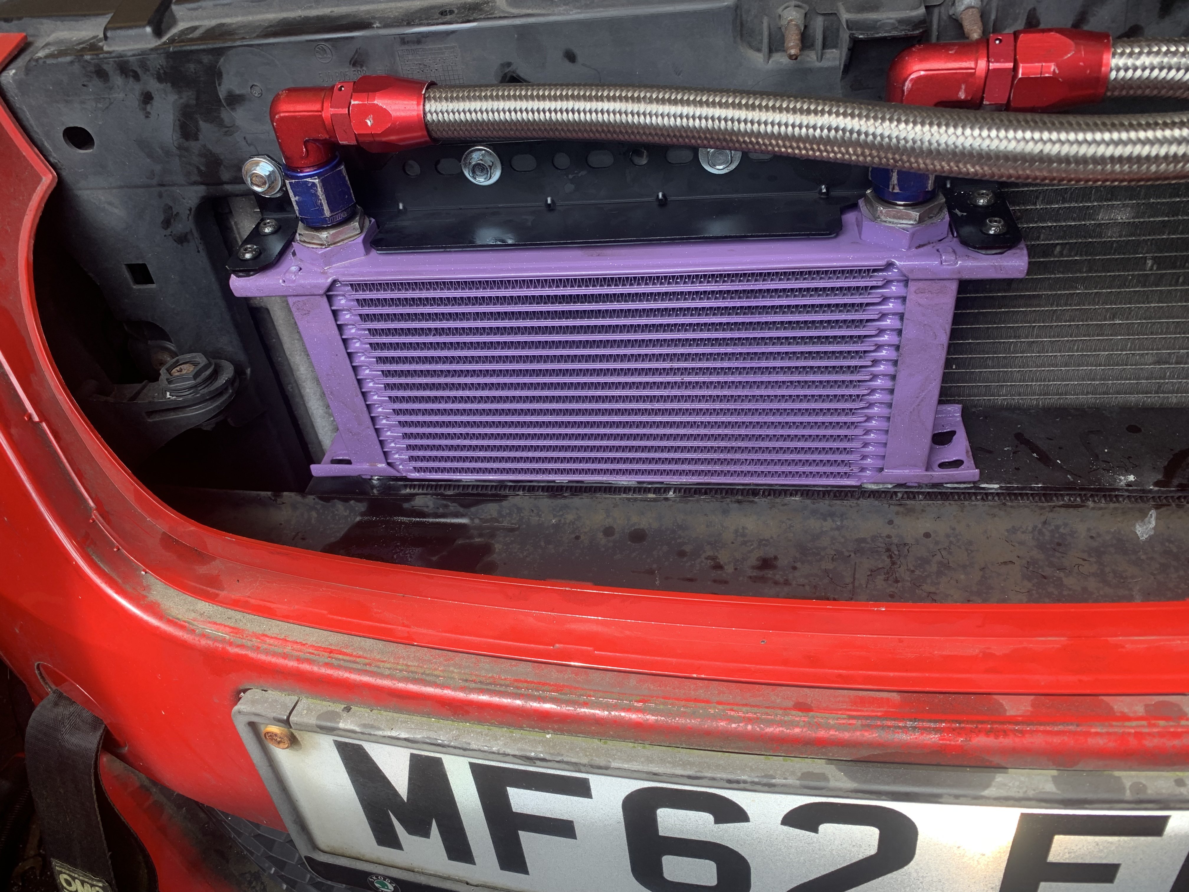

276E2CEA-BD7C-4D89-9EE8-DF281F5951BC.thumb.jpeg.198016e94a8144887020c617cc998bd6.jpegoil cooler in place

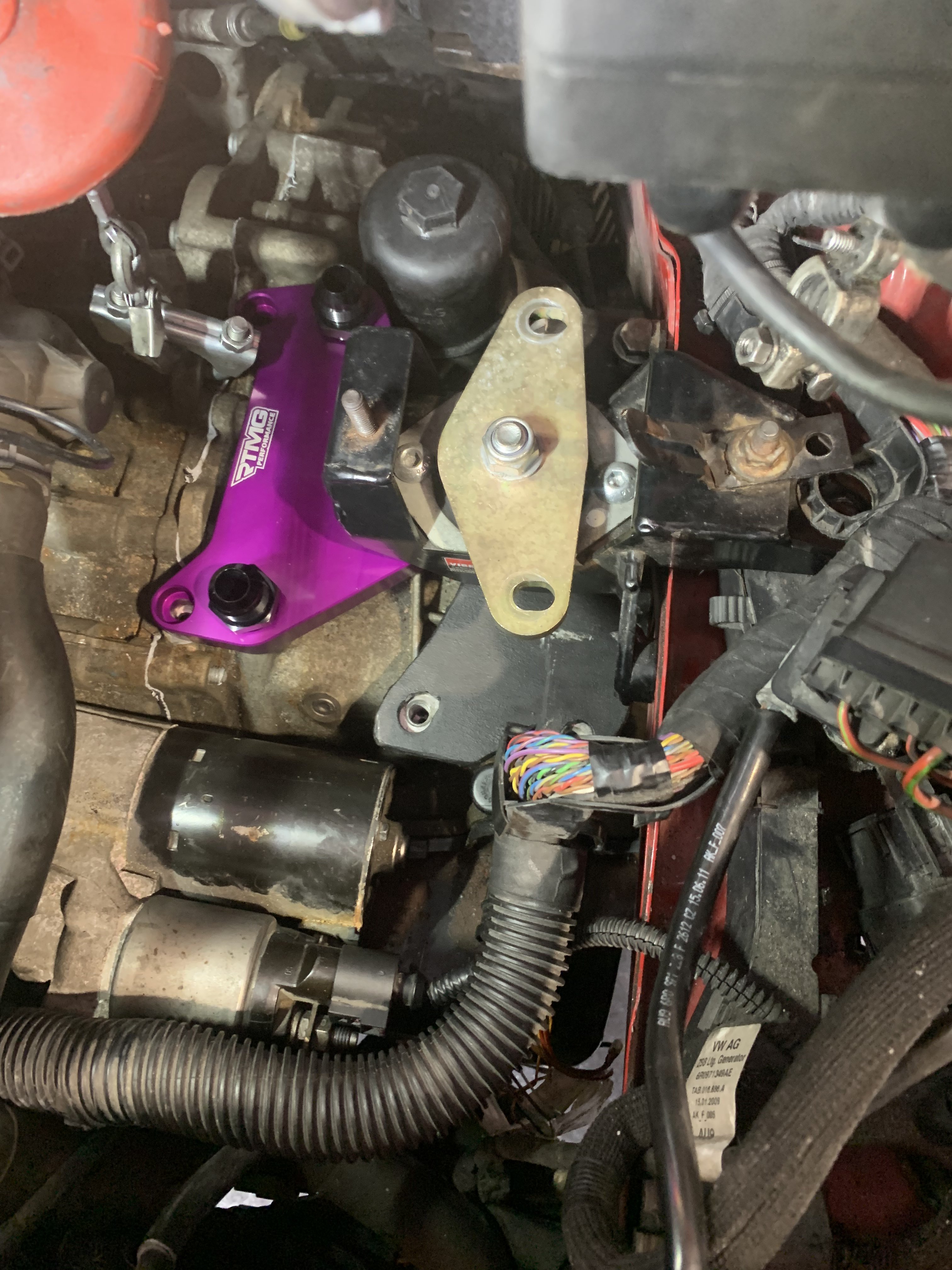

Hi mate project is pretty much complete gearbox works fine just making a proper mount for the gearbox as you need essentially a hybrid mount between the dq200 mount and the dq250 mount , I’m starting a new project soon that I will be posting on here , I’m taking a rover k series turbo engine out of a rover 75 and mating it to a dq250 gearbox from a golf R and sticking it in a mg zr.

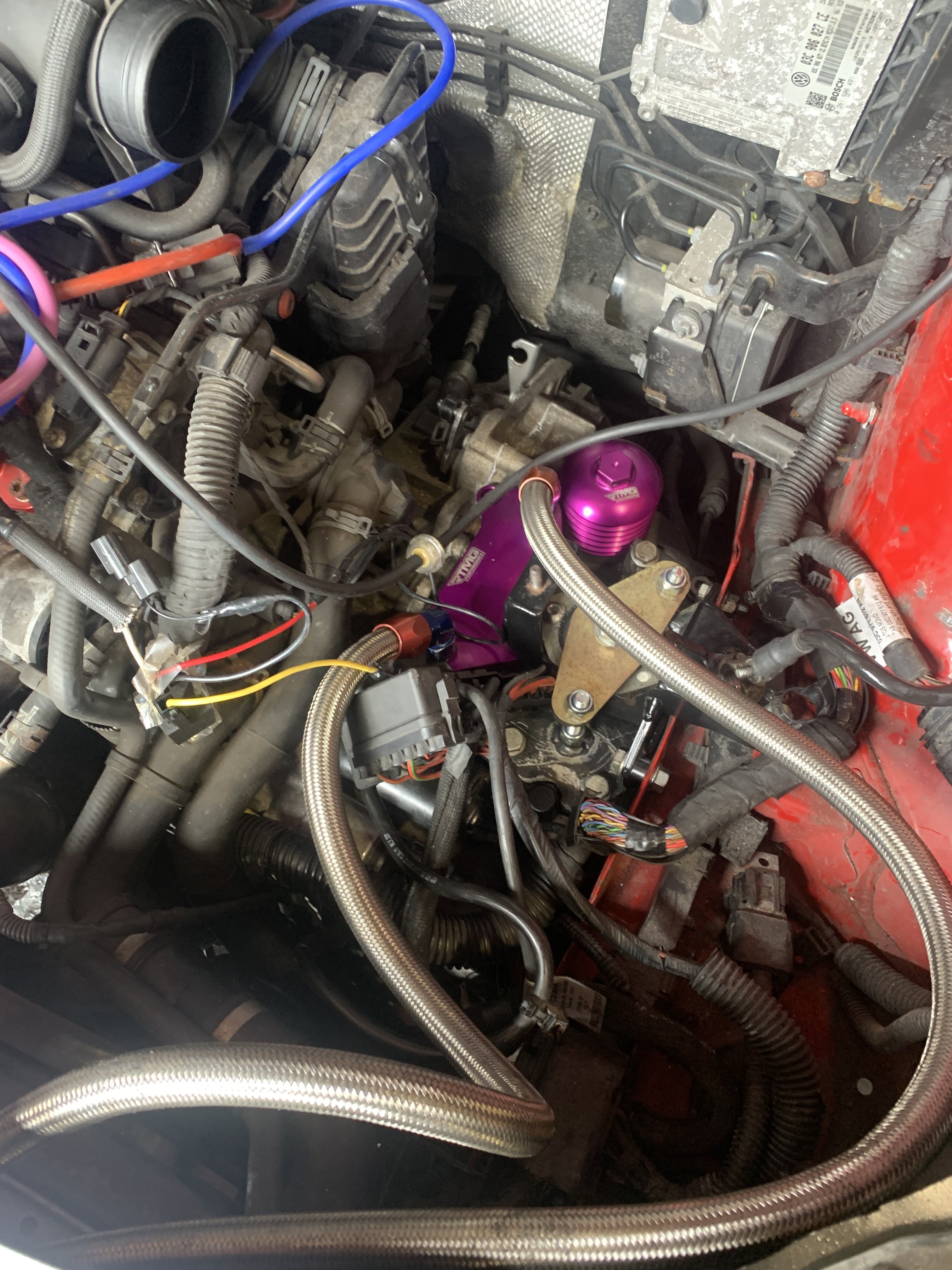

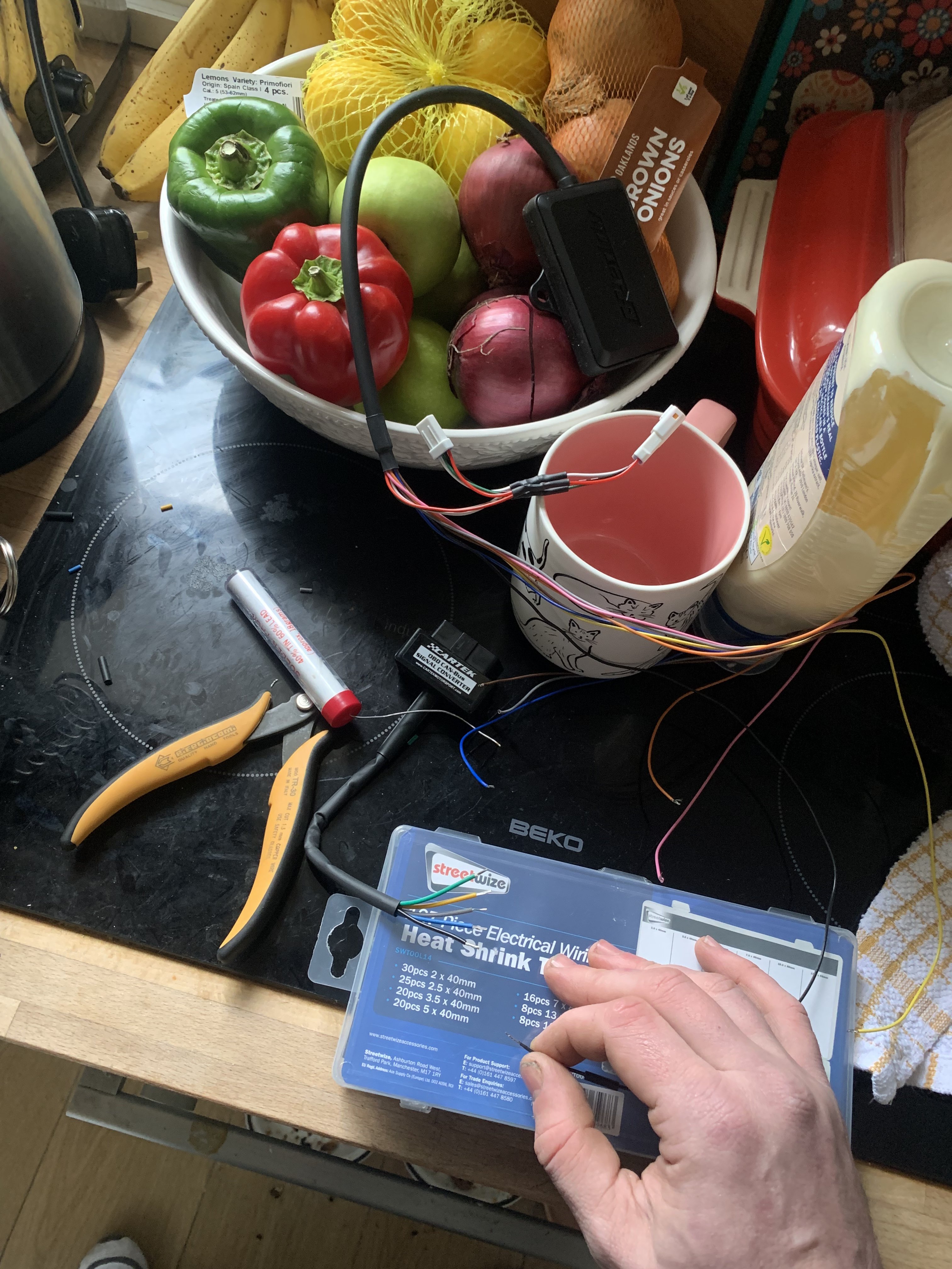

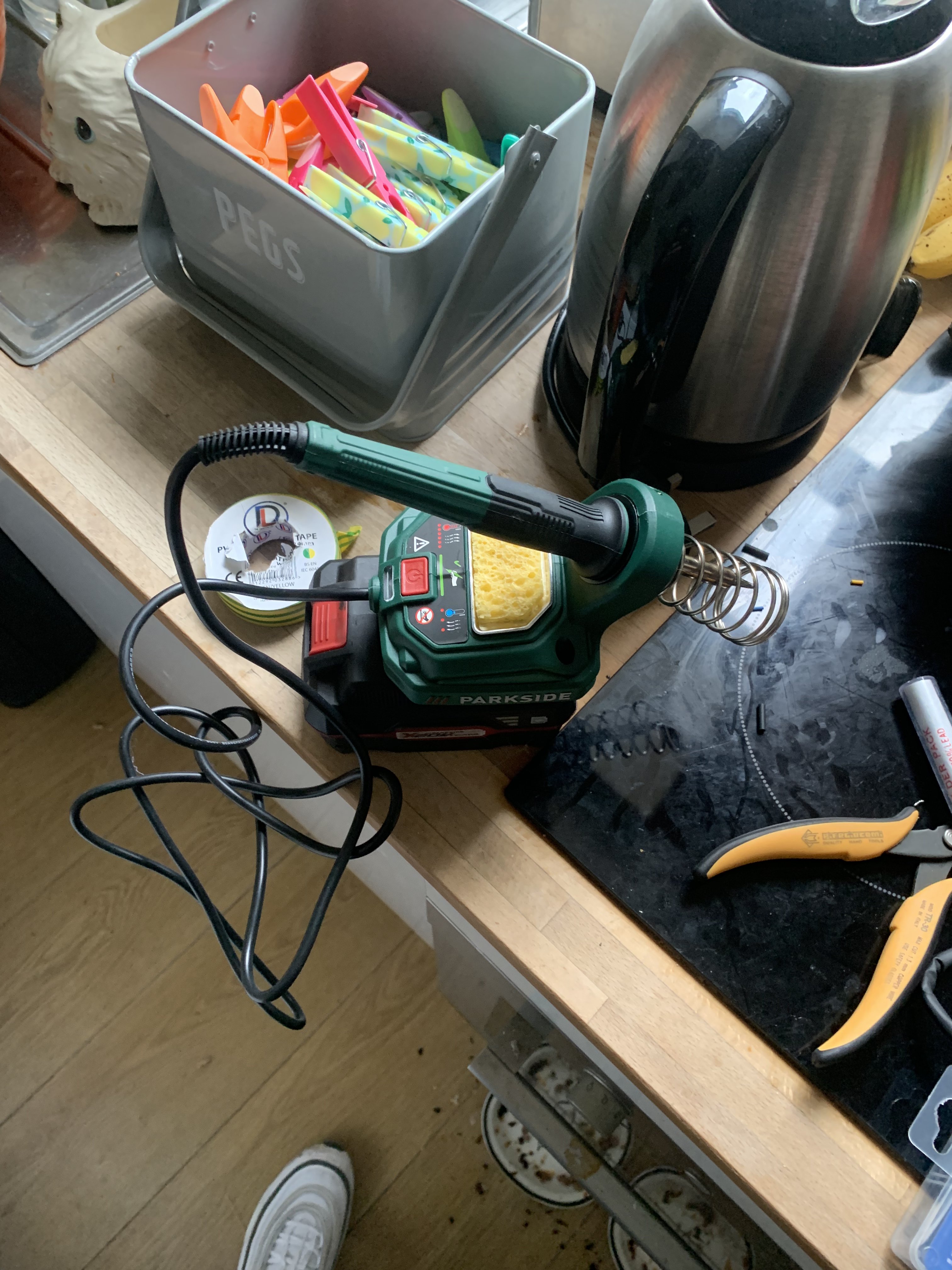

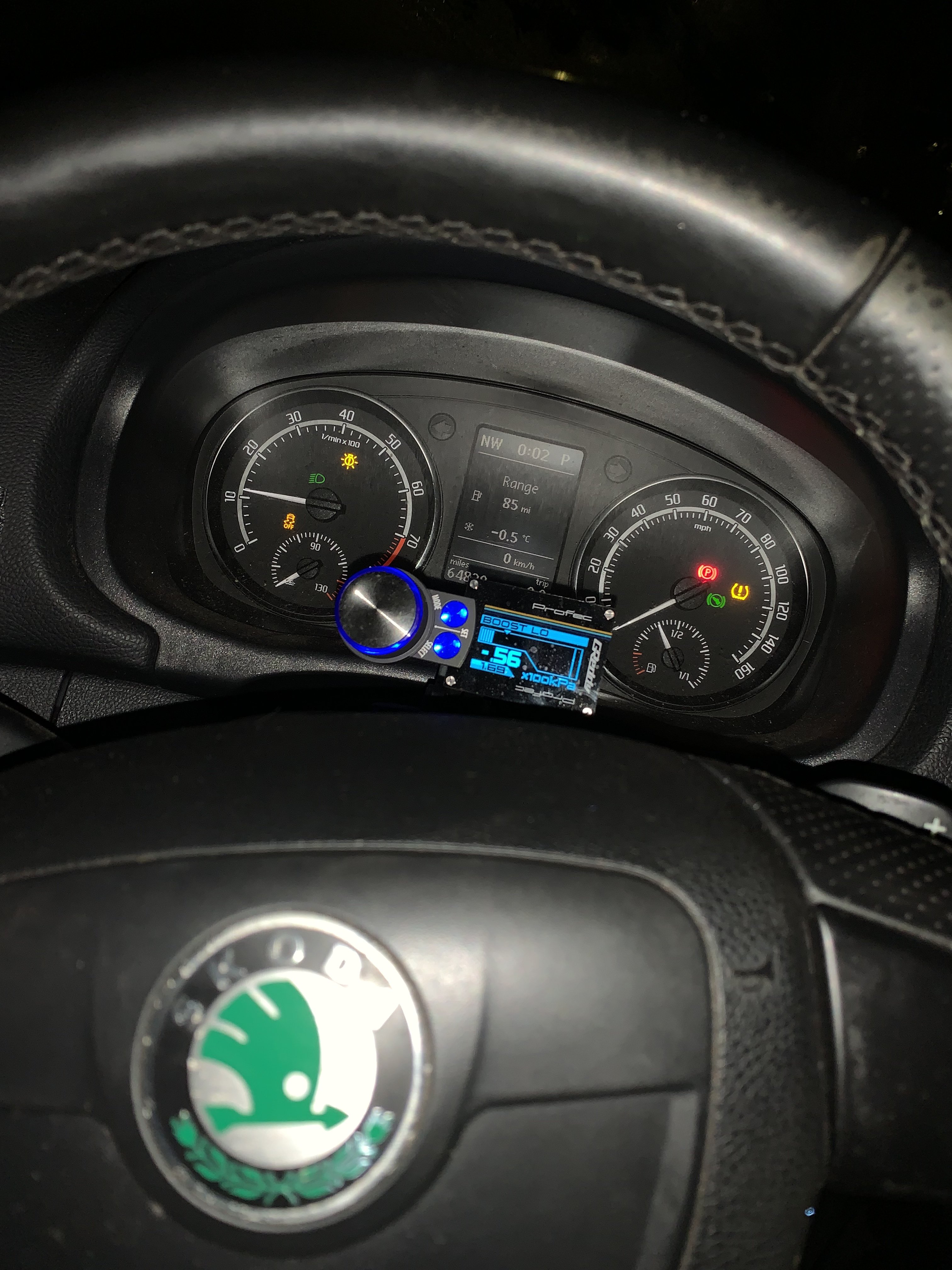

Bit of progress on my fabia this weekend , car is running pretty much perfectly now , I had a teething issue with the gearbox mount and driveshaft but I have solved those issues now (hopefully) so this weekend I have added the greddy Profec map. This is an add on to my boost controller that will allow boost by gear, boost correction, temperature vs boost throttle position vs boost etc etc , I managed this by a cartek obd converter and the Profec map adapter and a little soldering shout out to Lidl park side for the quality cordless soldering Iron EE431948-BF78-4268-99D8-6DE4B5A83BFD.thumb.jpeg.b545c2297a766ee1b56a3dd898162e98.jpegAE7E8CCD-75F6-4992-87D5-4E6B96CE67C0.thumb.jpeg.7663d938966e12560a2d4af085795e78.jpeg11C1B695-6601-4DC6-B866-E9C98AB13249.thumb.jpeg.ca65485dc2f0e5aed9e899ed4d6450c7.jpeg

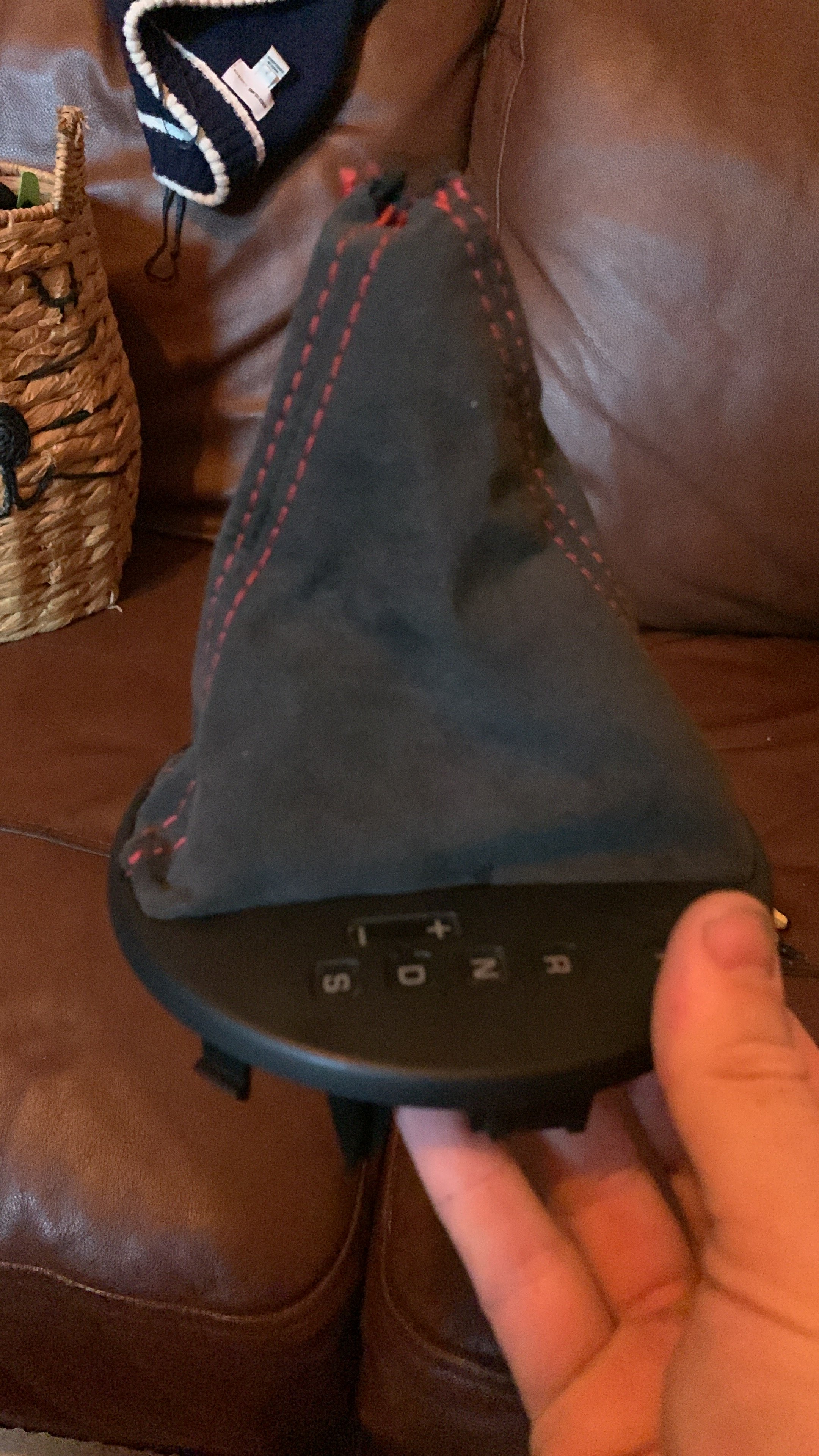

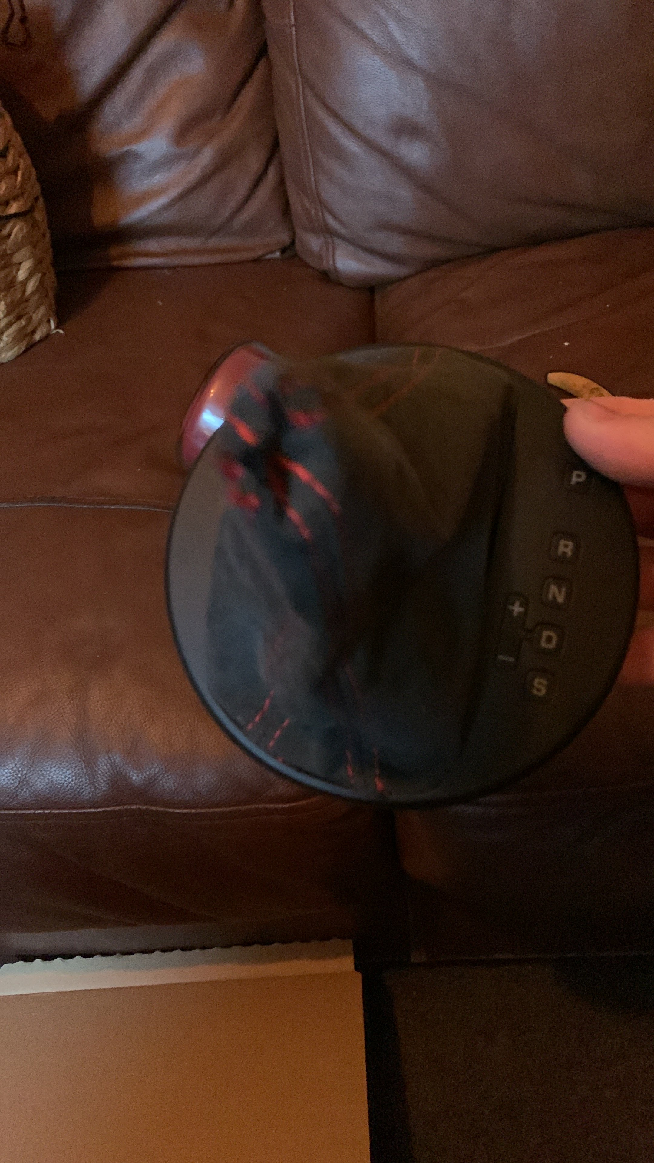

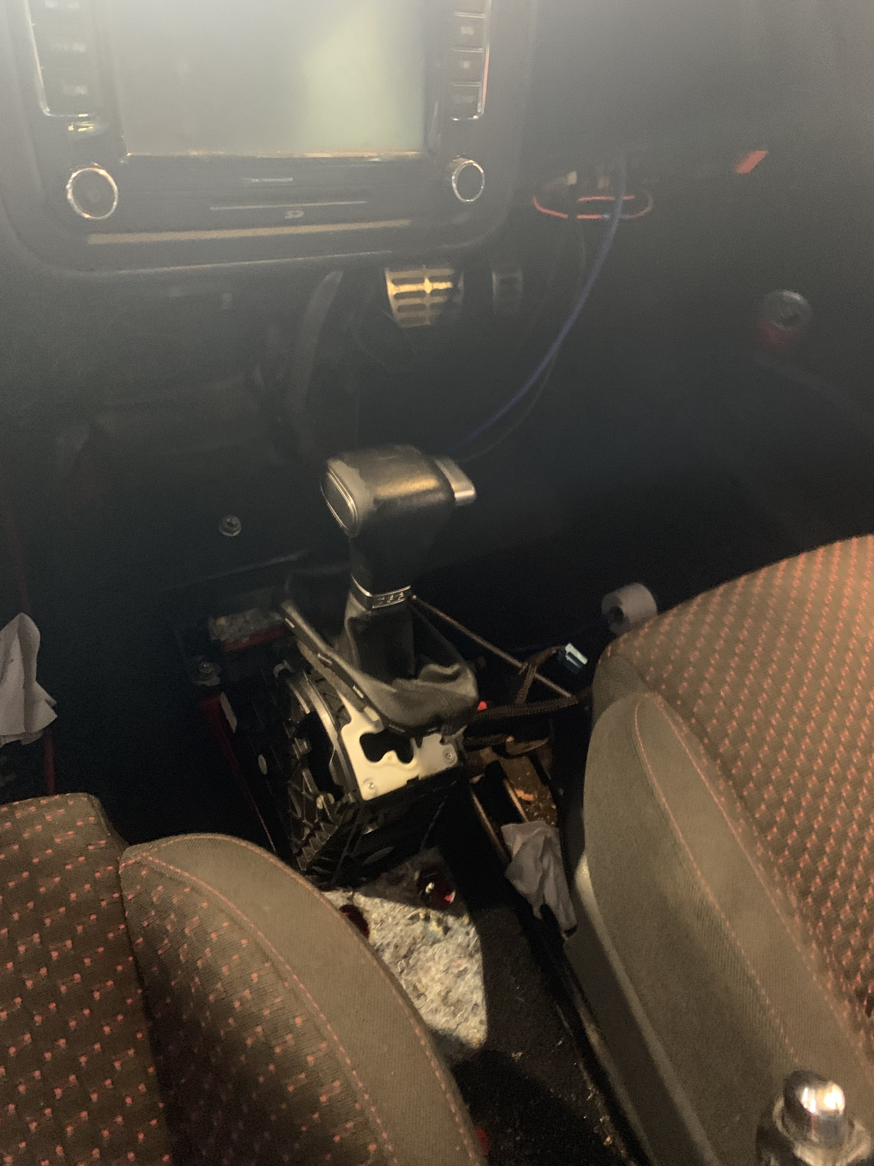

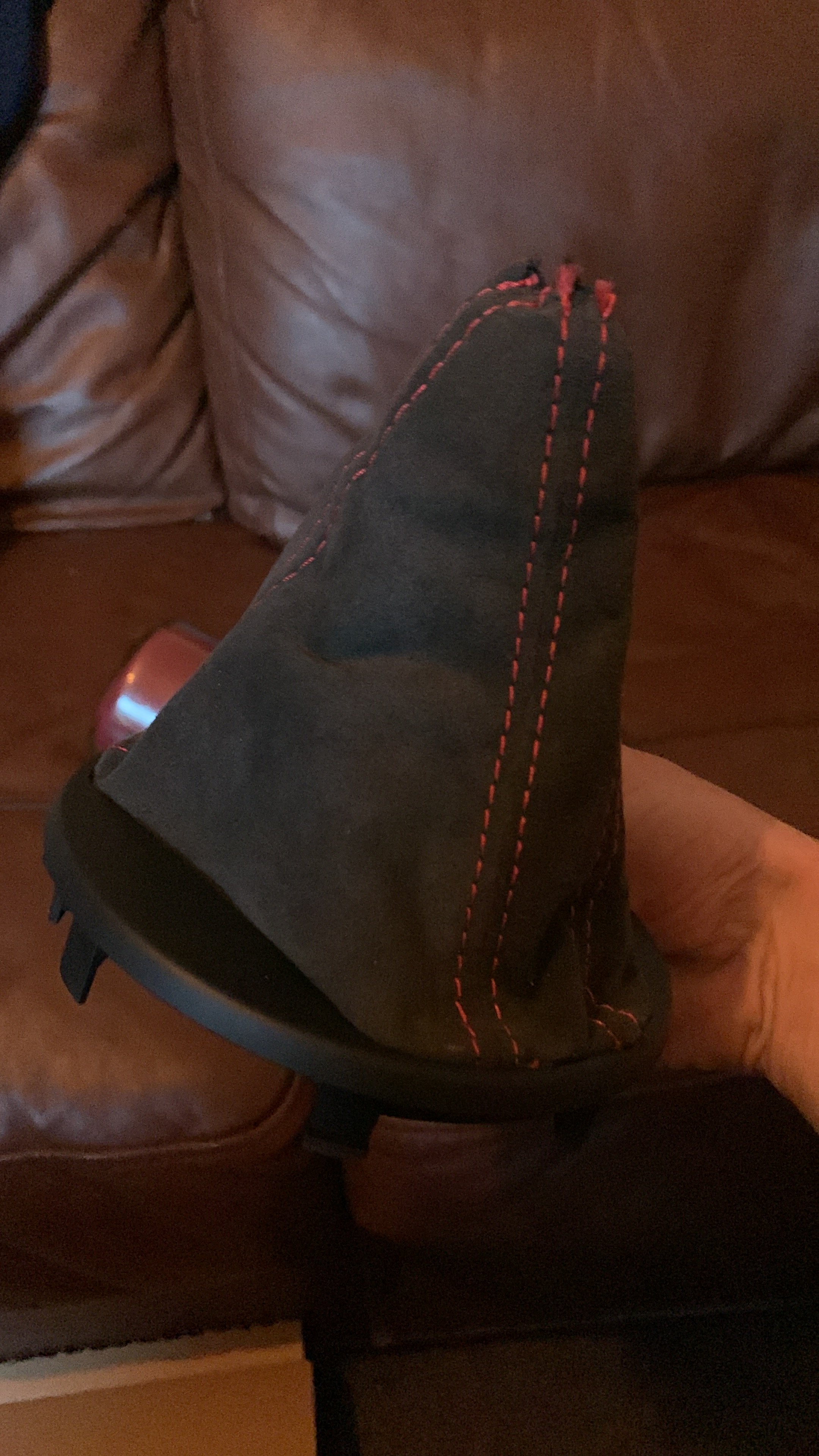

Hi guys & girls small update I’ve been incorporating the dq250 gear shifter into the oem centre dash , as the PRDS lights and gator on a dq250 gearstick goes into a square plastic plate and the dq200 one goes into a circular dish plate it would never of fitted into the Skoda fabia centre console  so I have taken the circular dish dq200 plastic centre console part apart and while I was at it I changed all the surface mount  LEDs from boring green to UV purple, also while doing this I swapped the gear gator from the horrible black fake leather to some napa leather gator from Ali express and re upholstered it onto the Skoda fabia plastic (such rubbish quality plastic it virtually shattered instantly)
