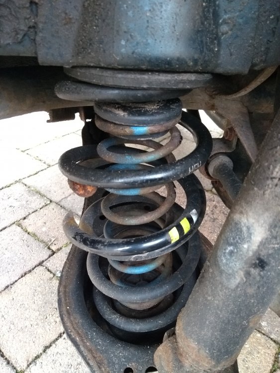

I have checked on the car and both sides have the colours White-Yellow-Yellow which according to the webpage in @langers2k post is part number 1K0511115BE. This relates to a Kilen part number of 63117 and I have ordered a pair of springs of Ebay. I have also ordered new bolts and nuts from Skoda for the stretch bolt that I will have to remove. Thanks to all for your help and here is a photo of where the spring has broken.
Good choice with the Kilen 63117 spring.
White-Yellow-Yellow does appear to be 1K0511115BE. This is the OEM part number for the Hatchback not the Estate.
However, the Kilen 63117 uses a one size fits all approach as it replaces both the 1K0511115BE and 1K0511115BF OEM part numbers. This means that the Kilen 63117 will probably match the stiffer spring of these two OEM part numbers which is OEM part number 1K0511115BF. This is quite handy, as 1K0511115BF is the stiffer version for the Estate and not the softer version for the Hatchback.
It looks like Kilen 23110 would be the front spring as it matches OEM part number 1K0411105BC
