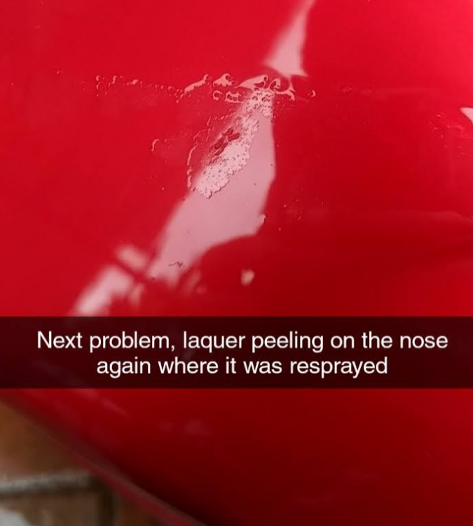

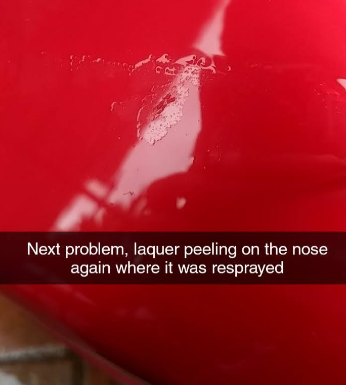

However, I have a new problem and looking for advice... the car had some areas resprayed previously and a big chunk of lacquer came off the nose during washing. I know it really needs professional respray but in the meantime, how would I get on using the DA and Mazda's chip paint to patch it? I was thinking an aggressive but well lubed compound like a Koch H8.02 using the firmest 4" pad I can get my hands on to smooth off the edges, brushing on lacquer then compounding again and polishing. But I have concerns if any DA would provide enough cut to make a notable difference and if I risked breaching the clearcoat of the surrounding good paint. Hopefully such a setup I could then spot use on some deeper scratches too?
And as a side note, is the 4" pad suppose to vibrate much more than the 5.5"; I'm only really comfortable with it at speed 3.5 vs speed 6 (max) on the 5.5"? Do 4" pads cut more or less?
