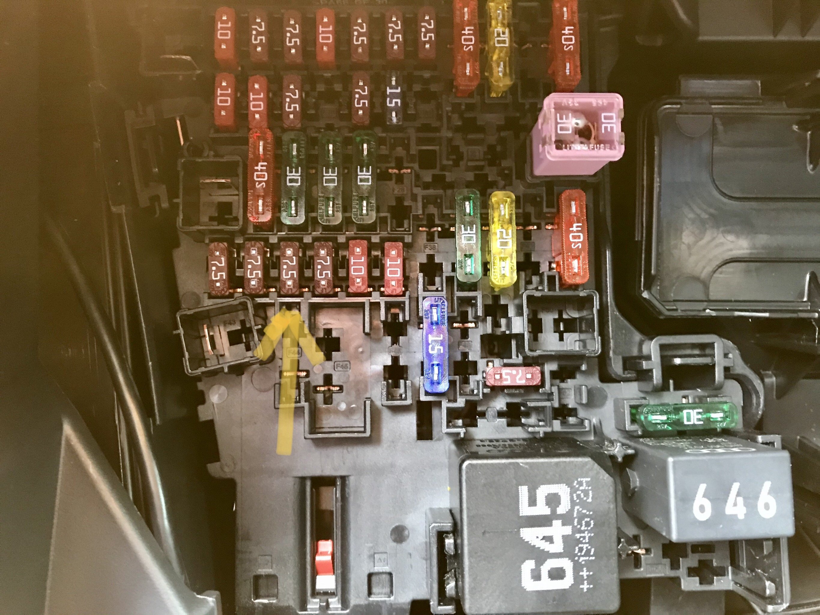

If you get a chance take a picture of your fuse box and highlight which fuse it was you removed. Skoda went through a period of reversing their fuse locations on the sticker that they used to apply to the inside surface of the dash end panel, but the illustration in the manual should be accurate.
The only way to clear the airbag warning light now is with a diagnostic tool / code reader.

Maybe they are reversed, the pic attached shows which one is the airbag. Which is confirmed by afterwards taking the fuse in and out and the amber airbag light in front of the gear-lever going on/off.

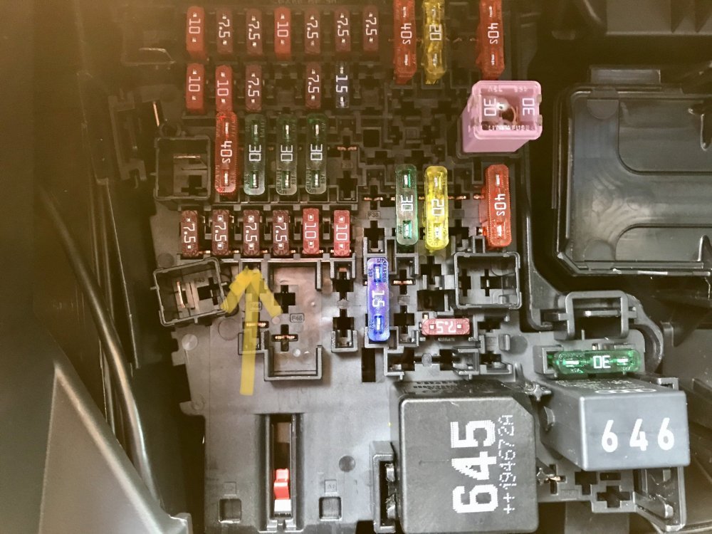

Interesting, here is my fuse box, the amperage of the mini-fuses on the same row as yours do seem to differ slightly so there are clearly variances car-to-car...
Fuse #34 is indeed the same as yours, "Air conditioning, reverse light switch, mirror with automatic dimming, seat heating, parking brake, light switches, bar with switches, electric auxiliary heating, USB ports".
I wonder if "bar with switches" has anything to do with it, isn't this where the actual airbag warning light is located? I can't think which of the other functions would be related to the airbags?
Interesting though that fuse #33 "airbag" on my car is 5A, whereas on yours it is 7.5A.

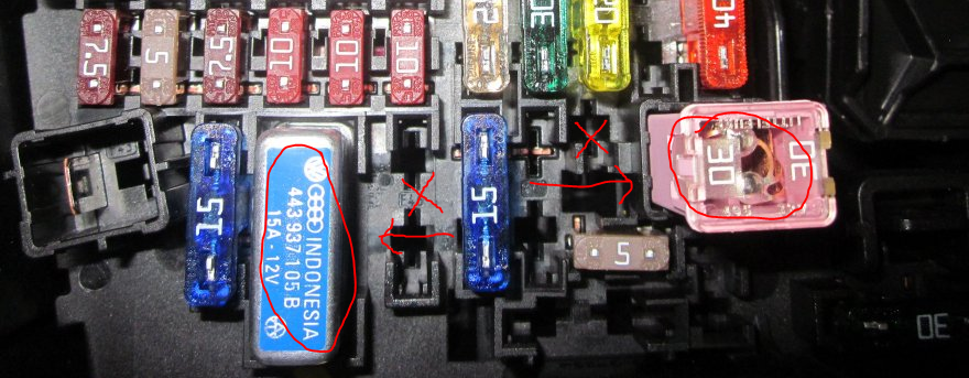

When fitting a dash cam to a Yeti, it was recommended to use the rear wiper fuse to avoid issues such as this.
On the picture above, it is the 15 amp, blue one, on its own in the bottom row.
That is the same advice on the Kodiaq too, unfortunately, as mentioned earlier the use of the 15A rear wash wipe fuse is precluded on some models of the Kodiaq, such as mine, that are fitted with electrically operated front seats and the electrically opening and closing boot lid.
This is because these two features (the latter not being available on the Yeti) means fuse positions 45 and 50 are occupied, preventing the use of a piggyback fuse holder as the larger than usual fuses obstruct the proper fitment of the fuse holder...
Ah, that’s a bugger!
I did rule out fitting to the left, but thought the right would be able to squeeze the piggyback into.

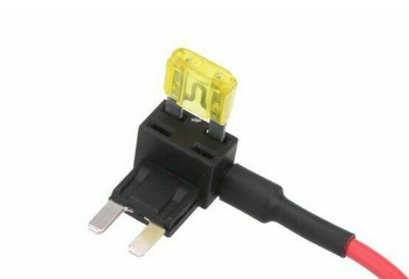

I’ve since moved the connection to the 15a wiper motor fuse. I couldn’t when I originally fitted it as I couldn’t find my Nextbase piggyback adaptor for the larger fuse.
I didn’t have a problem with fitting the piggyback connector as I don’t have many fuses fitted adjacent to it.
Yes, unfortunately the piggybacked fuse does rest against the pink 30A fuse. It does fit but not flush.
I wanted a nice solid fit, friction on the terminals of a poorly fitting fuse is rarely good.
I am sure there will be slightly different designs and manufacturers of piggyback fuse holders, it might be some are slightly more compact than others and therefore may well fit unimpeded.
