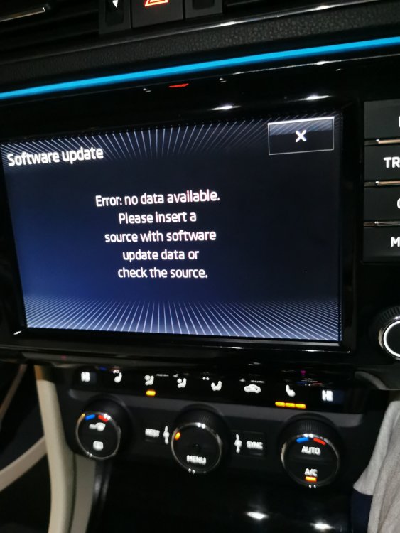

You don't have to do any update. The screen you have showing there on the picture is the software update procedure, not anything to do with sat nav data or update. Just load the maps data onto the card and insert it into the machine. The card stays in the machine all the time and the maps data is read and used off the card.

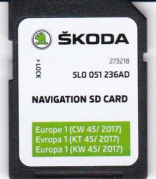

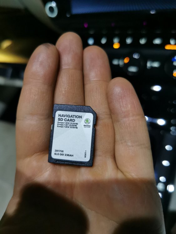

Hi
I want to update my maps but I don't know if I have a Amundsen or a Columbus system, because it looks like in one you need the original Skoda SD card and on the other any SD card will do.
How can I check which system do I have??
I join a picture of my actual and original Skoda SD card.
Superb 2.0TDI 150cv Style from JUN2018
7 minutes ago, Rustynuts said:
Does your sat nav work without the sd card inserted? If so, Columbus. If not, Amundsen.
Thanks Rustynuts
I have checked and it does not work without the SD card.
So it is a Amundsen.
This means I have to use my original SD card.
Now I have to look for how to update  my maps.
16 minutes ago, Kirstylm said:
I have a 2018 superb 3 estate. Bought a month ago. It didn’t have satnav as card, so the non-Skoda dealer we bought it from got a memory card and downloaded the data, but it’s still not working? Any help?
That looks like an Amundsen - you need a proper Skoda SD card rather than a 3rd party one :)

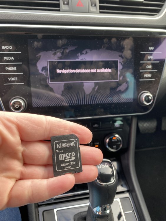

My car currently has no SD memory card installed for maps; I would like to update this for my 2017 Superb as they are set to its 2017 build date. I have inputted the VIN on the Skoda Portal and believe it's a Columbus system.
If i purchase a generic 32GB SD card what physical size card do i need?
