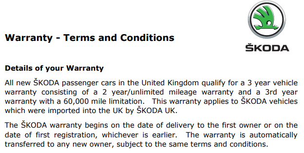

Most VW Finance lease deals are 2-3 years with a mileage  limit under the 60,000 mile manufacturer warranty limit, so if it does fail, the car has been serviced correctly, it hasn't been modified, you haven't entered any race events and have responded to any recall requests you would be able to claim under warranty...
https://az749841.vo.msecnd.net/sitesengb/alv1/681e0567-9e39-4078-88de-df61013683c7/SKODA_Warranty_Terms_November_2018.59c8de521ff537083074db669bd4a47d.pdf
