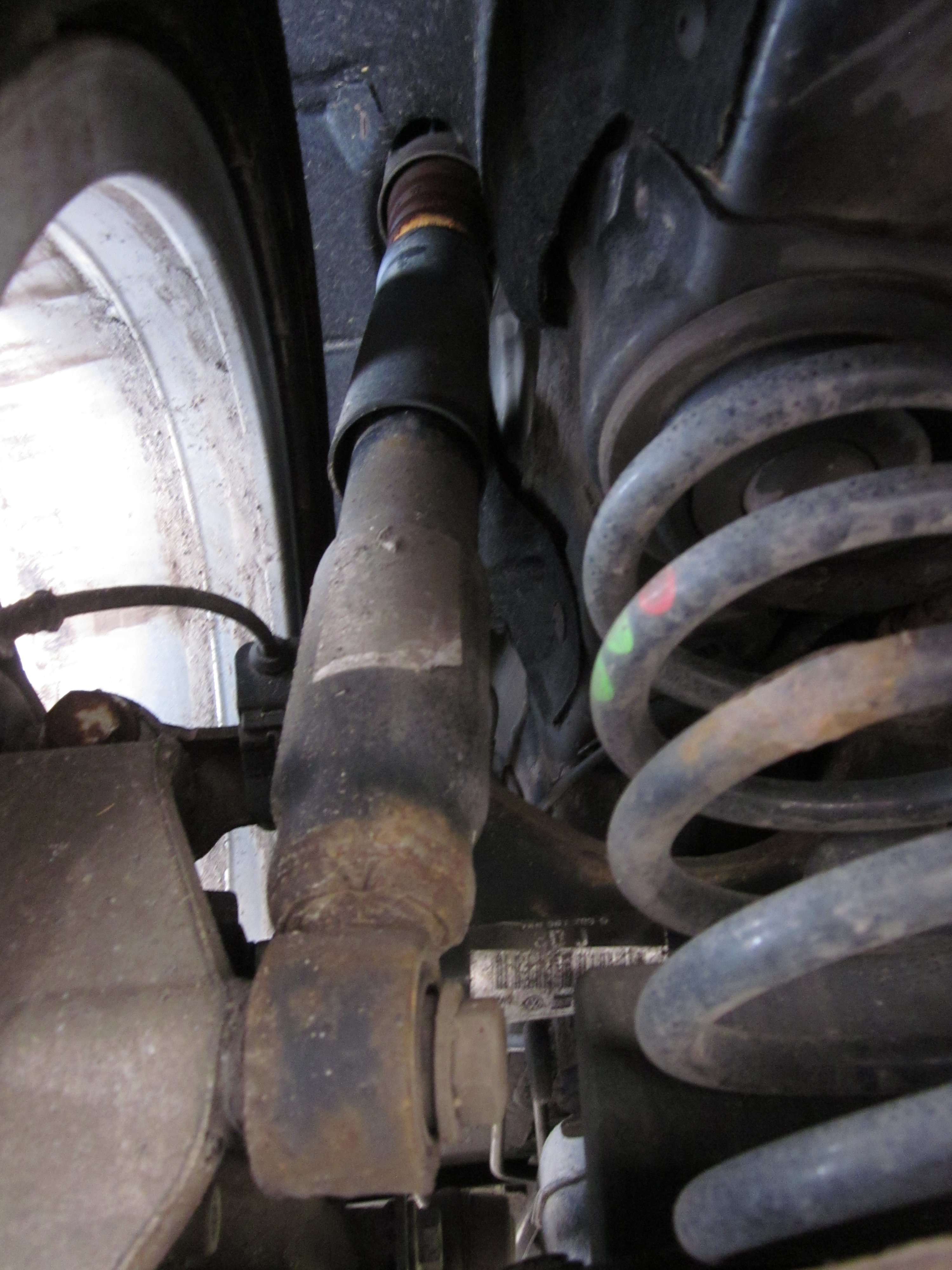

Not sure if this is of any use, but this is a photo of the nearside rear suspension set-up on my 2008 Octavia Scout.
I understand the three coloured dots on the spring give an indication of their specification?

The weight of the coil springs on the 4WD is much more than the 2WD.
2WD front is about 1.65kg, 4WD front is about 2.45kg. 2WD rear is about 1.95kg, 4WD rear is about 2.60kg. My own estimate is that the front using 4WD springs is raised by about 28mm, and the rear using 4WD springs is raised by about 44mm. My estimate takes the different lengths into account, and assumes that every 0.25mm of extra coil spring thickness compresses 4mm less on an unladen car. My estimate could be out by quite a bit, but I would still expect the 4WD springs to add a lot of height to the car, especially at the rear. You may not like the much harder ride, as the 4WD springs are much heavier duty.
You can compare the specification of the 2WD and 4WD springs on the gknautomotive.com website. They have an online catalogue.
