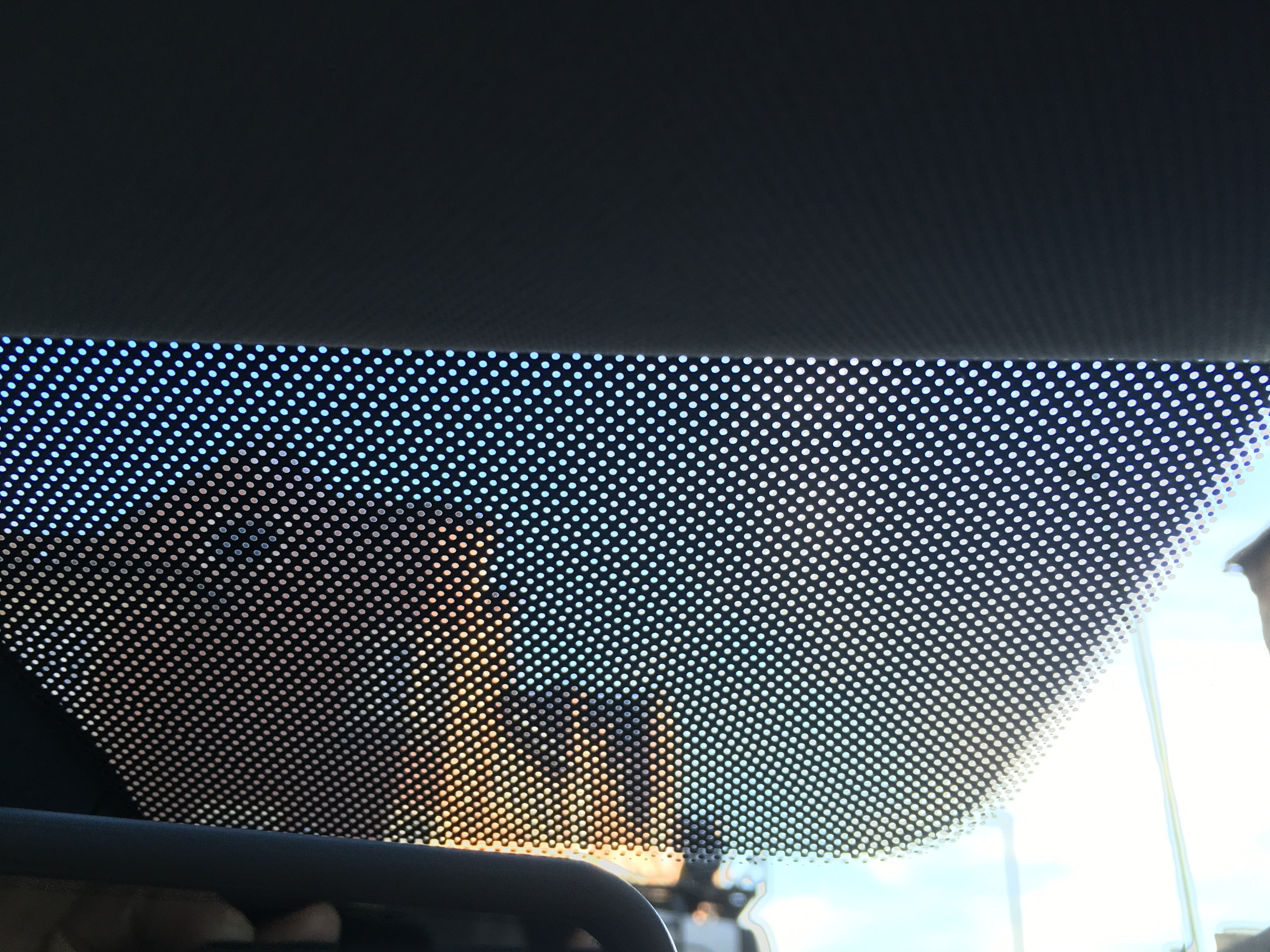

Also (and a minor point this, but it annoys me) the fritting patten on the Pilkington screen is very badly designed and creates a distracting effect. Perhaps someone here will understand and shares my pain!

I wouldnt have said the sun glare strip was distracting - its a decent size.  My Audi doesnt have one so i ended up making one out of black Vinyl as the sun glares through the gap
It’s not the shade strip itself that’s distracting, it’s the arrangement of the dots. It’s different to the oem screen and there’s an interference pattern that jumps out if you look from a certain angle. Not clever of whoever designed it.
What brand screen is it?
Pilkington

My new screen was a Pilkington Brand.  I haven't noticed any problem with the sun shading dots
7 hours ago, webweasel said:
Pilkington
Thats what was in mine ....  Cant say I never noticed any issues.  If its bothering you get some black vinyl to cover over it.  I did this on ones side to hide my dash cam from view.
I’ll get over it 😉. Just need to fix the parking ticket clip!
