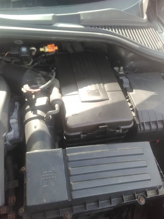

Upgrade to battery box from felt surround.
This applies to the Faclift Octavia 2, the facelift Yeti and probably all of the later vehicles with the flimsy felt battery surround.
If like me you have changed the battery from an 027 to a larger capacity 096 unit you will have found that the felt surround is no longer big enough and looks even more naff with a gap in the side join & top flap that does not fit.
The engine bay always looked unfinished compared to my Octavia 2 and it looked like the Octavia battery cover would fit the battery tray, they were very cheap on ali-Express so I took a punt and am very pleased with the result.
https://www.aliexpress.com/item/4000350318451.html?spm=a2g0s.9042311.0.0.7e944c4dr7vfmK
Edited by J.R.
Its a tight fit, best do a dry run without the battery then fit only the rear part of the box, fit the battery then slide down the front part of the box while encouraging the cable to pass through the cut out for it, then the front fixing lugs can be clipped in with a long screwdriver & the lid fitted.
