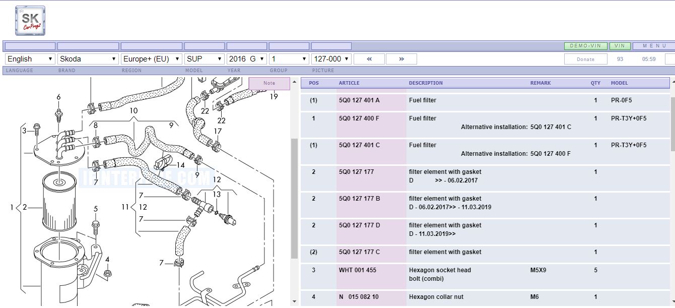

@Banquo May be my English is not good enough. Sorry, it's not my mother tongue. But I write it once again. Current filters MUST be delivered with seal already mounted on. See ETKA screenshot below for 2.0TDI fuel filter on a 2016 MK3 (same as yours). See part #2. There's no reference for the seal on its own.
This means you CAN'T buy a seal separately.
And you CAN'T go without seal. I hope I've been clearer in my explanations. 🤔
Now, if you want to try without seal, feel free. You will soon wish you had made a claim or buy a new filter with a seal.

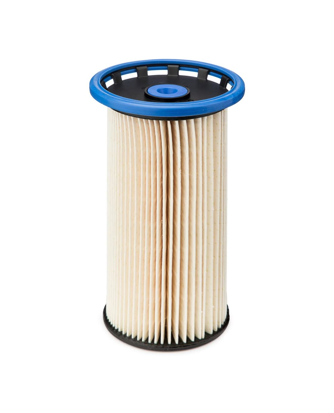

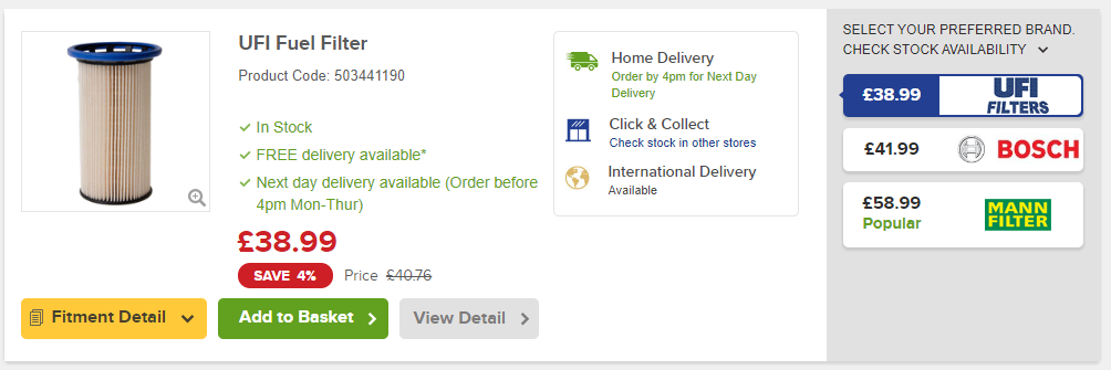

It looks like the filter I bought has a rubber lip on the top of it instead of a separate seal
Looks like you have the correct filter...

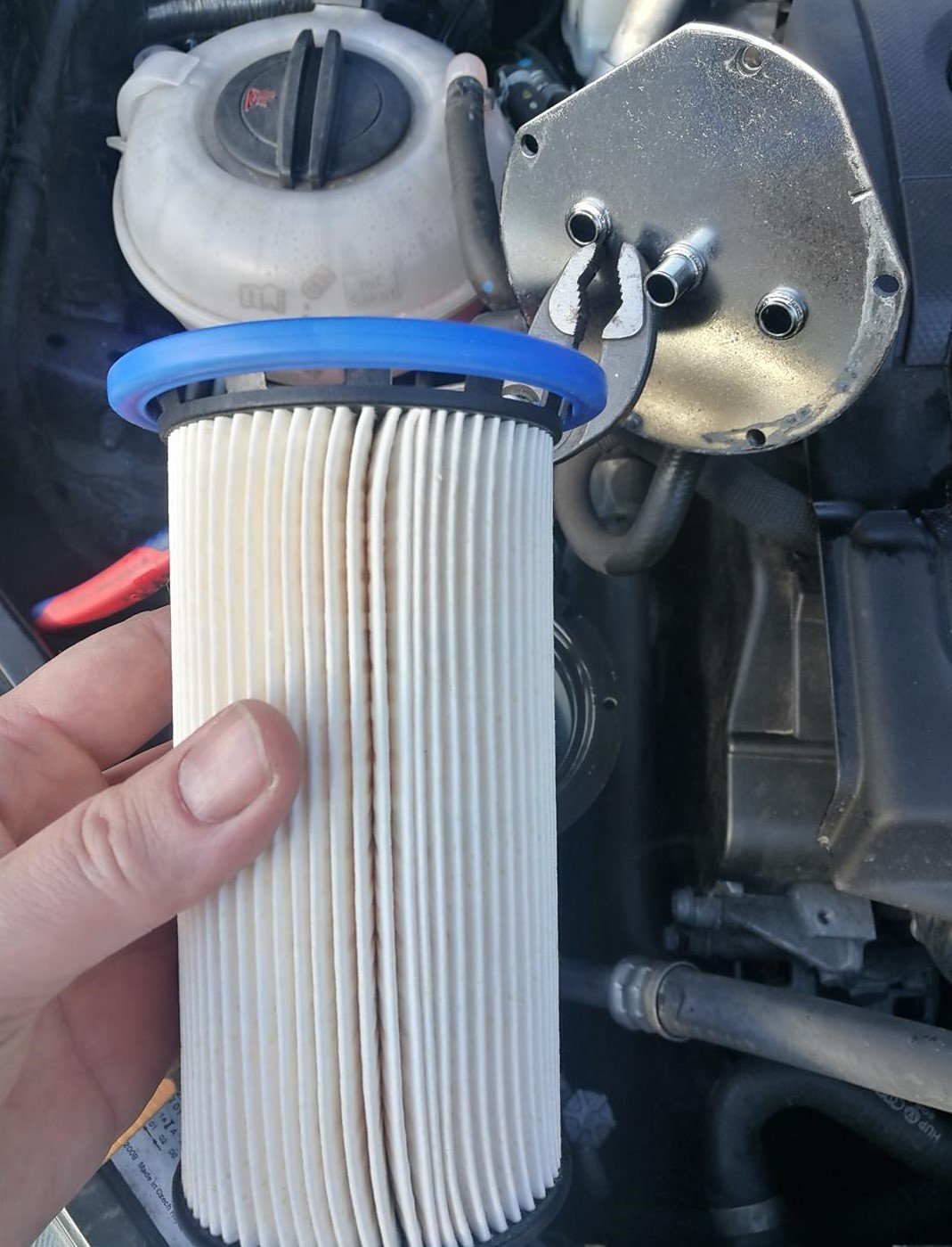

Finally got round to replacing the fuel filter today and can confirm that for my vehicle no o ring is required
Wow... Why did you say that your filter came without seal if it is like this?... Indeed, this is not an O-ring seal but a "U-shape" or rubber lip seal clamped on the upper part. Hence, you received a filter with its seal...

I included a photograph in my original post and was asking for specific advice for my vehicle. I selected not helpful because I didn't find the advice helpful or relevant to my question. Thanks for the help anyway.
 This was the first time I have replaced the fuel filter on my car so if someone has the same vehicle and question in the future at least they will know now that the filter doesn't require a separate o ring
