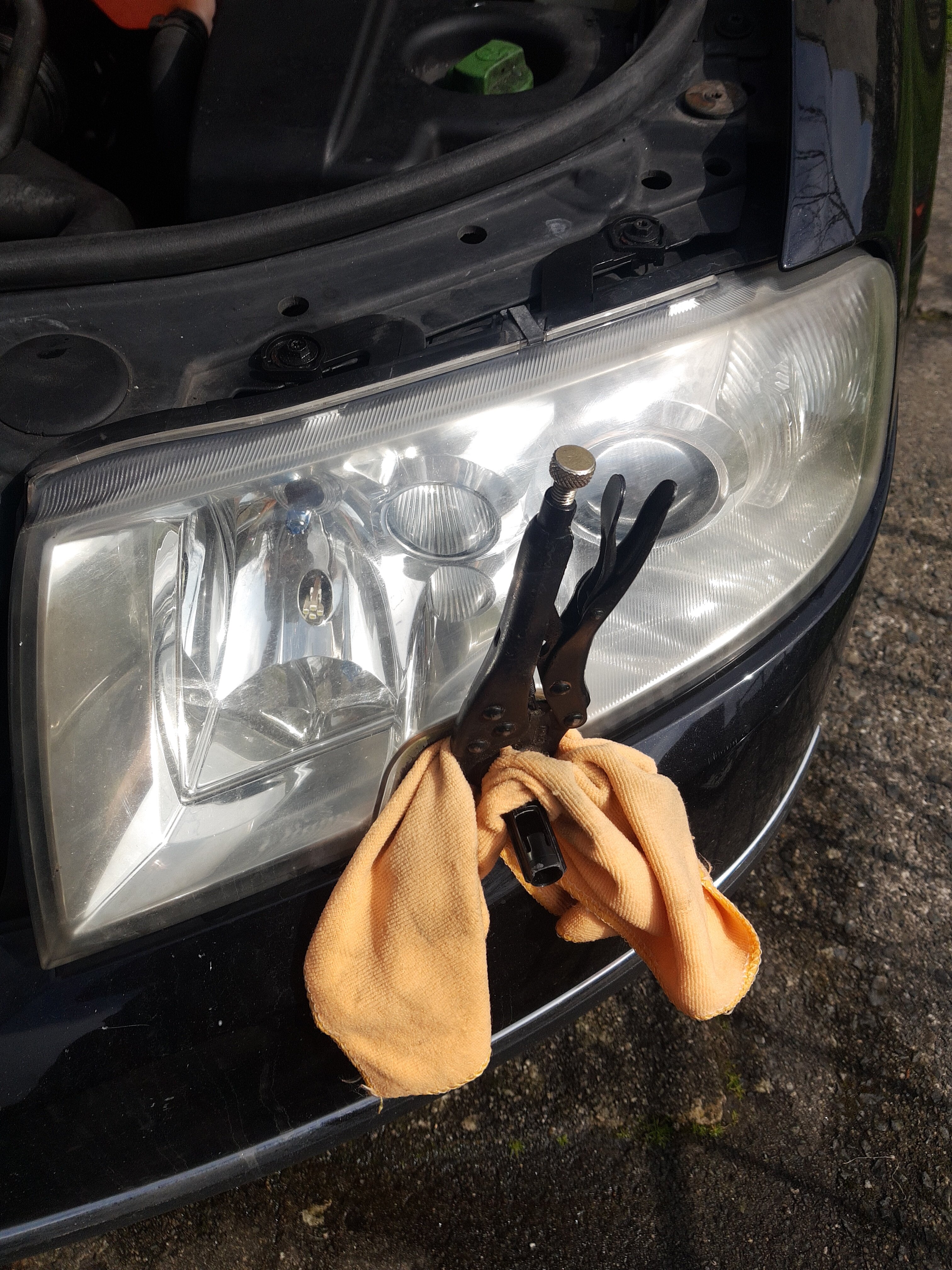

Skoda superb MK1 edition 100 - headlight washers aren't spraying anything out...
I've replaced the motor.
The headlight washers extend.
Water goes to the back of the headlight at force (unclipped and operated).
The spray jets are clear.
I have removed the jet and fully extended the arm and still nothing!
Yet nothing is coming out of the end?
Any help?!
Ignore this post now - all working after some fiddling.
In the end, I think the orifice from the headlight to the washer was blocked (as well as the motor being U/S to start with) hence no water coming out. Gave them a spray with carb cleaner then replaced the O'rings after... Now all good.
