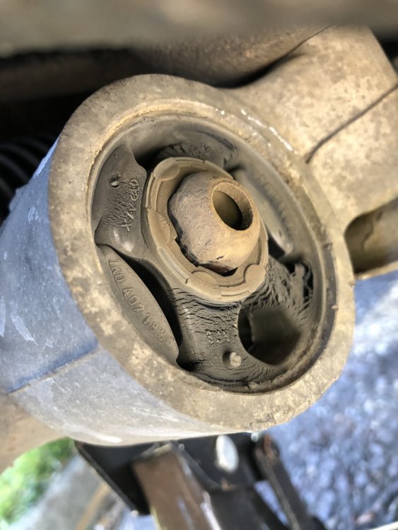

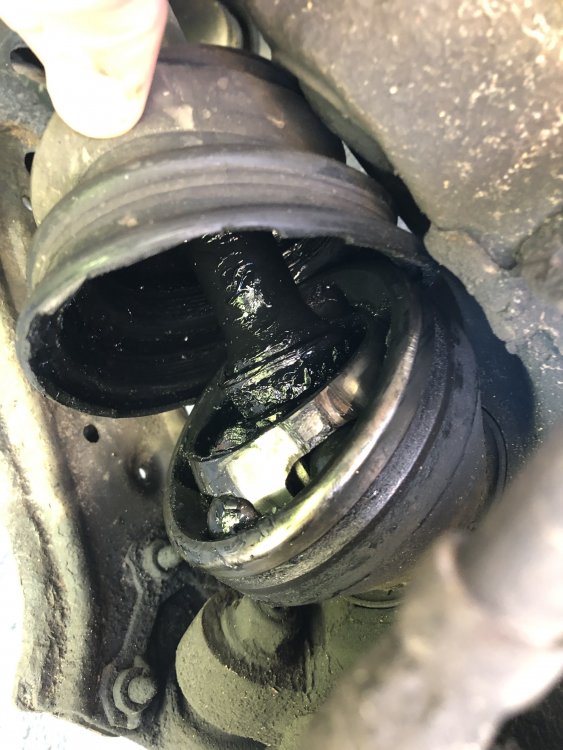

Drop links seem fine and stiff. Now I'm no mechanic, but safe to say that bush is my problem...? 😄 attached the pic of the loose CV joint as I've been having clicking on steering forever too.
Is this what is called a console bush aka lower wishbone arm rear bush?
IMG_2061.thumb.jpg.a42e43d1c62fed5a16a1846fceb074ae.jpgIMG_2064.thumb.jpg.0100e8a2c461f57c228b255e3b5ba2a0.jpg
Yes that's a console bush.
...and it looks ruined and ripe for replacement with something firmer.
You'll notice a big difference in how it drives when those console bushes are sorted
