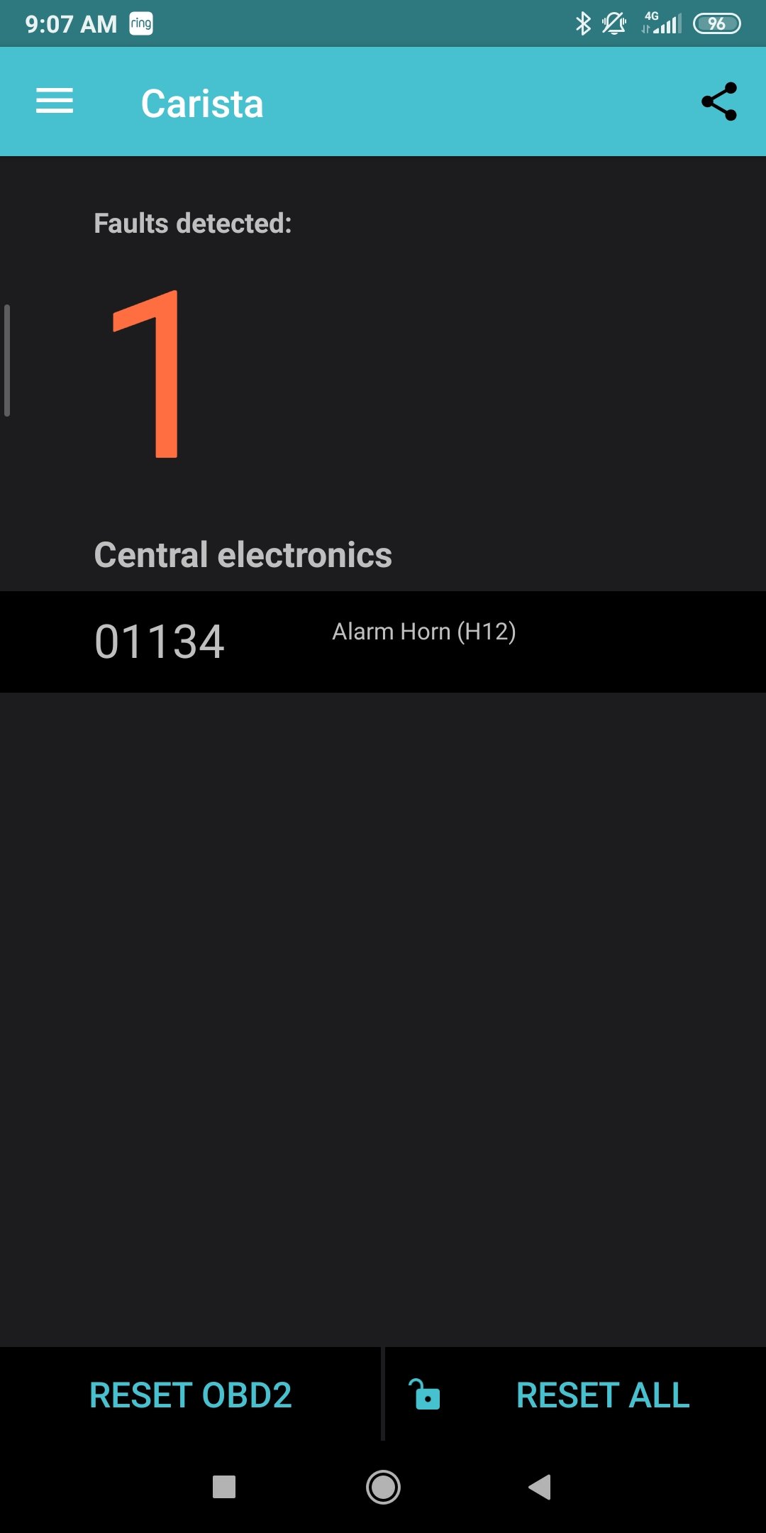

Hi All,
I have the alarm Siren code error. All the fuses are ok and it still works Iam wondering if its telling me the battery in the unit is low or about to give up?
Is it just a case of swapping it out if so is the location under the drivers side wheel arch?
Thanks
Yes. It is either wiring or more likely failing battery in the unit.
Yes offside wheel arch. Need to remove wheel, liner.
Sounds good before I do this does anyone have the part number for the Siren?

All error codes clear!!!
