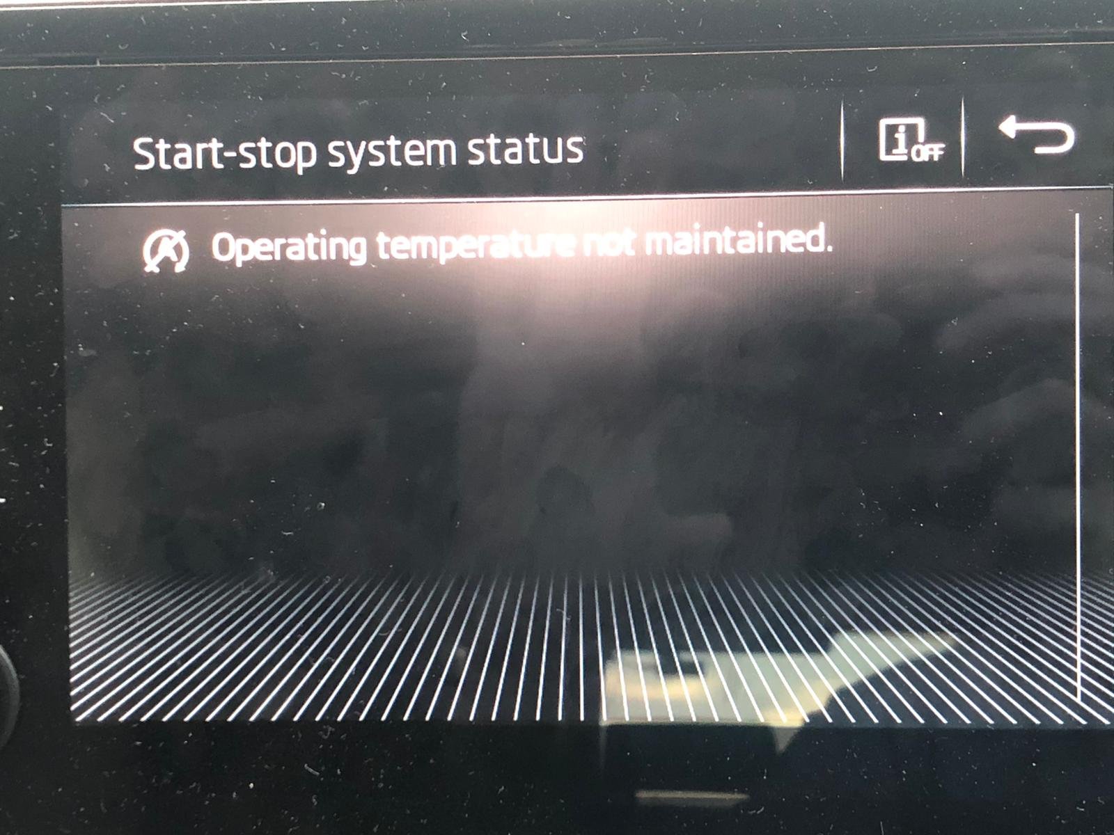

mine has the Bolero infotainment screen in it and the message it displays is attached
im pretty sure it is not due to air conditioning. Pretty frustrating as the message does not say anything further
I assume, this is not a malfunction, but only a safe mode.
If the outside temperature is pretty high and if you mainly drive for short distances at reasonable speeds (town traffic / trafic jams?), it becomes to be 'severe' conditions for the engine, which needs to be cooled down. In the meantime, if the S&S is triggered and shuts the engine off, the coolant pump stops and the cooling is very downgraded. If the S&S doesn't start the engine again quickly, there's a risk of engine oil coking in the hotest place of the oil system.
Thus I assume, there's a safety function to prevent the S&S from shutting the engine off, to keep it cool enough.
Note: Take a look at this document: VAG SSP 86 - START-STOP System in Skoda Vehicles
The document states "The coolant temperature is between 25 °C and 100 °C" (see page 14).
There is also another reason linked to the A/C use. If you make short distances the A/C may struggle with reaching the requested temperature, which is a case of S&S non operating (anotehr safe mode). See page 17, the same document states "Reasons for the interruption of the START-STOP operation: [...]The set temperature of the air conditioning system differs more than 8 °C from the actual temperature in the interior of the vehicle."
Wow thanks! This explains it! Will look at the guide in more details to learn more
