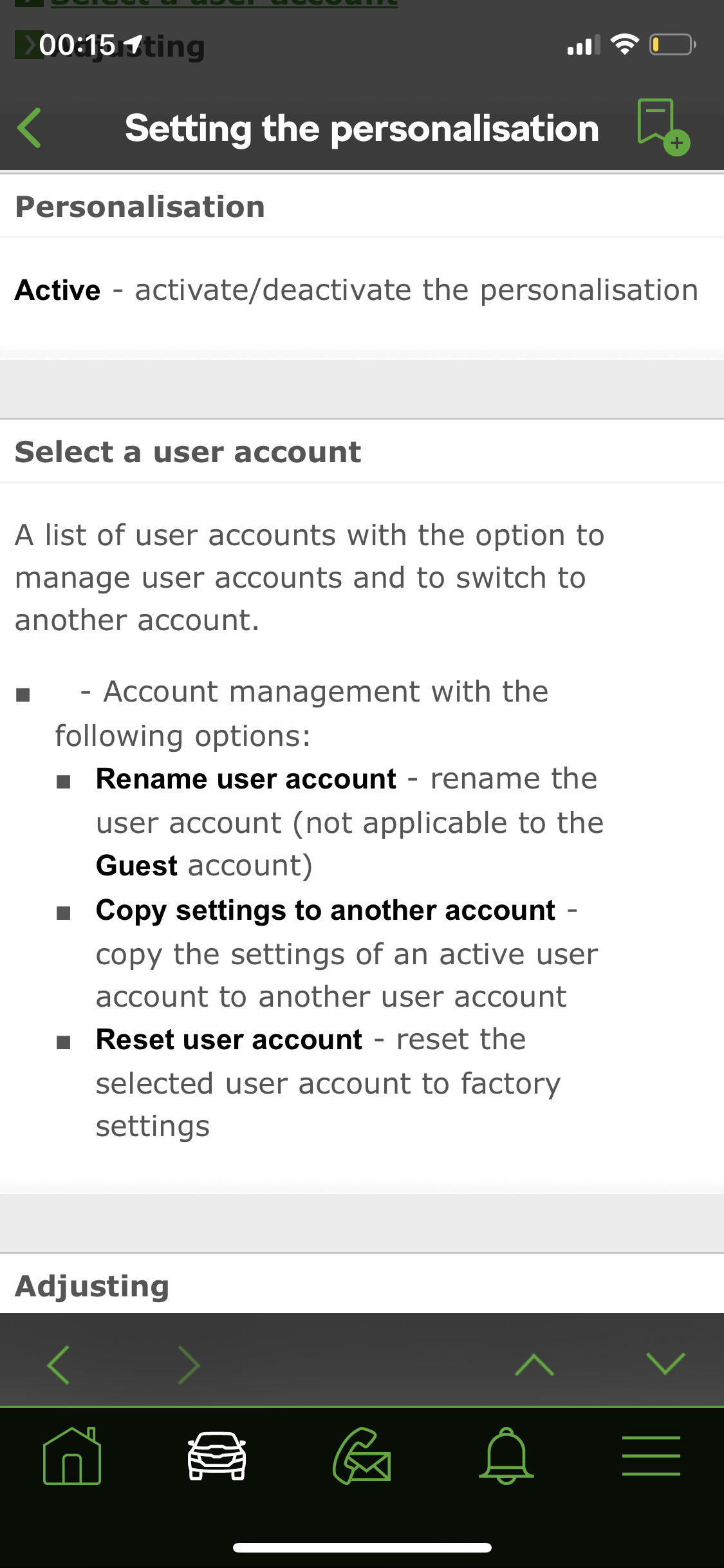

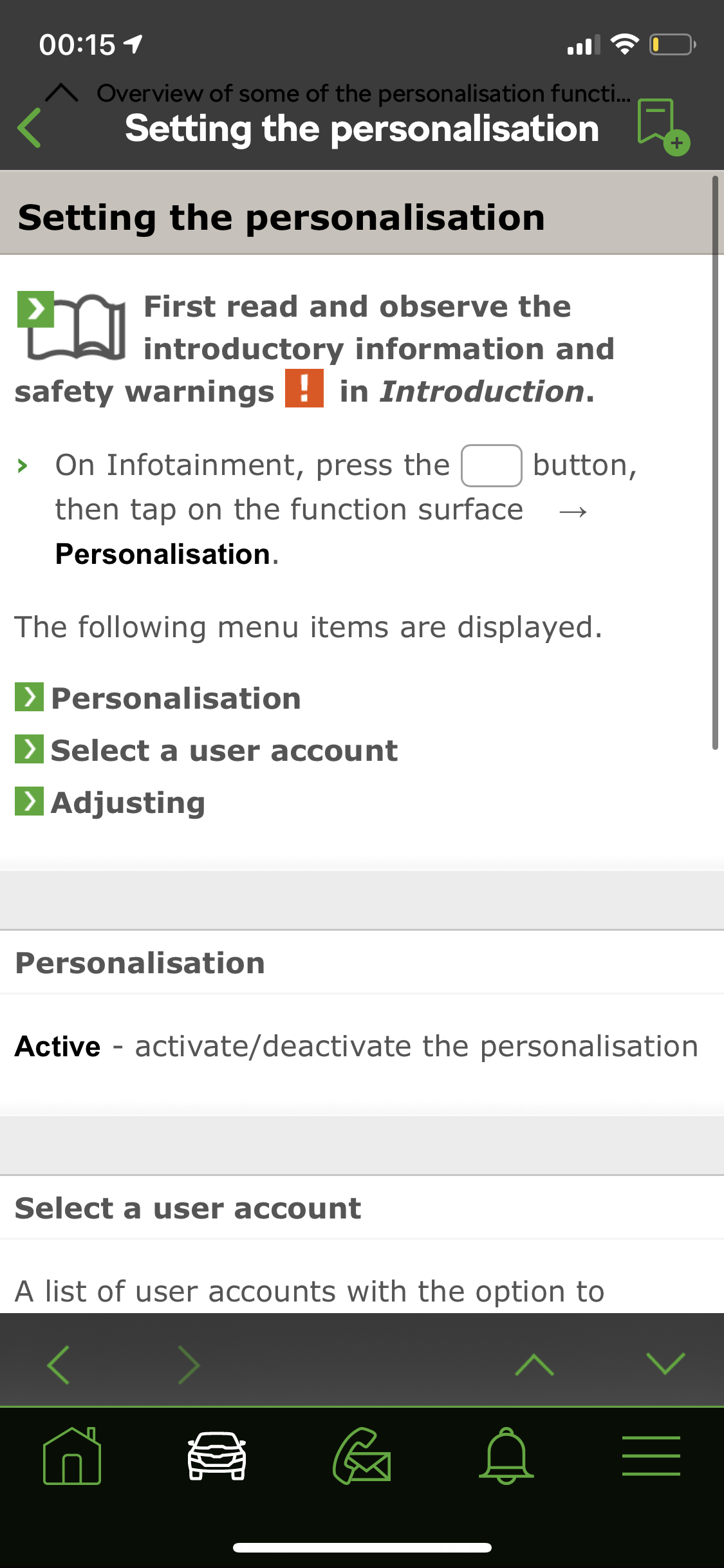

depends if your car has personalisation then each key can be tied to a profile which you can rename in the menus on the infotainment system settings.
have a look at personalisation in the manual or see the extracts below.
these are from the My Skoda app which is great when you want the manual to hand 😁

You will notice that the Goodbye name isn’t the same as the Personalisation name though.
Just for background, Mrs john999boy and I only use 1 key - but with 2 profiles. Each time that either of us leaves the car it only says Goodbye to me.
