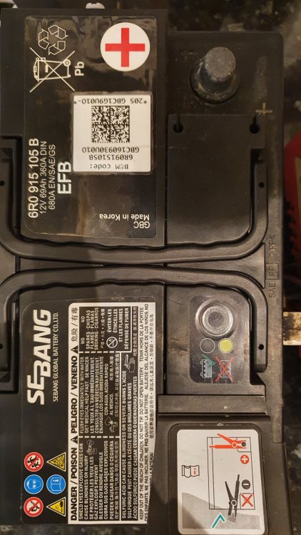

That's my current battery, EFB by the look of things, is AGM a newer technology?
Just about to put it on trickle charge overnight, old school charger, Amy precautions to take?

EFB is an enhanced flooded battery. Basically an improved version of a standard wet battery. It can take about three or four times the recharge cycles of a standard battery. AGM is advanced glass mat, a gel battery which is superior to EFB in all respects but it is more expensive.
