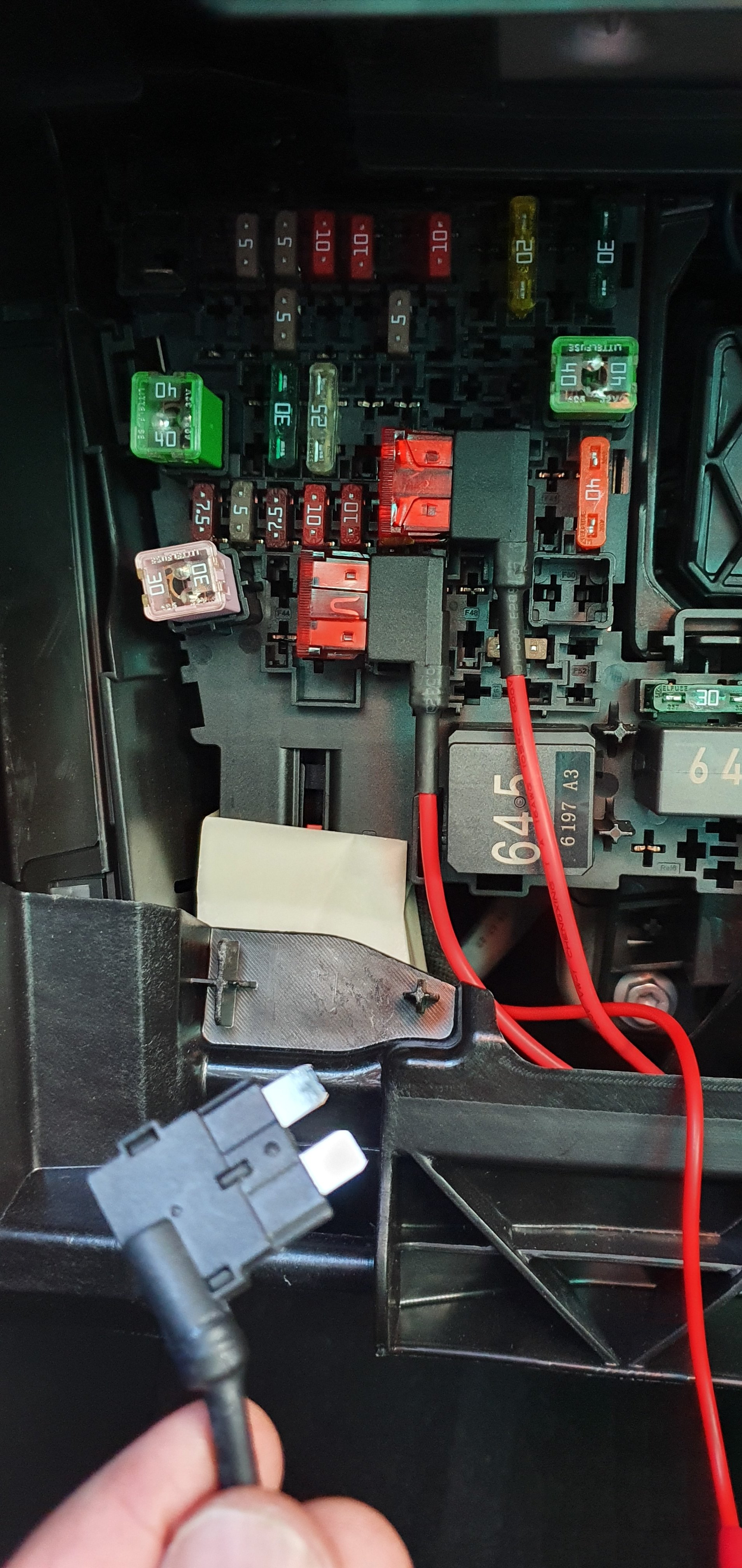

How many switched live connections behind glovebox
I've finally managed to wire up a kenwood underseat sub woofer but im now stumped at what fuse tap I can use for my dashcam which was originally in socket 47.
The subwoofer is now using fuse 47 rear window wiper and the fuse 40 12v socket.
Are there any other switched lives I can use for my dashcam?
Any help will me much appreciated 👍
Hi
I did mine yesterday and used the 7.5 amp at the other end of where you already have a jumper connection.
All of that row were switched live on my vrs 67 plate.
You may struggle as I see you have other relays I don’t. I expect you have heated screen or seats.
It was for parking sensors
I believe the 5amp next to it was air bag hazard light warning switch ,
Thanks for the reply, my dash cam has a normal blade fuse tap but I've got some mini blade fuses and mini blade fuse tap now so I'll have a look on that row you mentioned
