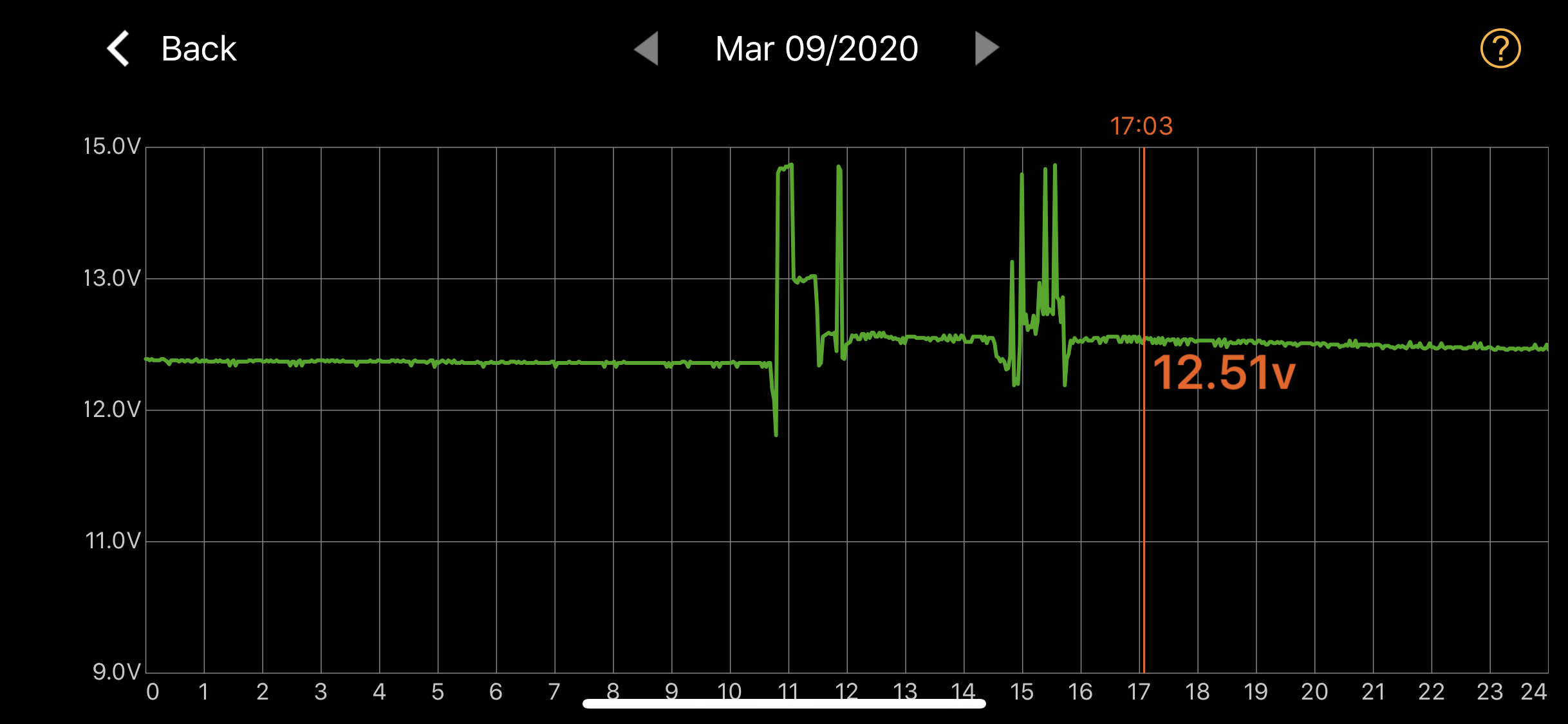

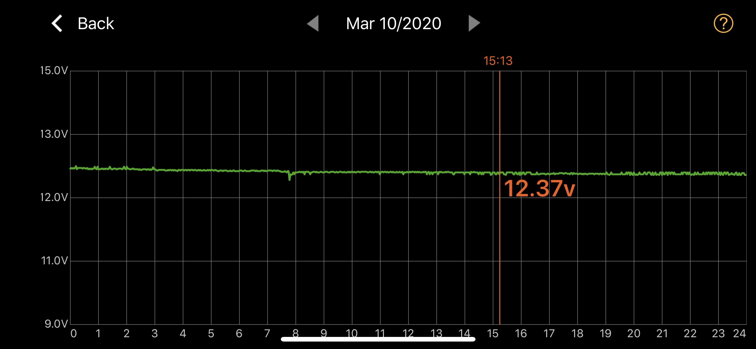

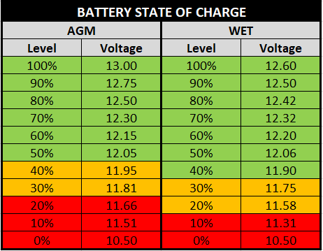

Thanks for your reply. I understand what you are saying. I am involved in electrics and battery technology in my day to day routines however, EFB batteries are new to me. I am not concerned about the voltage fluctuations when driving. My concern is that the battery at rest is showing <12.5 volts, often 12.2v, even after a long drive and my understanding is that EFB batteries are not meant to be left at below 12.5v. Is that correct? See the chart attached.If this is "normal" then I'm happy to accept and move on.IMG_3487.thumb.PNG.2b94d33c12965f73ba5b655b5a4e3edb.PNG
It varies with temperature and individual batteries but the chart below gives you an idea of SOC vs resting voltage. (EFB = WET)
Bear in mind the battery in your car is not open circuit but supplying between 7 and peaks of 50+mA in standby (my measurements)
Normal target SOC for the micro hybrid charging is 70 - 80% percent afaik
EFB has deeper cyclic capability without damage than older standard batteries. Often said to be 3x as many cycles though manufacturer's don't publish specific detail.
I have personally seen a Yuasa EFB taken completely flat (<1 volt) stood for over a year in a garaged Toyota Auris. I recharged it for 48 hours using a 5A Lab supply. It started the Toyota first touch and everything was fine from then on. I was stunned, and never expected that. But then thats a Toyota for you.

Yes, I'd think that's looks reasonably normal. Thr car is switching from energy saving mode during acceleration/normal driving with alternator not charging and using battery energy only, to energy recovery using the alternator on braking/overrun. The profile will change further if you turn on heavy electric consumers. The charging scheme will be SOC driven to control the alternator output and monitoring charge flow and SOC using the current sensor built into the negative battery terminal connector.
One final comment, after you turn off the car, the battery voltage can appear depressed for quite a while because
a) It takes several minutes or more for all electronic modules to switch into standby
b) the battery will be warm even hot due to the charge pumping and engine bay.
So measure the resting voltage after the car is stood a couple of hours and totally cold.
Edited by xman

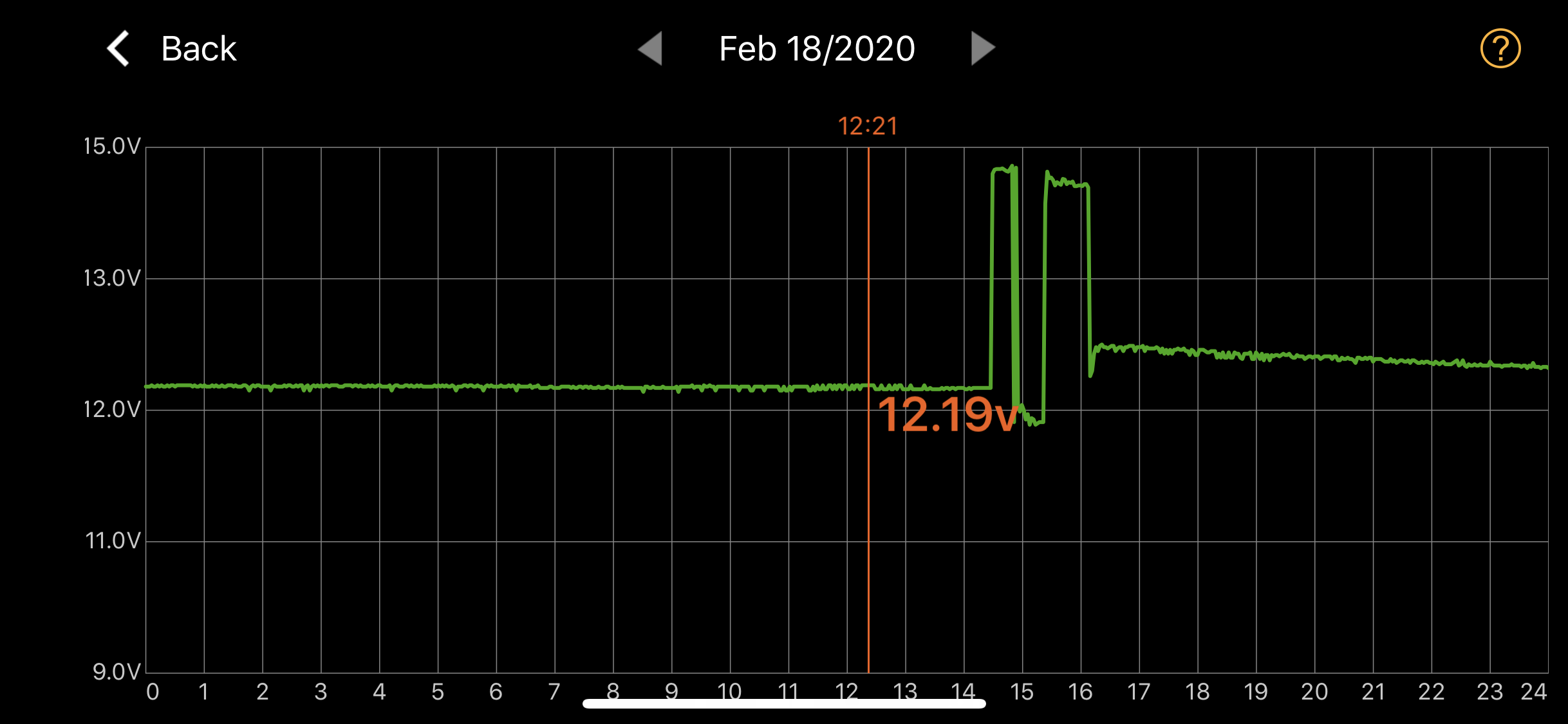

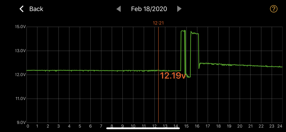

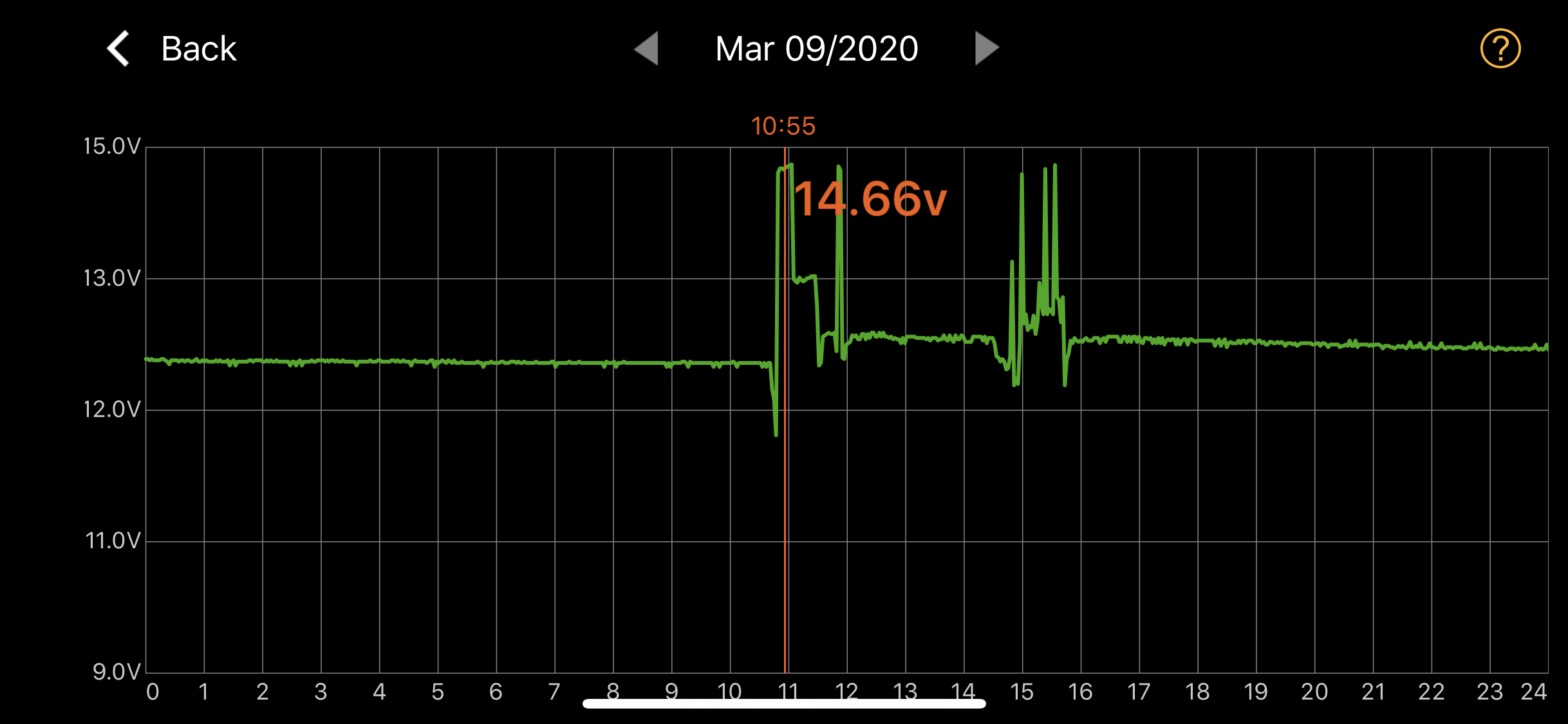

Yes a bit disappointing to see the normal voltage level then the "charge cramming" on the over run/braking - seeing is believing!
I think that these EFBs would last longer if they were helped along with an overnight charge now and again, if you look for the battery stats in the CAN-Gateway they do tend to point to early grave for some of these EFBs, maybe worth swopping for an AGM when it is battery changing time.
Edit:- it would be good to see the active curser moved onto one of the higher charging points.
Edited by rum4mo
Here are a couple of other screenshots -
I thought the peaks might have been even higher than that, it is a long time since I checked using a DVM but I'd believe a 'scope measured value for that shape of waveform over a DVM.
