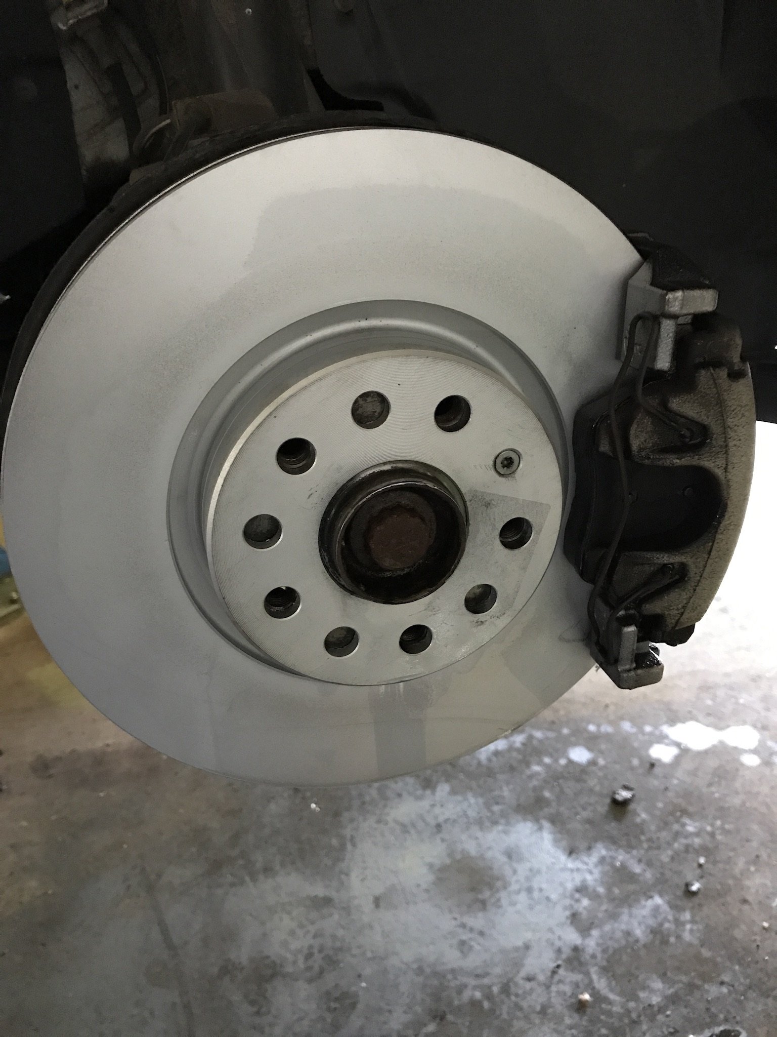

The real fun starts when there is no screw in the brake disc, then you end up trying to line up 3 sets of holes instead 2

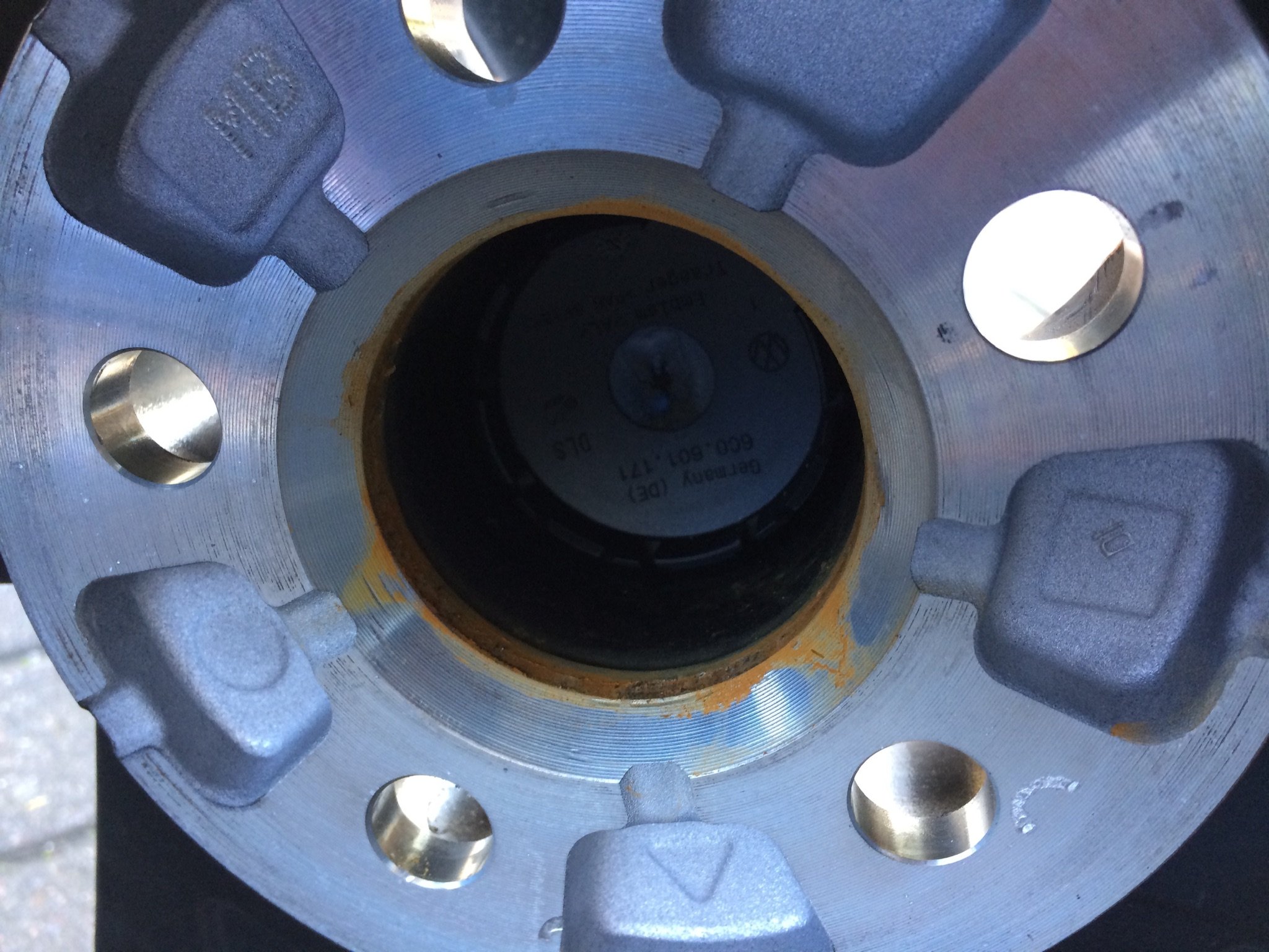

Once the wheel is lifted up onto the hub, it rests quite nicely...
Placing your foot on the base of the tyre, close to the ground stops the wheel from dropping off the hub, and if you've applied a very thin layer of copper slip on the face of the hub it is very easy to spin the wheel around on the hub a few inches until the holes line up...

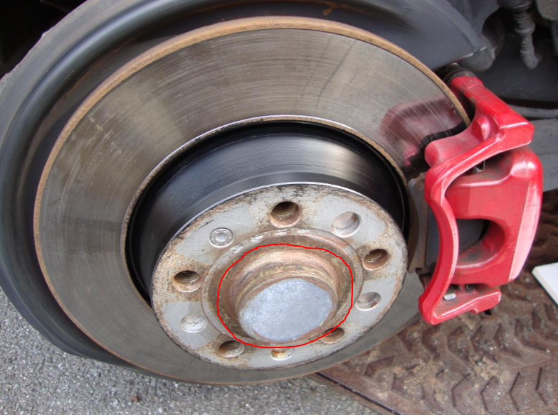

I certainly haven’t been able to get the wheel to sit on the hub on my previous Yeti or the Kodiaq as the lip to sit on is much smaller than the one in your picture. Hence the reason I bought the alignment tool.

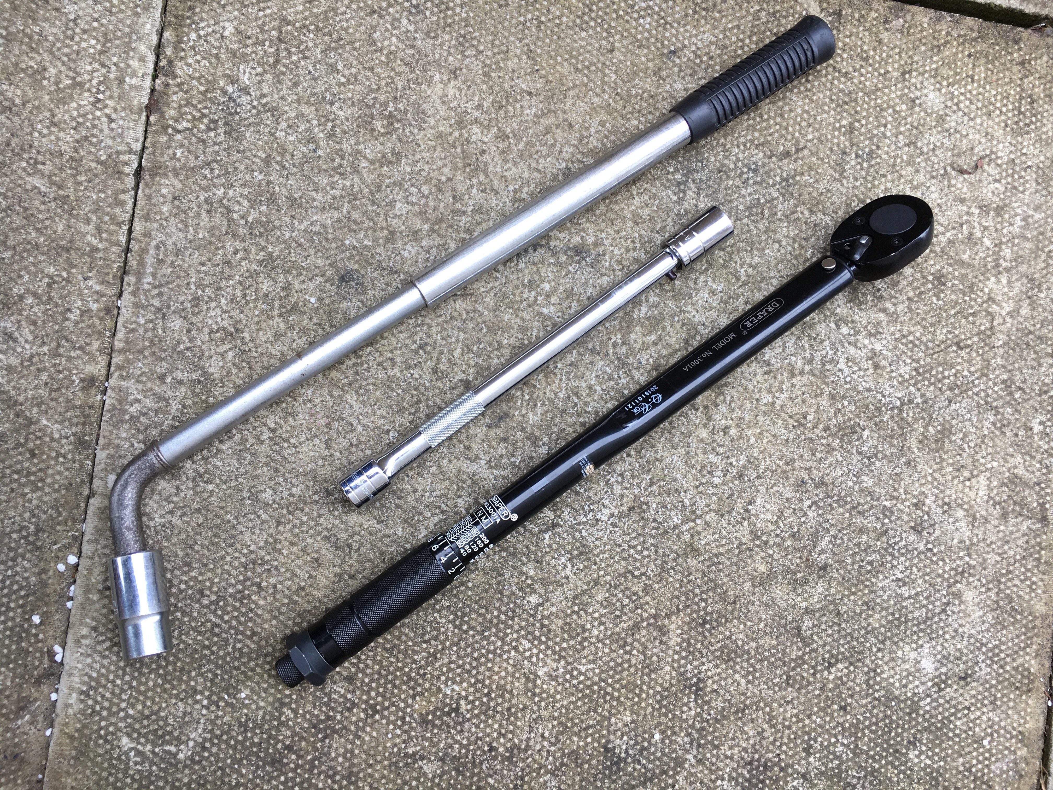

At home, it’s trolley jack, impact gun, telescopic wrench (for removing), torque wrench ( for fitting). I never use the piece of bent tin masquerading as a VAG wheel wrench.
Currently swapping summer / winter wheels over on 2 cars twice a year, so plenty practice.

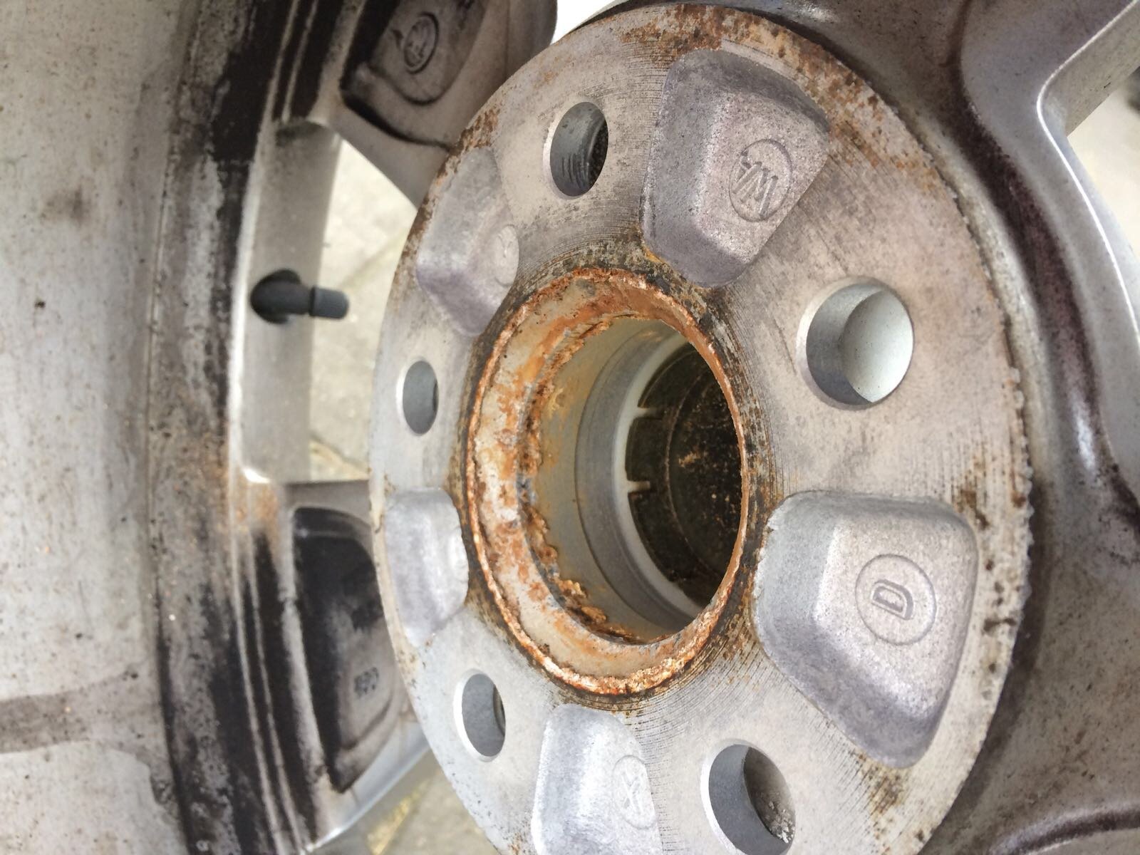

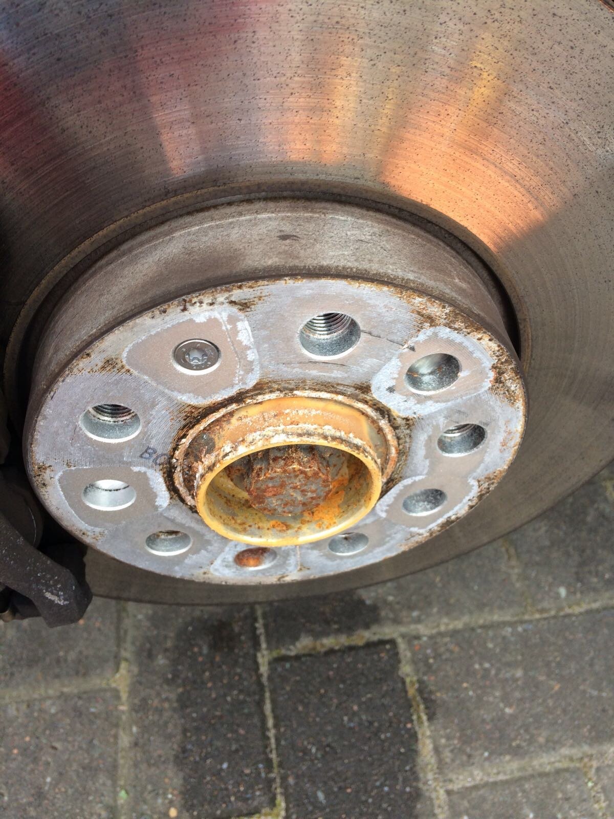

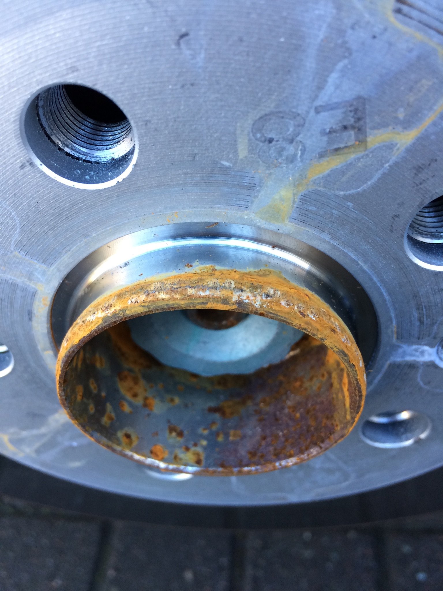

ps - did you grease the mating faces?  Alloy wheels stick fiercely to steel hubs after a while. Go try removing one after a year or two. The rusty hub was our 600 mile Polo.
The Hub and Alloys and dissimilar metals and no barrier smear of grease from the factory and wheels maybe never removed from the cars even if serviced annually at main dealers has been an issue for decades and generation after generation of models of car.
