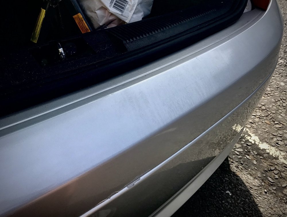

The orange pad is what I used to sort the defect shown on the rear bumper I pictured a moment ago 👍 (tried loads of different brands of pads and the lake country pads  are my personal preference)
Not sure if you’re aware or not, but difference pads (usually indicated by different colours) have different cutting abilities. Orange for lake country is light cut, whereas the yellow, for example, is for heavy cut.
Edit - same goes for polish. Some will give light cut, some heavy. Depends on what you’re trying to achieve.
An all on one like you’ve posted may be enough, but then again, you may find that it doesn’t have enough bite.

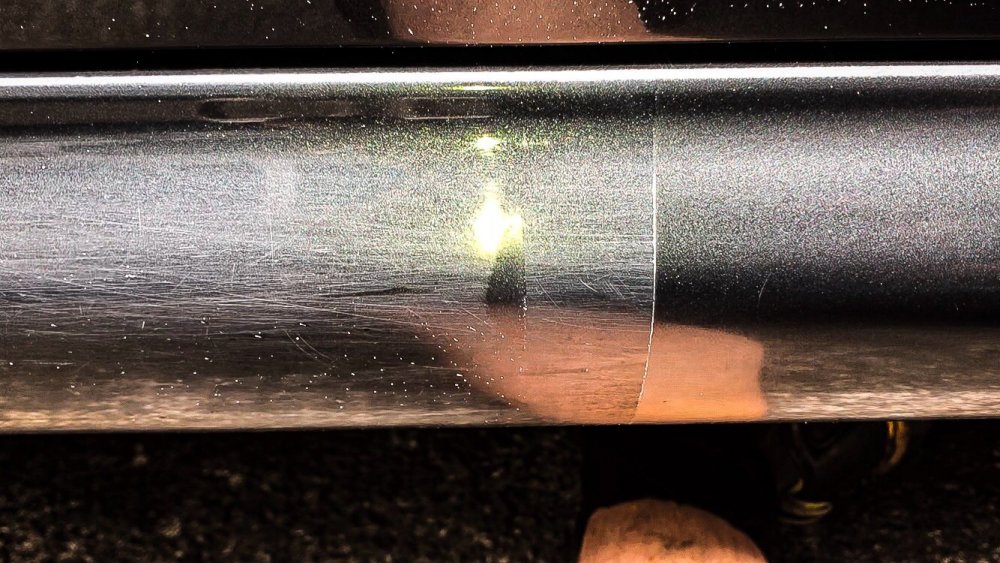

    Depending how deep the scratch is you may not need to go down the chipex route.    I corrected this scratch yesterday with a DA polished, medium cut pad and meguiars #105

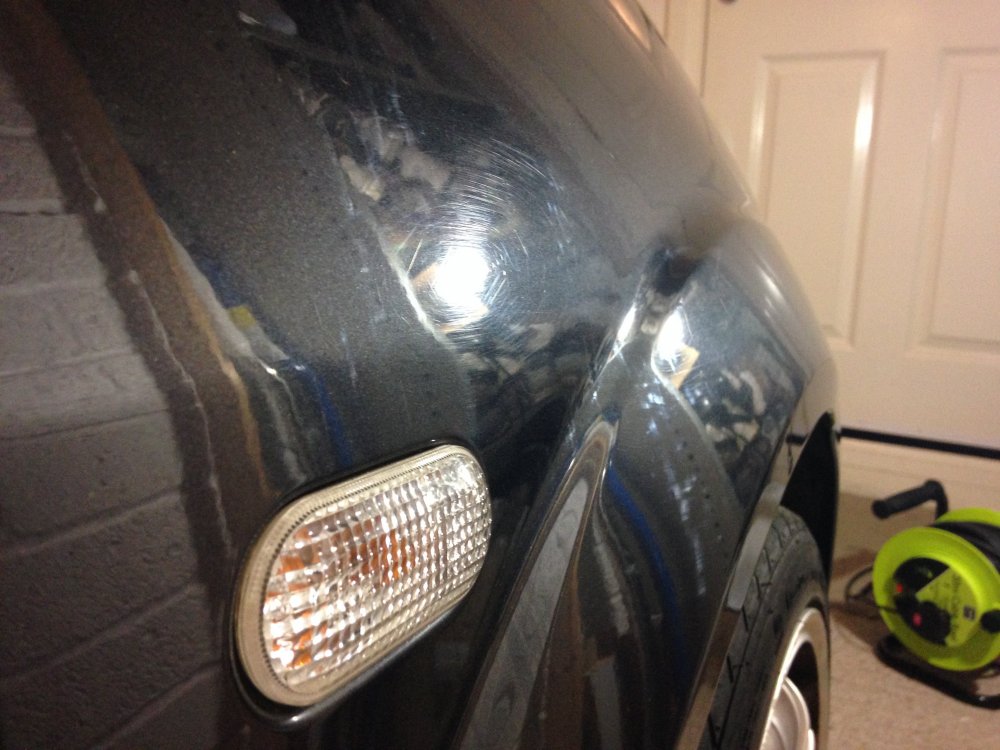

Will it do the job of removing the “swirls” in your original pics, yes it will.

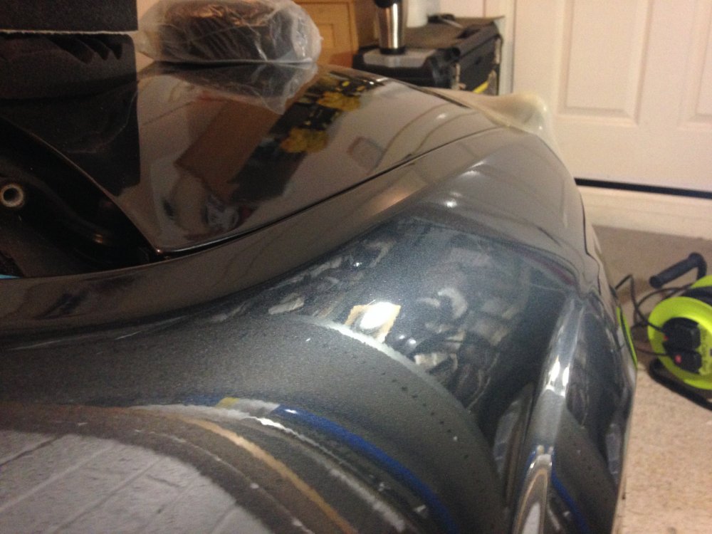

However, I’ve not used that particular compound before so can’t say for sure if it’ll remove the defect in the latest pic you posted. (Pictures can be deceiving!)
