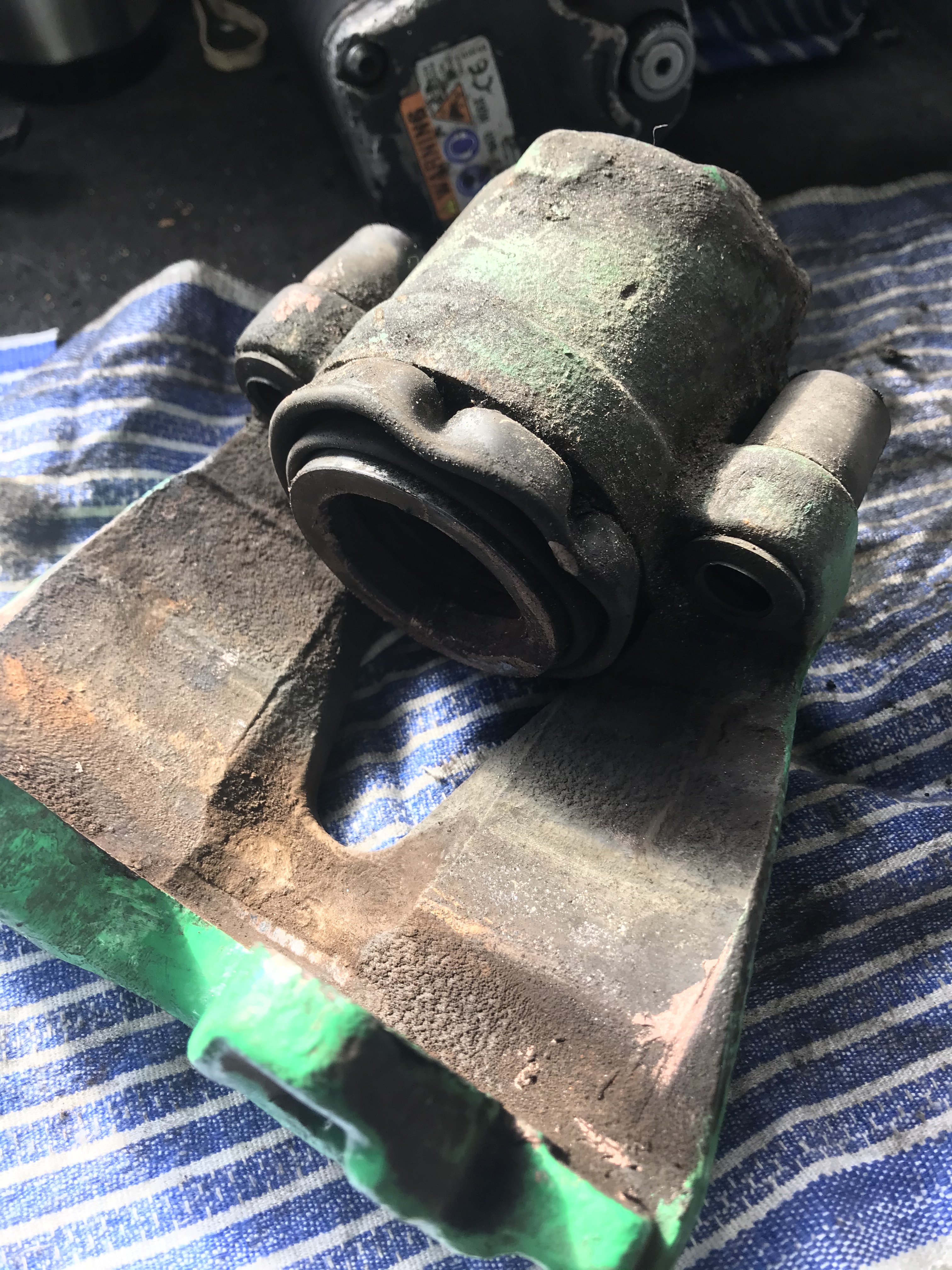

Worst case scenario is you’ll end up with deals like shown .... If this is not fixed then the calliper piston will rust, resulting in seizure as water will be able to get by the seal. This may take a while to happen, but eventually it will happen.
This was my calliper, which I’ve since replace all rubber seals.
Ah wow how did your rubber end up like that?   When I sprayed the calliper it was still on with pads in place, I thought u could use it to clean the calliper
By using copious amounts of brake cleaner, like you did!
You can use it to clean the calliper, but you have to be carful with the rubbers. If you wipe it straight off it’ll be alright, but letting it dwell on the rubber will feck it up, as we’ve both found!

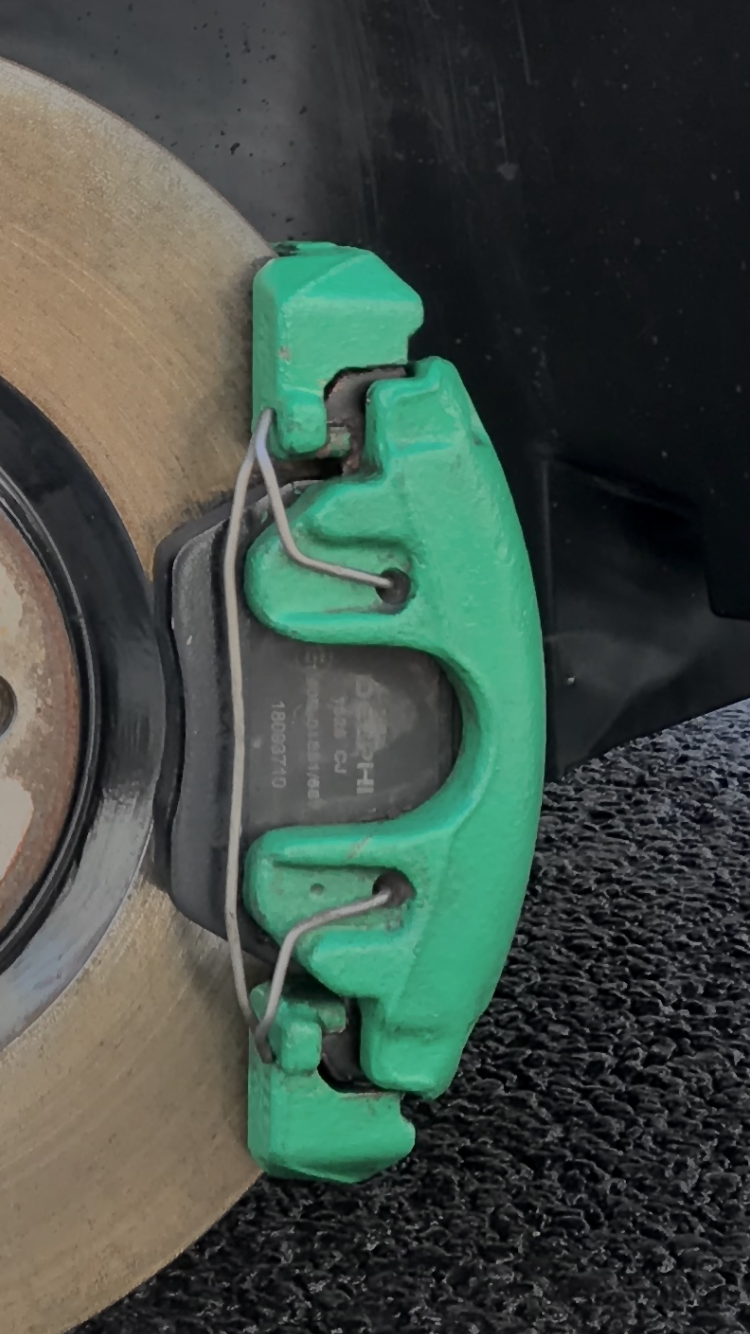

Is that some special sort of caliper? It does not appear to have the lugs to locate the opposing brake pad & hence nothing to clamp against.
what have I missed?
Or is it one half of a disassembled twin opposing piston caliper?
Edited by J.R.
Not a special calliper, it’s off a MK1 Octavia vRS?!?
The front pad rest against the carrier, which I didn’t need to remove it in order to strip and rebuild the calliper. A34C82F2-9A2B-4C2B-886B-B1EE32D888A7.thumb.png.bf6faa82956756ef7144d40986608b4d.png

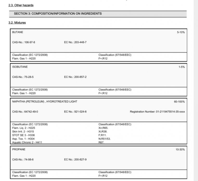

I would check the Safety sheet ... it should tell you the ingredients/compounds used ... my guess is its likely to be butane, isobutane and petrol , none of which are likely to be great for rubber in large quantities.
Did you let it flash off or did you wash it off after application?
I didn’t wash off I thought I needed to clean brakes so i used brake cleaner I thought it was the done thing, this what happens when I think I’m doing something right it ends up wrong

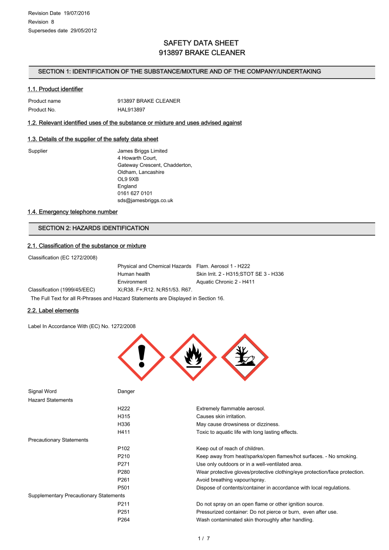

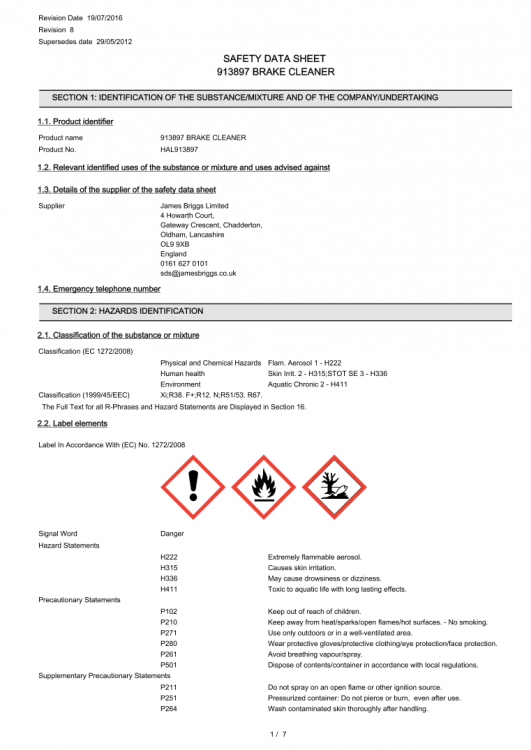

This is what I could find
Nailed it!
None of the rubbers and seals look swollen or anything,
Now that you have already sprayed everything you have got 2 options. replace everything just in case, or carry on as if it never happened and deal with any premature deterioration further down the line if it causes any issues, I wouldn't lose any sleep over it, it will be fine.
