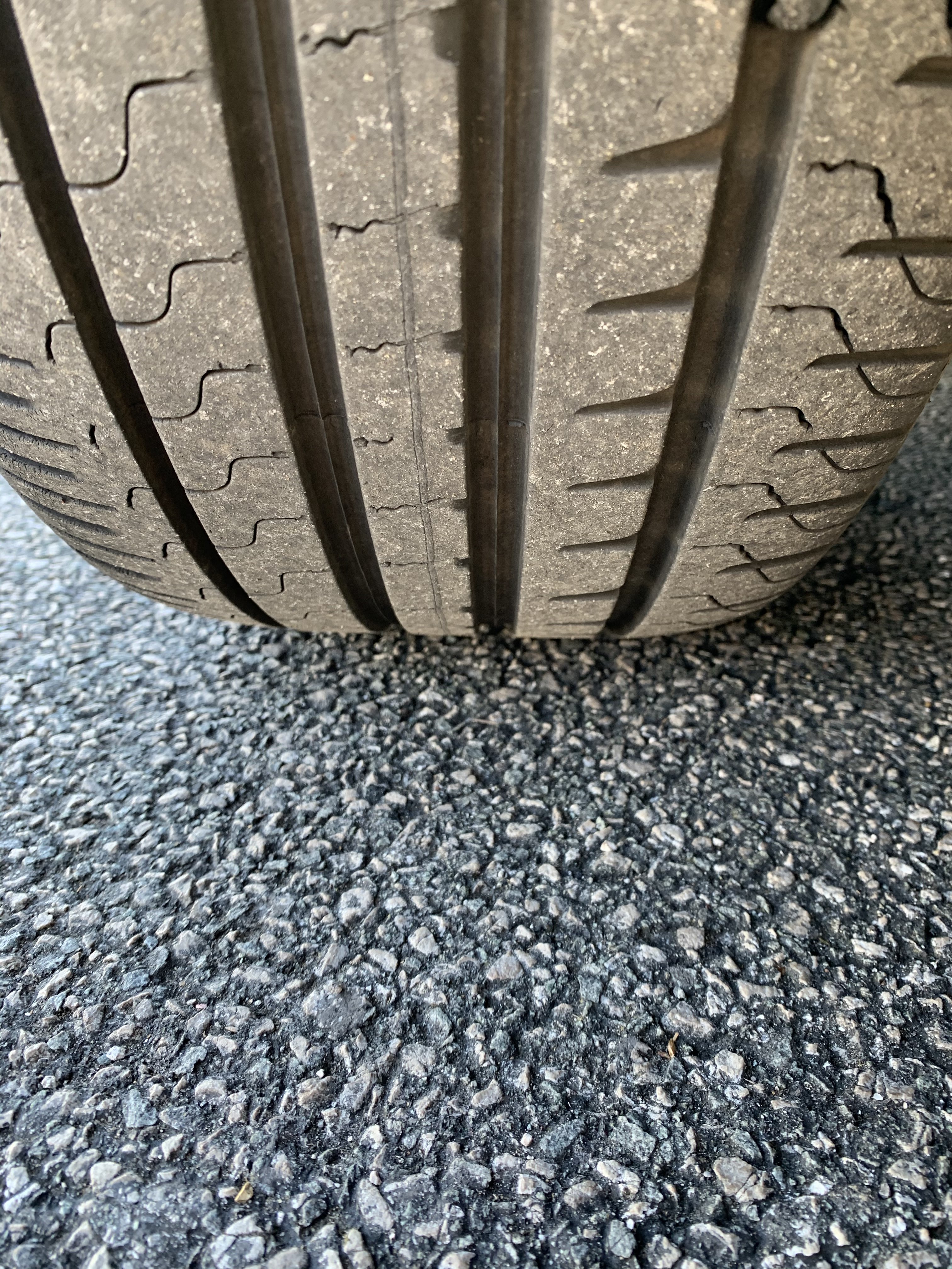

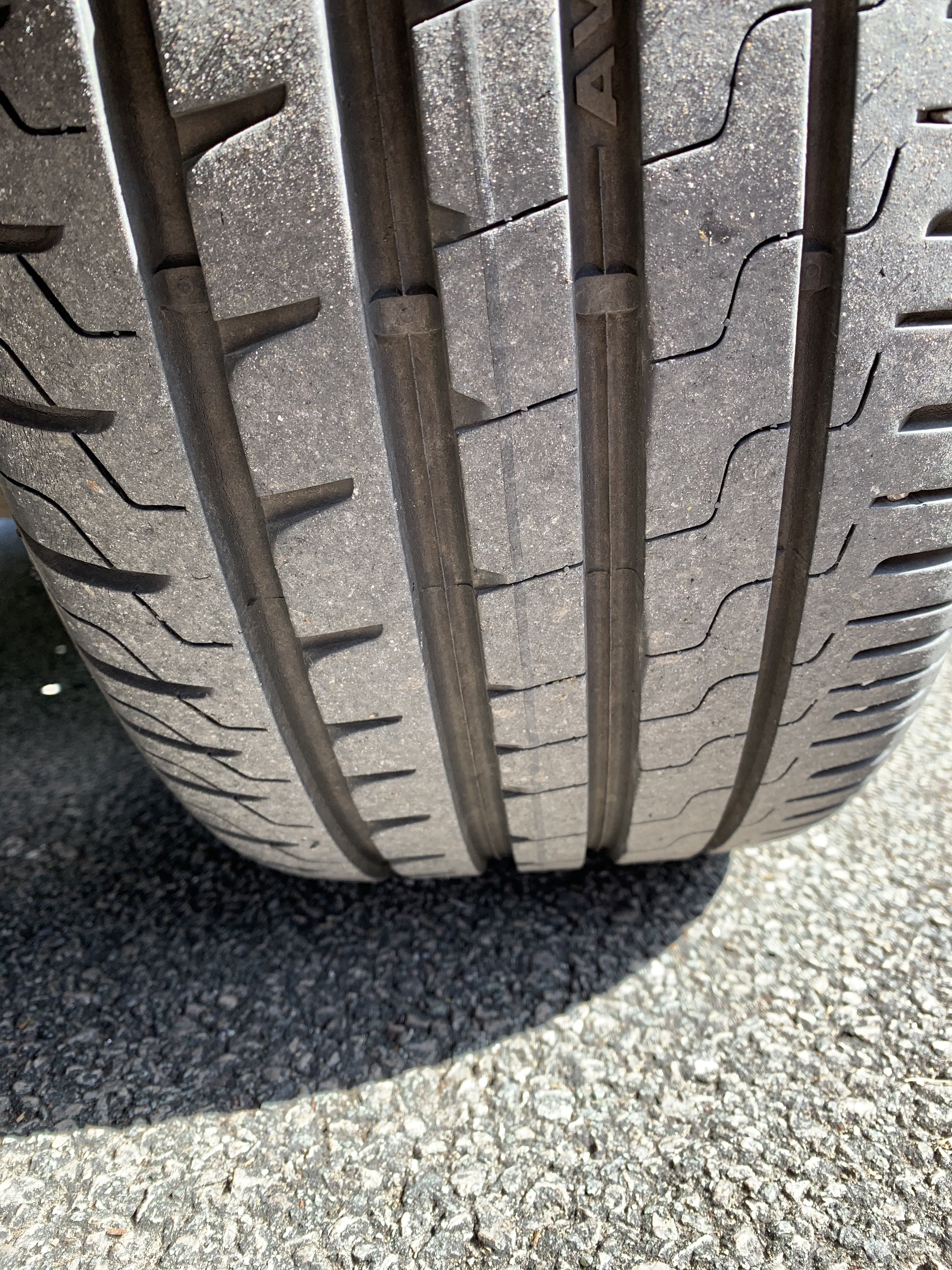

3 hours ago, Brooksy2020 said:
Here are a pic of the condition of the back tyres on inspection I found a puncture repair don’t know if they could be the cultprate?
There look fine, mechanic needed, are you a essential worker ?
