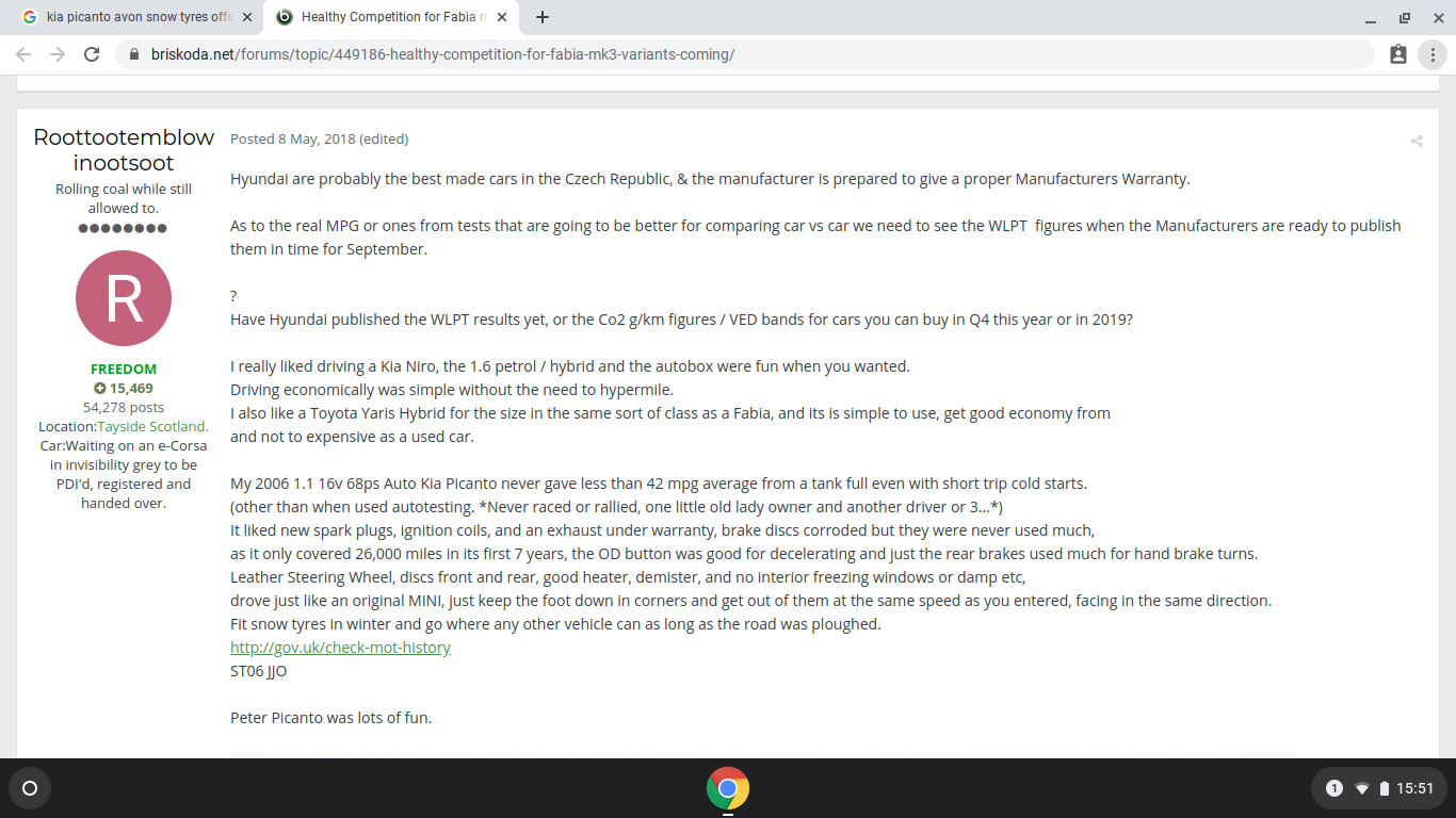

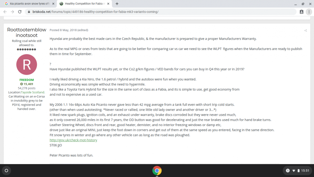

A 2006 1.1 68ps 4 speed auto Kia Picanto i had would go around corners at 70 mph with just as many revs as needed with the O/D button in or out and still get 42 mpg no matter if driven as though it was not mine. It was not, it was one lady owners, never raced or rallied, just used at Autotests.
