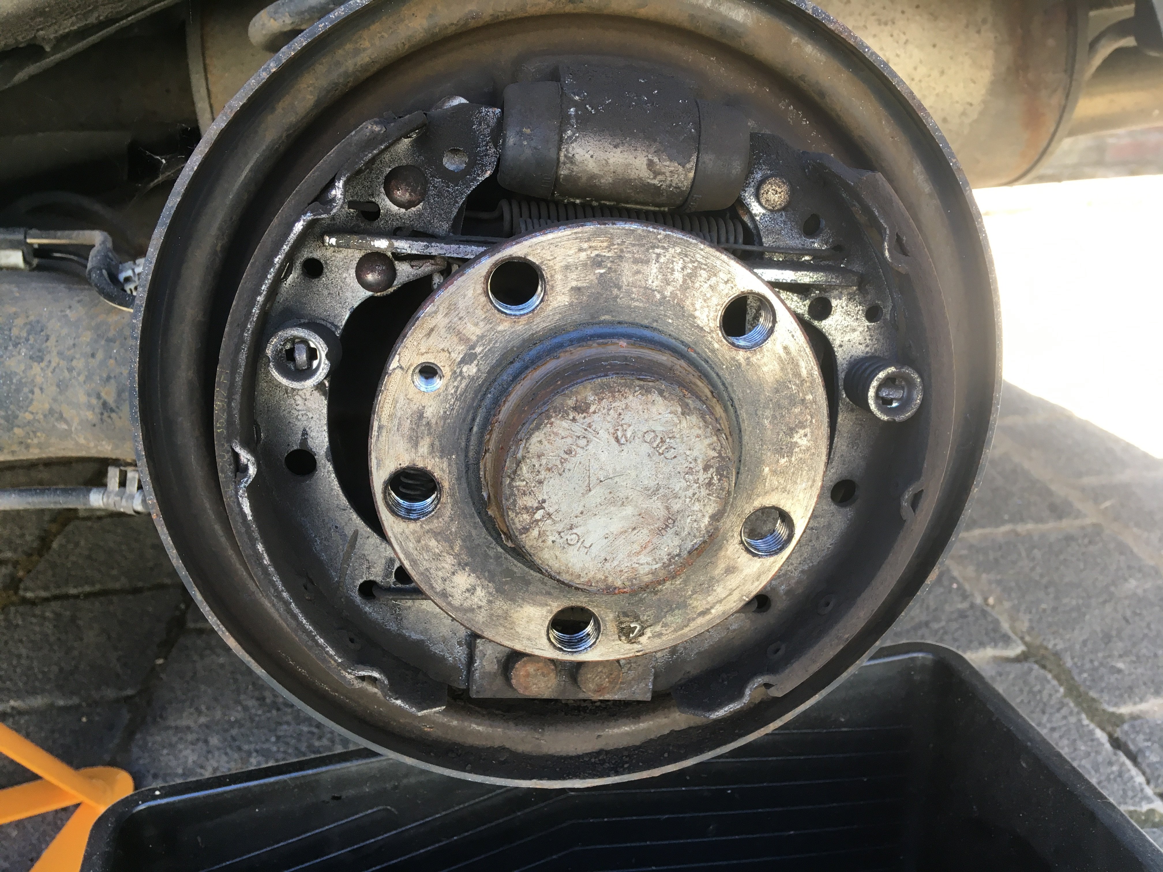

wheel came off easily, used a screwdriver to slacken off the brake shoe tension and then... well, the drum was solid on still.  Had to welly it with a hammer onto a block of wood to get it to shift.  I was fearing the worst, but this is what it looked like before I cleaned it up inside.  Quite a bit left on the shoes I thought?  I was expecting them to be down to the backing plate.
Gave it a good clean inside, loads of dust and crap came out.  Gave the inside edges a wire brush and clean and also gave the drum a thorough clean, then wire brush and rust treated the outside of the drum and then gave it a new coat of calliper paint.  Plenty of copper grease during reassembly.  I hope that adjuster pin settles, i guess it will take a few presses of the brakes.

Did you try moving the handbrake inside the car a little while everything was visible, to check that the pivot in the mechanism at the drum isn't seized?
This shows itself usually by poor handbrake efficiency and a very 'off-straight' spreader bar inside the car where one cable becomes two, just aft of the handbrake lever.
The pivot is the 'rivetty-looking' thing just to the right of the wheel cylinder in your photo.
Inside edges of what?
I did think about operating the handbrake because I wondered if the pivot assembly would have seized, but I was half worried the brake shoe assembly would somehow fold in on itself and spit all the springs out onto my driveway.  I did move the adjuster pin about and brushed a teeny bit of copper grease on it.  As it happens, I think the handbrake has always been a bit "graunchy" like when your mountain bike cables get all gunky and you need to give the inner cable a clean and some rocknroll cable magic lube on it.  I will have a look again tomorrow, it's easy enough to whisk it off now.  Last time I adjusted the handbrake it was reasonably central and it's still on 4 notches to put the handbrake on.  I hate removing that armrest though if I have to adjust it again.
I cleaned all of the backing plate etc with brake cleaner and a rag.  And then the inside of the drum it has the braking surface which I just wiped with brake cleaner and the rest of the iron parts (non braking surface) i gently brushed clean and then wiped.

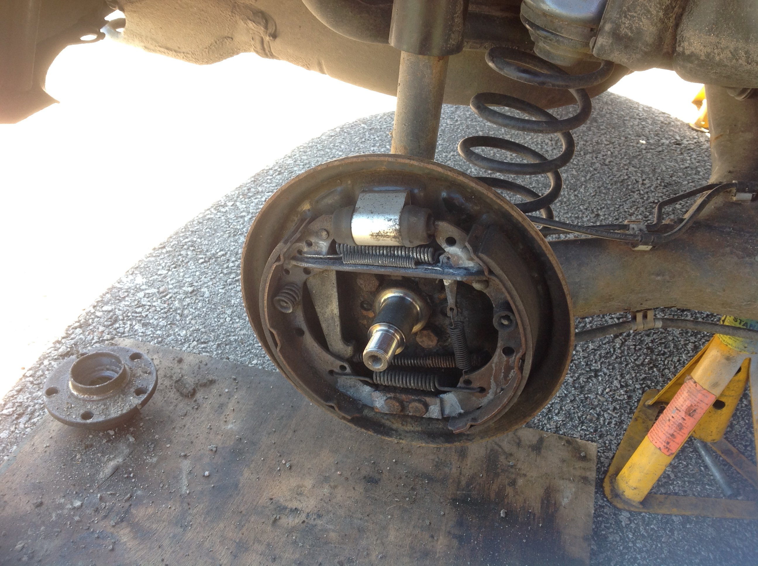

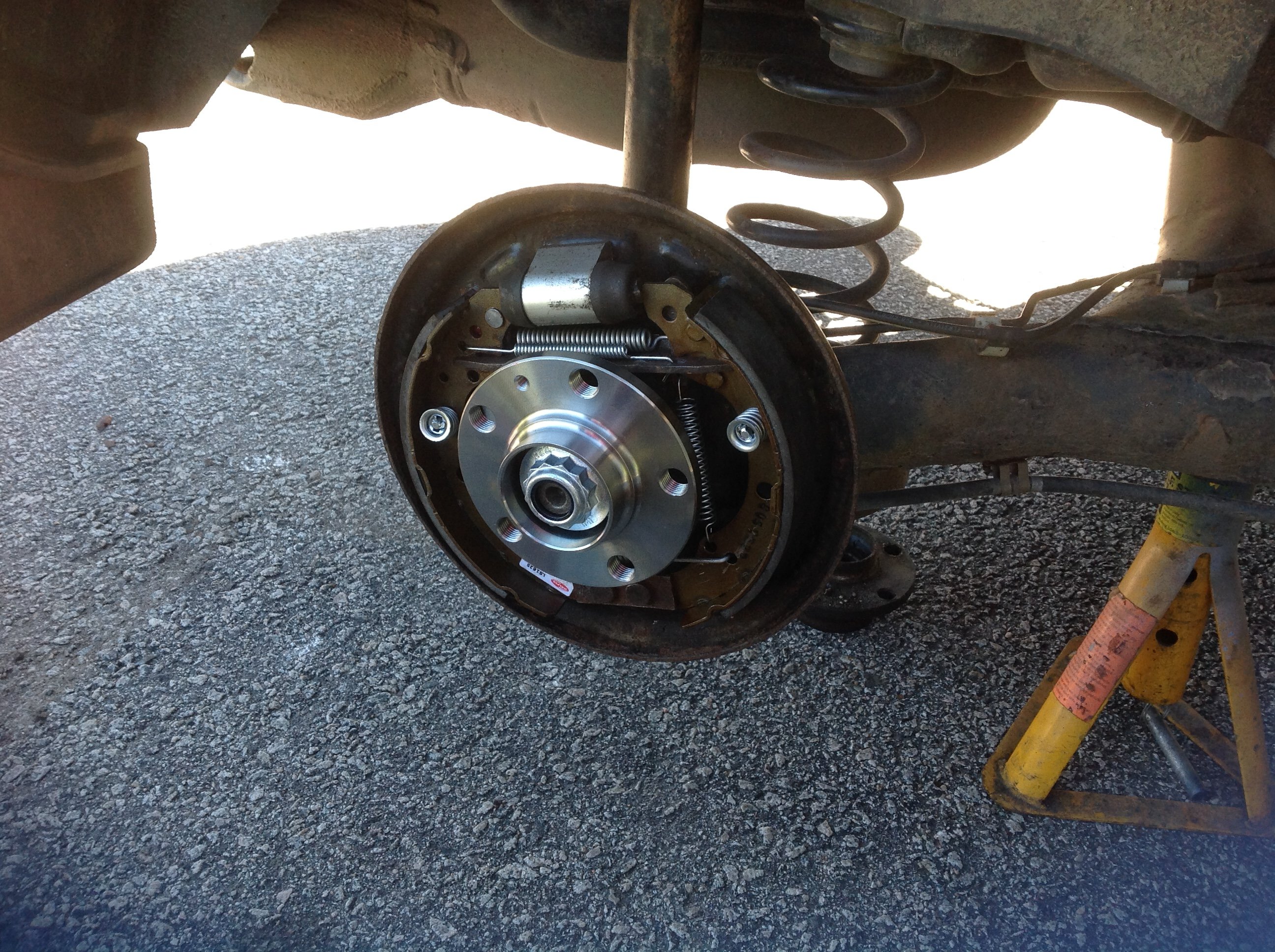

Good job. Doesn't look too bad, I've definitely seen worse. This was my 2010 Fabia back in 2018 before fitting a new bearing, Delphi shoes, and a spring kit. With the handbrake cover off look at the tensioning yolk. On mine it was pulling to one side and regardless of adjustment I couldn't get it to bakance so ended up having to replace the handbrake cables.
You need to jack the car both sides at the rear to test. On a couple of clicks it should engage. With the wheel on, if you can rotate on either side too easily, then you can go back and adjust the wedge on the brake adjuster. The drum should go over the shoe assembly easily with the handbrake released and the 10mm nut undone. My drums were at 100k mikes so basically worn and really needed replaced, but I had Issues with flexible-pipe at the catalytic converter and bailed out and sold it. Typical!
