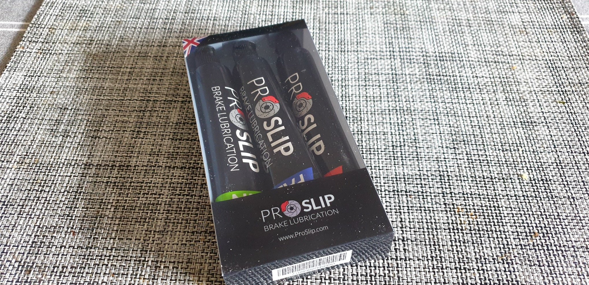

if you're attempting, then get yourself a shoe and spring kit. This kit is perfect for grease, etc. If mileage is around 100k and you're hanging onto the car, consider changing the cables. They stretch over time and no amount of adjustment will work. The temptation is just to keep tightening the 10mm nut at the central yolk at the handbrake.
