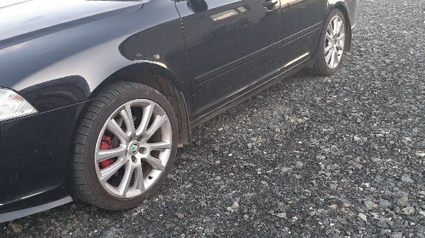

Also, was just wondering as I seen it done on Mk3 vRS's, is there a mod that can be done on the factory Airbox to create forced induction? I've a K&n panel filter in at the minute.
And do you reckon 30mm Eibachs would have much difference on this? The fronts had new bilstein B4 shocks.
Edited by JacksVRS
11 minutes ago, JacksVRS said:
imageproxy.php?img=&key=00da0a65627968c1And do you reckon 30mm Eibachs would have much difference on this? The fronts had new bilstein B4 shocks.
