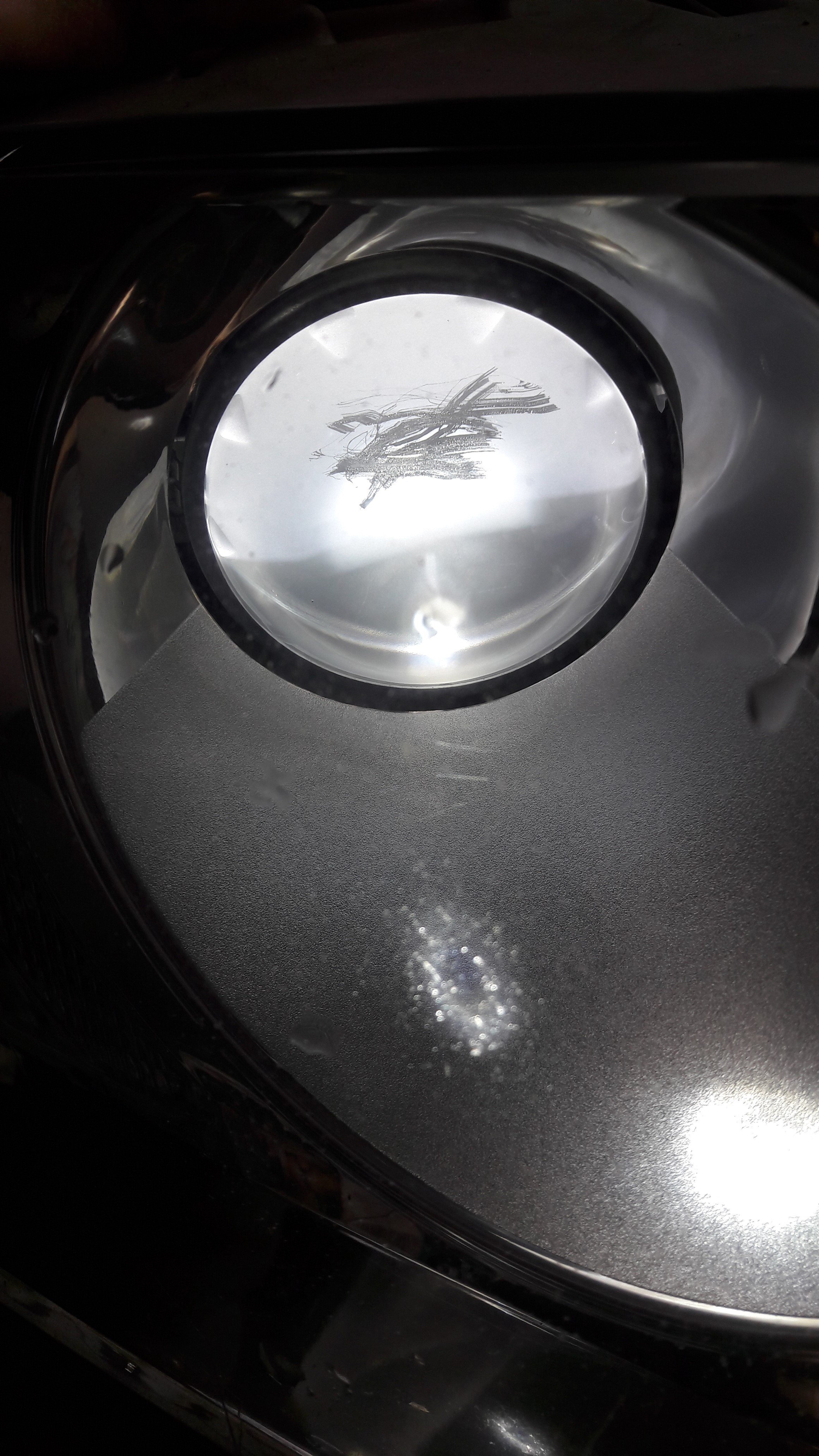

This is the amount of muck on the inside of my lens prior to cleaning. With a torch shone through it to show the muck.

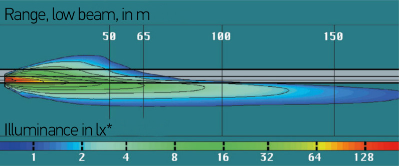

Take a look at this light distribution image of a typical projector from Hella. It's taken from above the road, with the car on the left and the lights pointing towards the right. It's also for a LHD beam pattern but that's not massively important. The road is the three darker horizontal lines :)
The brightest section is 0-20m which isn't surprising. LED kits might make this brighter.
As you get further from the car, the brightness drops off but there is still plenty of useful light out to 50-65m. This is where you'll have issues with LED kits:
- firstly, due to the lack of focus reducing the throw
- secondly, the excess foreground light can cause your pupil to contract
That second point is important as it'll reduce the amount of light coming into your eye making the dimmer, distant objects even harder see.
These probably aren't massive issues when you're driving around on lit town roads at 25-30mph but if you're using unlit 60-70mph roads it can be.
