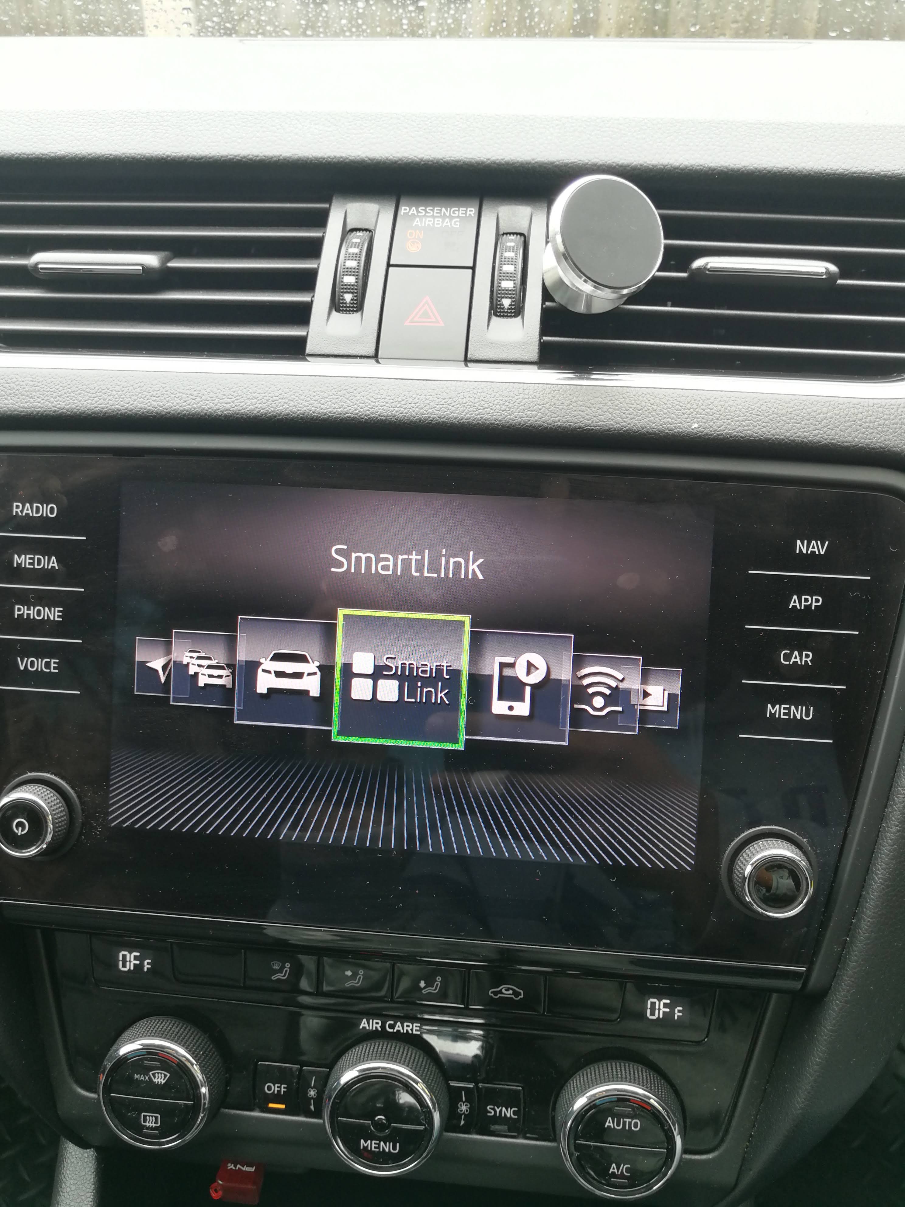

I don't know what ICE system I got, but i tried to play mp4 video from the USB and Memory card in my ICE, but it wasn't successful. I tried to play youtube via SmartLink,but couldn't find a way to do it. Could someone help me if there is any way to play video/youtube  in my ICE. My daughter keeps asking me about video playing in the car.

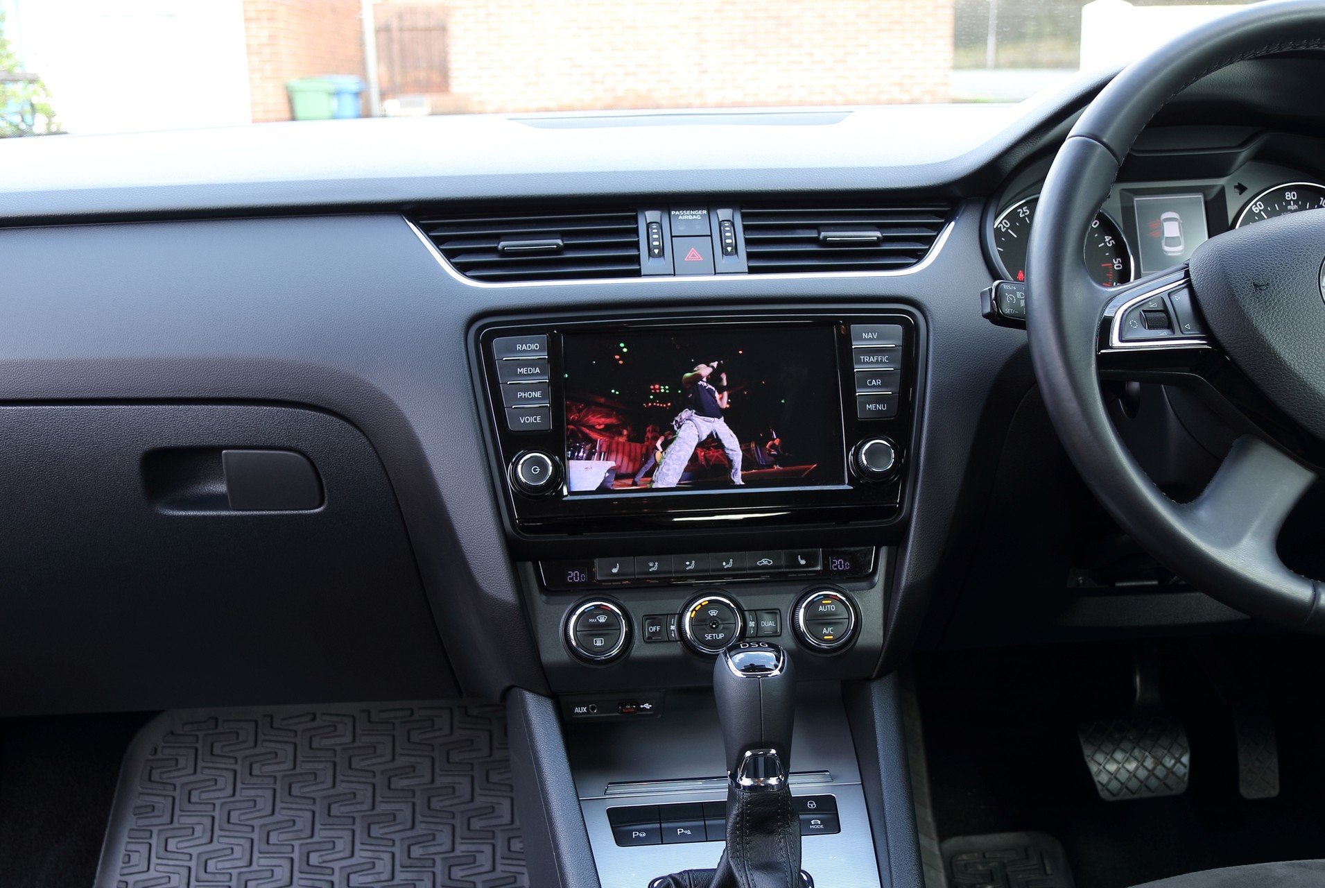

Columbus plays video if you are parked - otherwise a cheap tablet is your best option. See also my posts 6; 15 and 17 here.
That looks like an Amundsen to me so the answer is no.
Edited by YMe
As YMe says you need Columbus for video unfortunately, Looks like you have a facelift Amundsen.
Really! How strange!!! Yea, i think mine is Amundsen. Can i buy columbus and replace the ICE or there are lot of things involve to replace?
