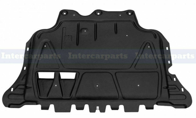

Surely the plastic sump is hidden by the plastic engine guard?
You'd have to hit something pretty high and hard to pierce the engine guard and then penetrate the sump?
Edited by silver1011
Or does it look like this?
More Skoda weight and cost savings 😐
It seems the petrol models have always had smaller engine undertrays, so maybe not a recent change afterall...
 That would be it. Weird design choice imho, cost saving or not it just seems dumb.

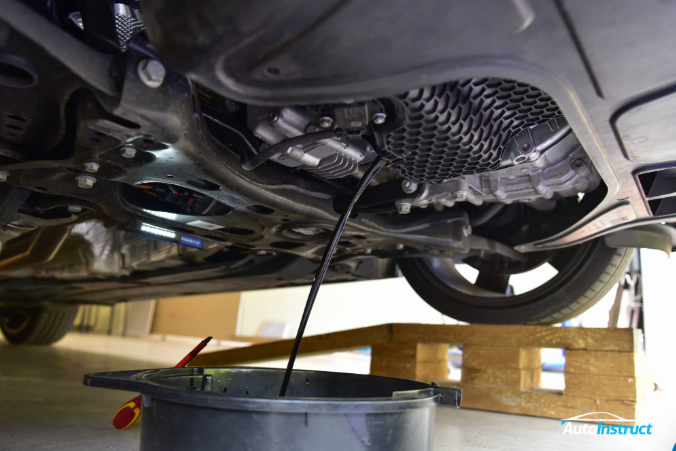

I thought about the metal sump when I did my oil change and discovered the plastic sump.
Then I started to question it..
Although instinct tells you the plastic is worse, is it?
It's thicker and has a honeycomb type structure on the outer side so I would say you'll probably find that pretty tough.    Plastic is also better at elastic deformation so it'll return to normal if it does form.
I mean, go get decent plastic storage box and hit it with a mallet.  You'll struggle to deform it.  Now go do the same to a metal biscuit tin...
Not completely representative bit you get the idea.
Also, I looked at the metal sump on my Honda and realised that in 13 years there's no so much as a scrape, so in reality, what's the risk and is there any point changing it?  Probably not.
Valid points here. I think even the plastic ones have metal lining but structurally its mostly plastic that keeps everything together. You are correct on the elastic deformation part, but i think metal pan would endure plastic deformation much better (unrecoverable deformation). My old car had a serious ding on the oil pan, its hard to say if a plastic one would be able to take it without cracking.
Yep, depends how hard a knock it gets.
A small knock i think would be fine and you'd get a scuff rather than a dent.
A big smack and you're more likely to crack it than cave it in.
So it then depends on how likely those are.
Obviously steel doesn't age and go brittle like plastic does also.
