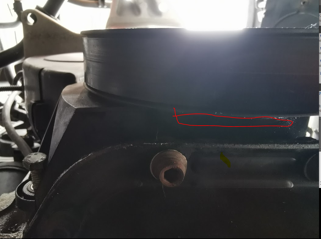

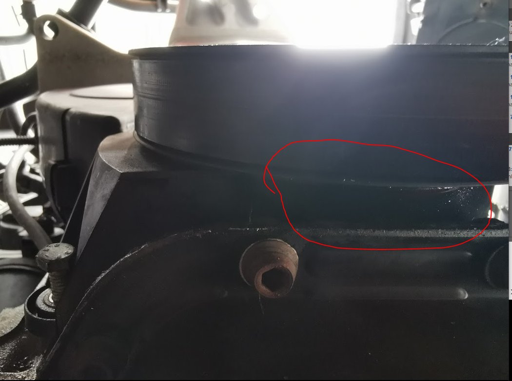

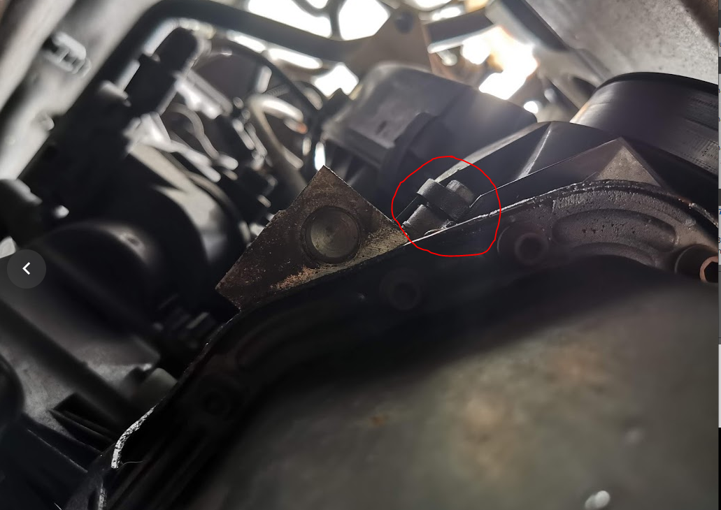

I didn't quite buy that, so went under to have a look:
This is the exact point it drips down from, and over the engine oilpan

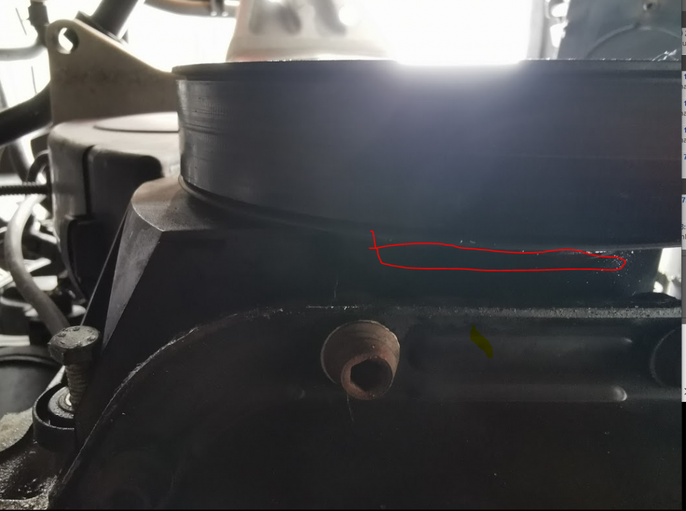

There is some red "caking" by the belt here :
In the last pick ive loosened the M10 bolt, which i suspect has noting to do with the leak 😞
Any good suggestions or is the "youngish" pump already borked?
Edited by ToreV
Better pinpointing of the red "caking"
err. that garage obviously could not have looked much and just wanted to sell me a new car. The leakage is no where near the pump. And it looks like its coming from above on the backside of the engine somewhere above inside the plastic cover. Can anyone please advice what my next step should be?

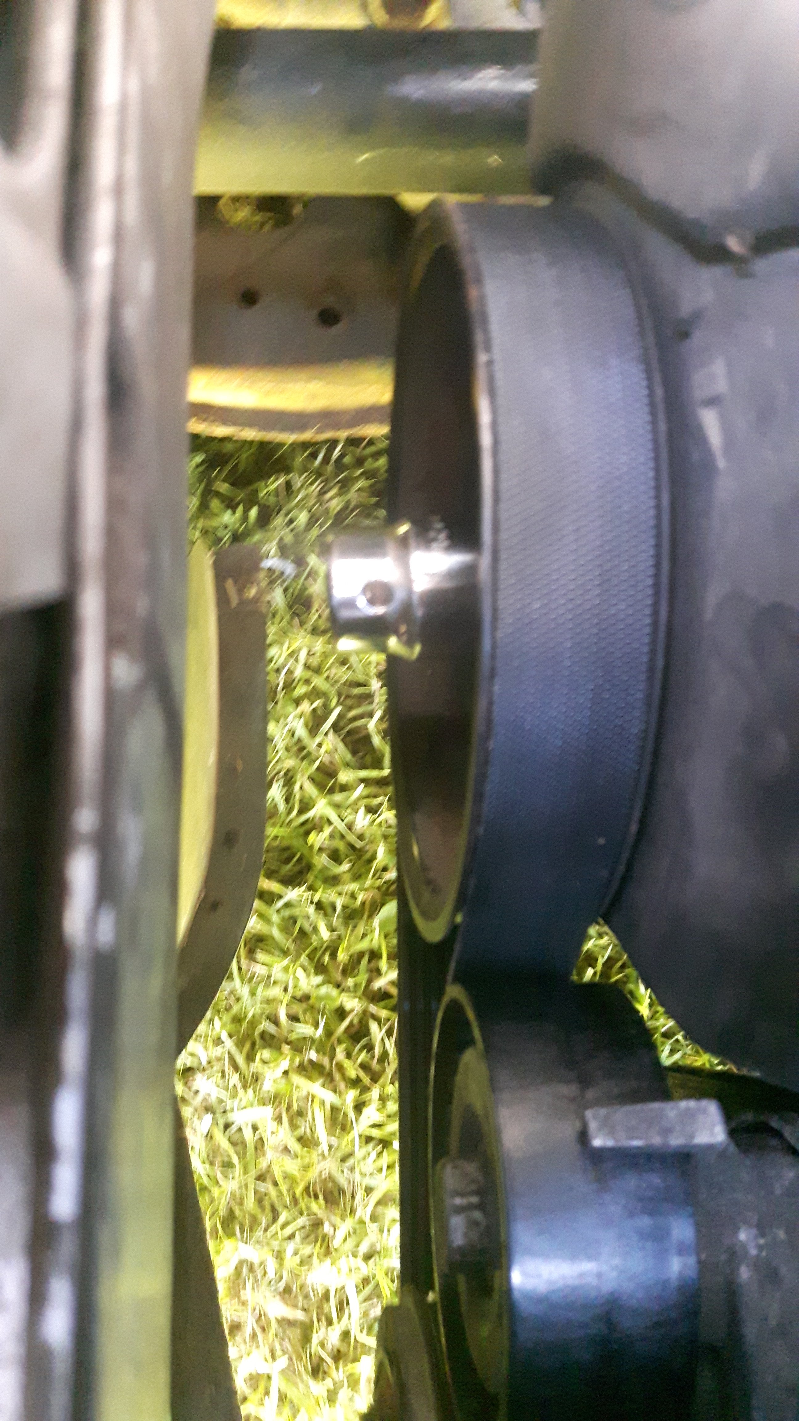

To get in and have a look, i need a special tool for the pulley on the Aux belt. Any tips where to get that cheap?
Also cheap tool for timing belt change?
Its a bit daunting, but a belt kit with pump is a bit over 100 euros. If i scrap the car i get around 100.  Its already standing on axl stands in front, and i have one of these to lift/support the engine
  • Sponsor

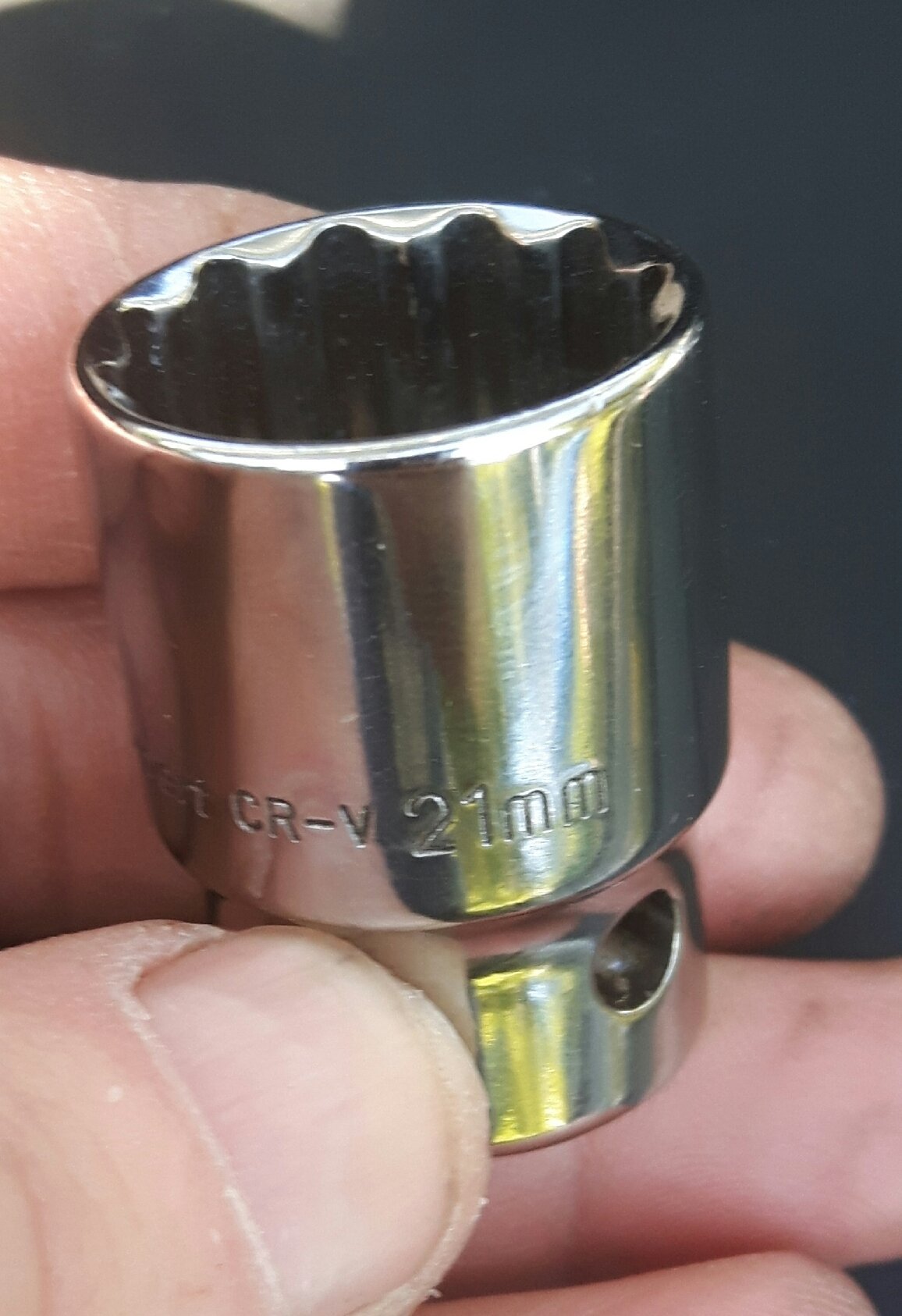

The bolt in the middle of the crankshaft auxiliary belt pulley needs a 21mm 12-point socket on my BKY engine Polo (nearest car to try). Not much room there though, you would remove the wheel arch liner and go  in from the side I think.  I've not done a cambelt/waterpump on one of these, so can't really help much.

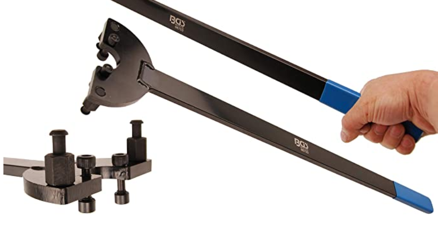

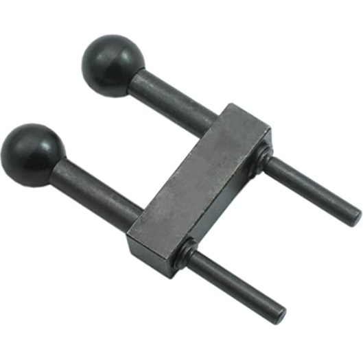

Is this correct,
In addition to standard tools, Torque wrench etc, what i need is:
Special tool 3415
special tool T10016
And obviously a belt kit
Thanks,
This appear to be a good instruction. Also looks like my engine
Thanks, yes the side cover is already off, and will take off the wheel.
From what i see i will need a tool like this
And this for locking the pulleys in position (and obviously mark the positions)
