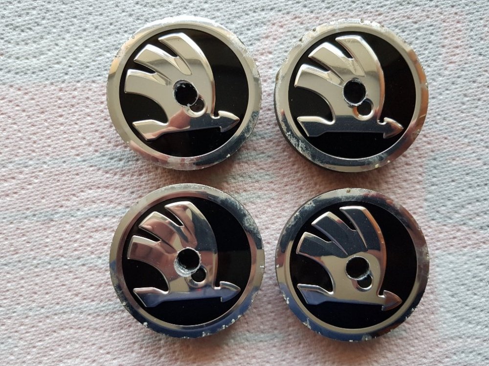

I changed my wheels just over a year ago and fitted new original Skoda centre caps.
I'm very disappointed with them as the edges have blistered already. Rather than fork out for OEM centre caps I've gone for some from AliExpress and also a backup set from eBay.
Photos of the OEMs removed, excuse the holes, I find it easier to drill with an 8mm bit and pull them out with the drill (or an Allan key after drilling).
Please note: the caps look considerably worse than the photo shows!
I paint the edges with the clear varnish used for repairing stone chips before fitting. I think they are made using IMD (in mould decoration) which if done cheaply/badly leaves the  edge of the moulded in label open to the atmosphere.
You can also get the black ('Monte Carlo') centre caps from SuperSkoda that already have a coat of varnish on them; which I've added another layer of clear lacquer to for that very reason. Seems expensive, but they look the part and have no chips on them as of the last 10 months.
Using overly aggressive wheel cleaners makes this much worse much quicker.
