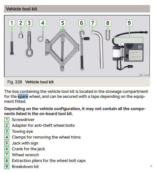

Had occasion to take the jack out today and found a couple of items that I don't know the purpose of.
One is a circle of thick wire with an inch-long arm going off at a tangent which finishes in a small hook shape.
Pulling off a plastic wheel trim if you have steel wheels, maybe?
The other is a screwdriver handle which has a steel rod with two sizes of torx drivers where I'd have expected to find a flat blade and a Phillips screwdriver on other cars.
Any ideas what these might fit?

I recall having a similar tool in my TT for removing the centre caps that covered the wheel nuts on the alloys.
On my Octavia that tool was used for removing the plastic centre embellishers of the alloy wheels which covered the wheel nuts, there was also one of the black plastic long C section tong things for removing the wheelnut decorative caps if the normal style of alloy wheel with visible wheelnuts was fitted to the car.
There are far more Torx fasteners on your car than Phillips or Pozidrive and virtually no plain slotted head fixings.
The circle of thick wire is for removing the cover for the rear lights at the side of the boot opening, and the torx screwdriver is for removing the rear lights for bulb replacement. The cover has to be removed to access 2 torx screws. The screwdriver is also used for removing the front fog lights to replace the bulbs in there too!!
Ah - Thank you so much.
I would never have guessed that, although I would have probably seen it in the handbook, if I need to find out how to change bulbs.

Is there a proper place left in the foam for this screwdriver? I was not able to find it, since it is lying there...
Mine lies in a recess in the foam directly under the wheel brace.
Lift the brace out and it should fit in a slot on the next level down.

Vehicle Tool Kit:
