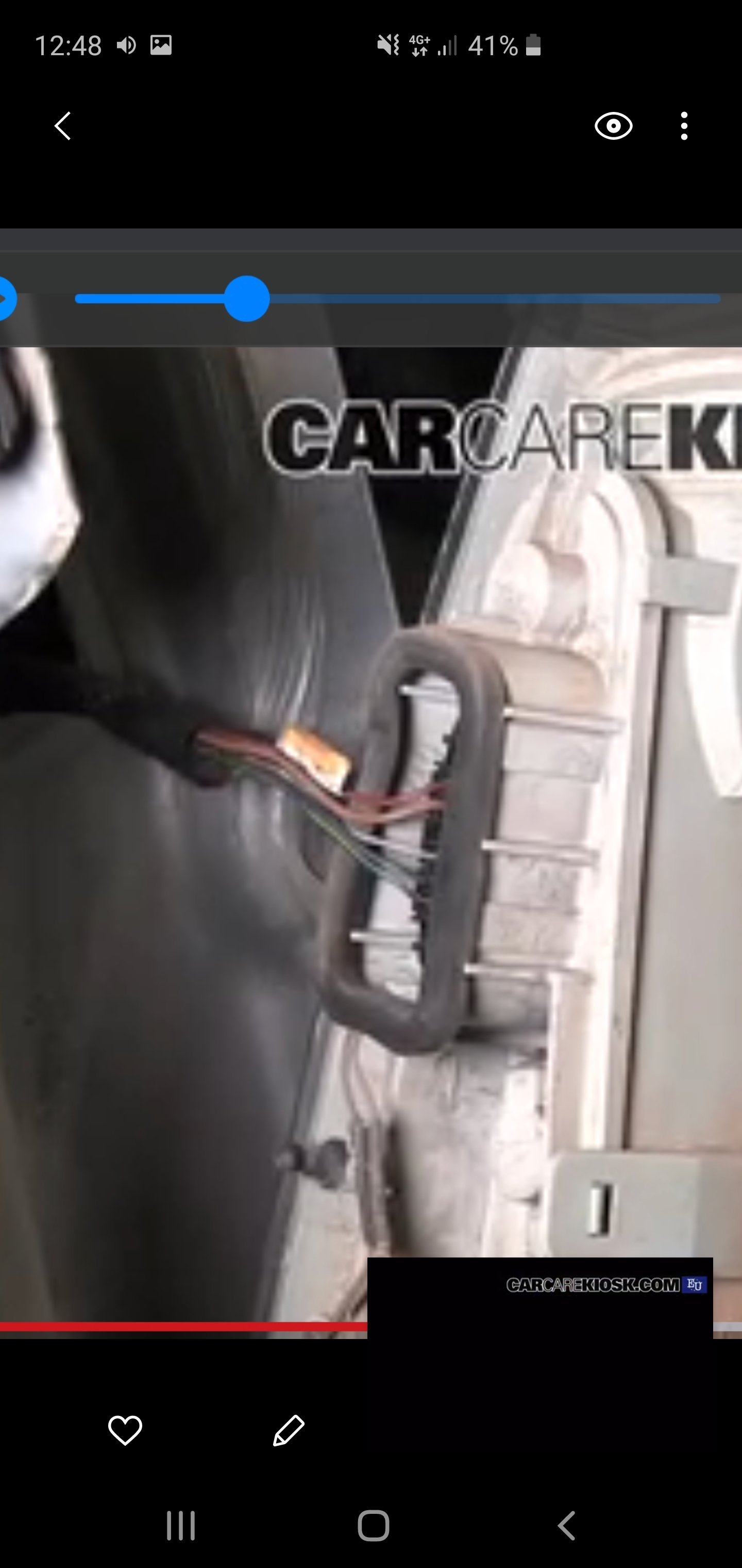

Hi,  try to connect rear camera power to reverse light,please help me identify reverse light positive and negative power,Thank you
12v is the bl / blue wire. Earth is br / re at the rear light cluster.
Thank you so much, I will give it a try👌

Hi, haven't complete yet, I think this best way to do it
Hi Tabasco,
Thanks for the diagram.
I have a rearview mirror dashcam that my reverse camera is connected to, so I have run mine all the way along the head lining. I just can't figure out the way to run the red wire from inside the vehicle to the outside light cluster (I mounted my camera inside the boot). I think I may have to remove the rear quarter plastic panel inside the boot. I hate taking these off though as I am bound to break something and not sure if that is the way the wiring loom runs to the light cluster.
