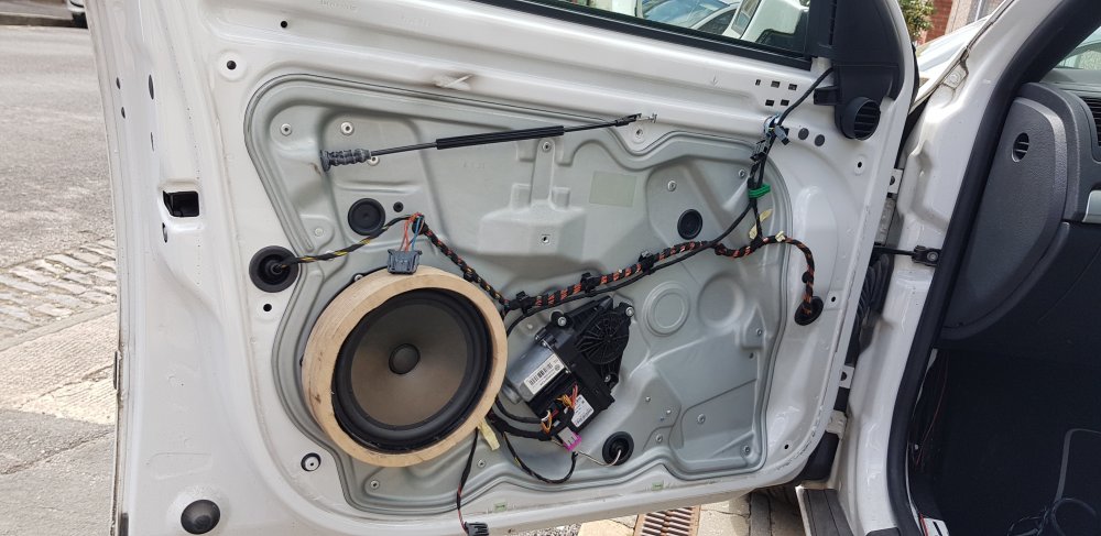

Does anyone know if you can fit 20cm (or 8") door speakers to an Octaiva Mk2 without issues?
I can see 20cm adapter rings for the Fabia, as well as Golf and A3, but I know the mounting locations aren't always identical.
So I answered my own question, if anyone is interested.
Found some speaker rings in the shed that I didn't get round to fitting to my old Jetta. Dropped the door card on loose and it looked fine. Not sure on clearance to the speaker surround, but easily fixable by making the rings a bit thinner.
You can, I ran 8s in mine for a while. Only thing you have to remember is making sure the door trim fits back on. Mine ended up looking rather messy as i had  to keep adjusting them
