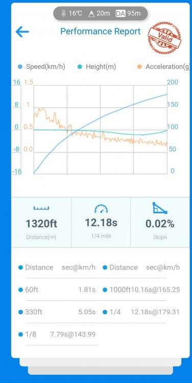

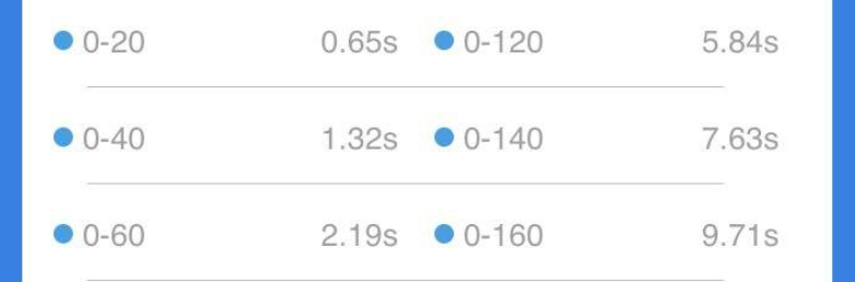

  • I made a recording for a friend who asked to check out a video of the standstill acceleration the other day. The rear camera view is where one can get a better idea of the ferocity of the launchi
  • REVIEW The first thing that striked me after both maps were on the car was the difference in the DSG. D and S were reacting faster when putting my foot down but the real revelation was Manual mod

    Where is the dislike button? No mention of mpg?    Who are we kidding, this is great stuff. Love the dragy data. Once upon a time, 0-100km/h in 4seconds is top of the line crazy supercar ter
