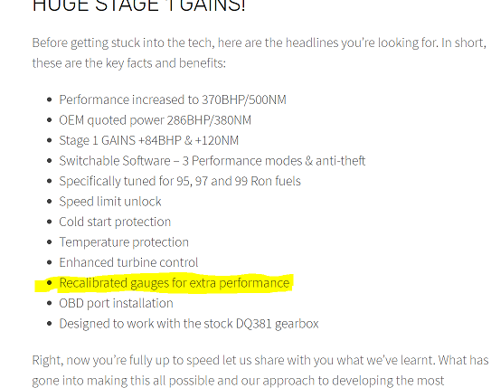

@newbie69 did you ask to change the power indicator? Or was it set directly by Revo?
I didn't ask for it but I realized after I replied to that thread that it's probably part of the remap changes:

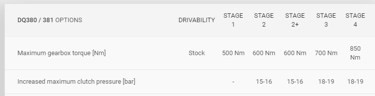

For now I can confirm what @newbie69 has already said. Much more reactive, especially in S. In D I found it very slow but in my case the problem is accentuated by slow spool of the big turbo. Maybe after setting the right stage3 map it will be more comfortable even in D.
Another consideration over my custom DSG map: with increased clamping pressure now I have a more rude upshifting than the original, especially in M mode. But perhaps with TVS this problem does not exist!
It's probably a matter of stage. With the Stage 2+ TVS map all gear changes are smoother under every condition. Dealer had asked whether I'd like to go Stage 3 DSG but he said there could be more harsh gear changes as the pressure increases even more. According to TVS up to stage 2 pressure increases by 15-16bar, whereas stage 3 takes it up to 19bar.
I'm sure you are running a more aggressive DSG map than my stage 2+ as yous should be set up for stage 3 torque levels of 600Nm+,  hence the rougher changes.
For sure it's an aggressive DSG map... even if my final request is not to exceed 550 nm of torque. I'll ask how much has pressure been increased, i'm curious about it...
