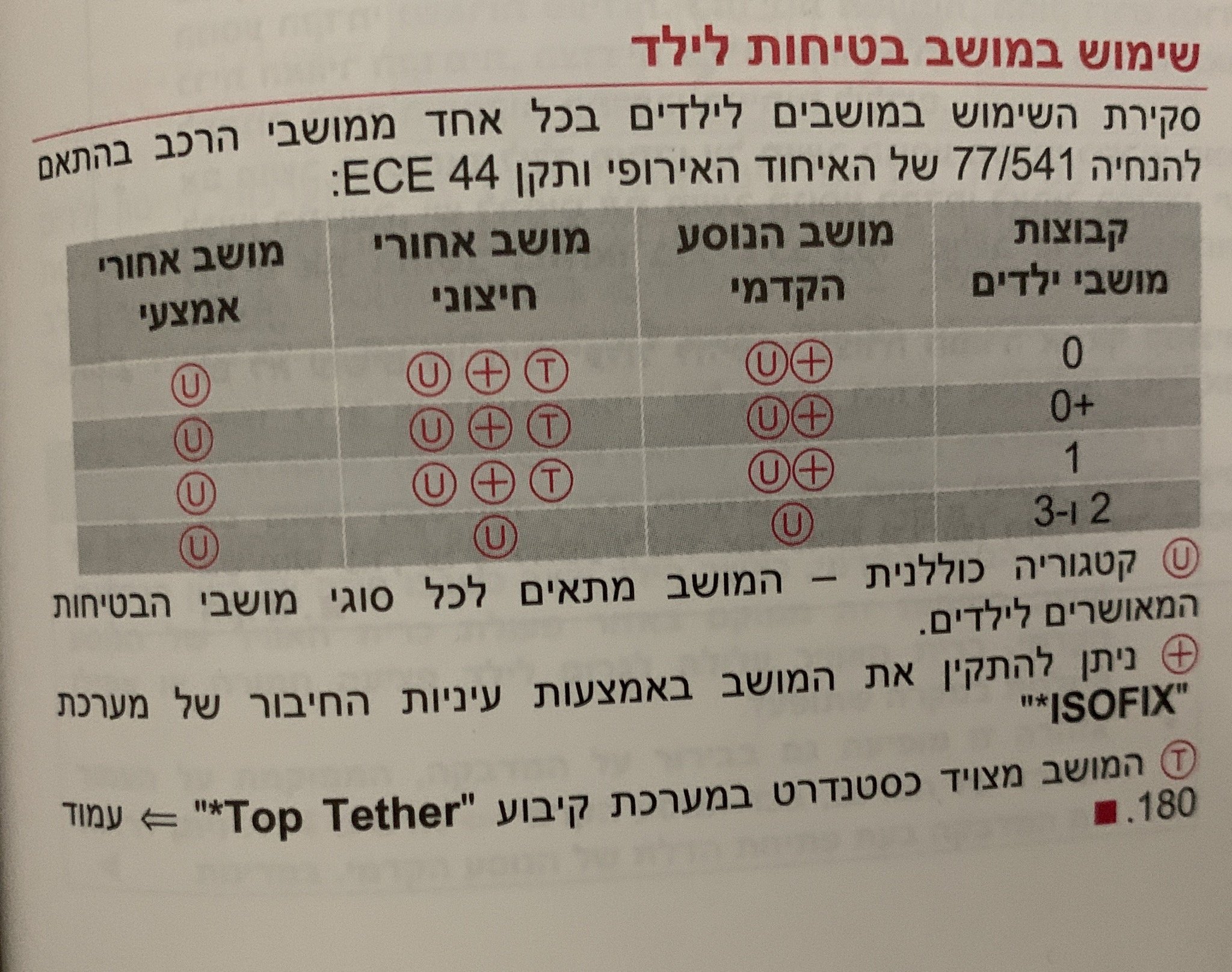

I have Skoda octavia 2009 FSI 1.6 Automatic
i try to connect to the isofix baby safety chair to the front passenger seat, and I don’t find the anchors.....
l take a look in the car book and it’s look like the car support in isofix in the front seat
someone try to do that and succeeded?
how I can do it?
Thank you!
You can't - It was never fitted to the front seats as standard.
It is still a factory option on new Skodas.

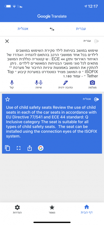

In the car book write that it’s support, I add photo from the car book, it’s in Hebrew but it’s say that each east expect the Center in rear seat support in isofix I add also google translate
I have a similar chart to yours and the middle symbol (+ in a circle) decodes as "the seat can be fitted with fixing eyes for the isofix system.) In the UK it is not a standard fit.
However, the U symbol means "Universal Category - the seat is suitable for all approved type of child safety seats."
Probably cheaper to get a secondhand universal child seat that getting a dealer to install isofix to the front seat.
Too bad
So they write wrong things!
I expected them to be more accurate
Thank you

Erm, no... They just have one manual that covers all features including optional ones ;)
So use the word ‘optional’   🤷‍♂️
He did.

The manual usually shows the highest spec model but does state in most sections that not all vehicles will have all the equipment seen in the diagrams. For example I have an Elegance but the manual has a lot of diagrams showing equipment that was not standard fit in my car, such as heated seats, xenon headlights etc.
