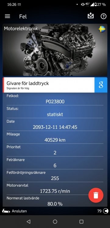

Error code P023800
This has something to do with the Turbo load pressure.

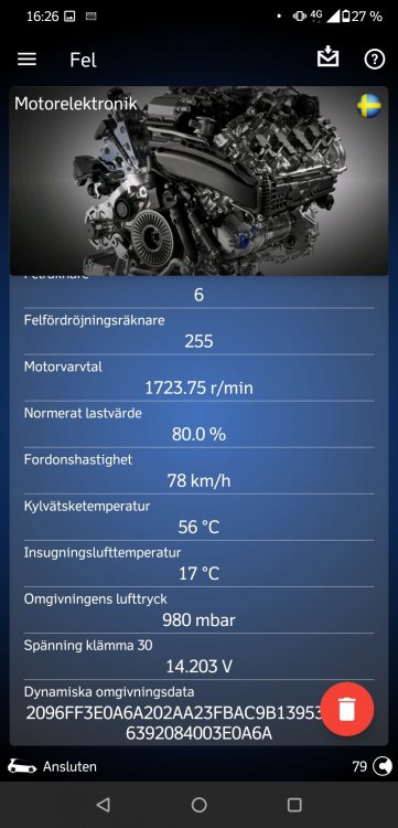

Please excuse, the image below is from OBDeleven, but in Swedish. Perhaps someone can tell what is wrong and what I can try to fix it. The car has today rum 40530km, and the turbo is already broken? And also, why is the date saying year 2093?
Errors on dash is the orange engine symbol solid light and the diesel-warmer-symbol (lol) that goes out when the plugs are warm, it is flashing.

So, I found this:
http://wiki.ross-tech.com/wiki/index.php/16622/P0238/000568
That tells me that it is the Boost Pressure Sensor, just like the error code. So, I took out the sensor, easily located (see picture - 2x T30 - just disconnect the wiring first, unscrew it and wiggle-pull it straight up with slight force), and it had drops of diesel on it. I cleaned it but that did not help, so I ordered a new one just hoping this is faulty. I've read some scary things about these sensors (I THINK they are called MAP-sensors in english), part no : BPK 03G 906 051E , that if they are wet, some membrane is damaged and leaking and I can just toss the car into a fire because the engine is so damaged... But I refuse to believe this and I think that it is due to the higher air-pressure flow and more air in the engine that some diesel that is not combusted slips through when this sensor started to be electrical faulty and then it just got worse.
If it is not this sensor then it has to be some other sensor, obviously. I'll try the Mass Air Flow later if replacing this does not help.

The strange thing is that OBDeleven tells me the same error even with engine off, that should indicate broken sensor, right? If the same error comes up without even starting the engine.
