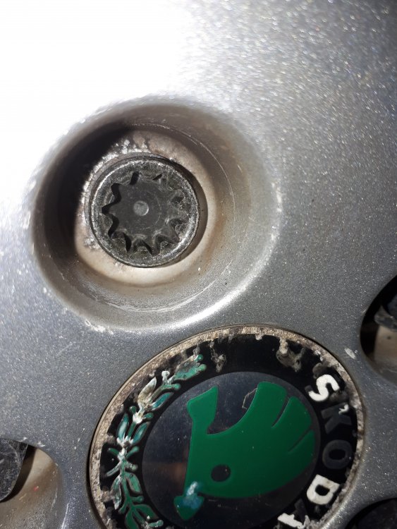

locking wheel bolt with picture finally.
Apologies for re posting although I have added the picture (which helps) to my original post this morning its not so noticeable to  members.
Anyhow here it is.
If anyone can advise which fitting it is , have researched tinternet and seen some 10 spline keys but not sure if they are correct.
Cannot take car anywhere so a bit snookered.
Thanks
Martin

1 hour ago, vindaloo said:
It's not a spline bolt. Or a star or a torx. Those are 6 or 12 point. That thing is a ten point.
Closest match on eBay is this...
https://www.ebay.co.uk/itm/Alloy-Wheel-Tuner-Bolt-Nut-Removal-key-10-point-Star-Drive-Tool-/171556422706
I think short answer is get it out and replace it with either a normal wheel bolt or official security bolt.
Shouldn't be an issue for any tyre place or garage either.

In which case be careful and don't screw up the bolt head. If you have an impact driver or can put direct pressure on the tool into the socket, great. If not, a long ratchet handle and a minion's foot/leg bracing the ratchet head whilst they're supported by a wall or another vehicle etc... Arse on gravel won't work, butt slides backwards, need to brace.
Yes will make sure I don't mess them up and don't have air tools-not a big fan.
