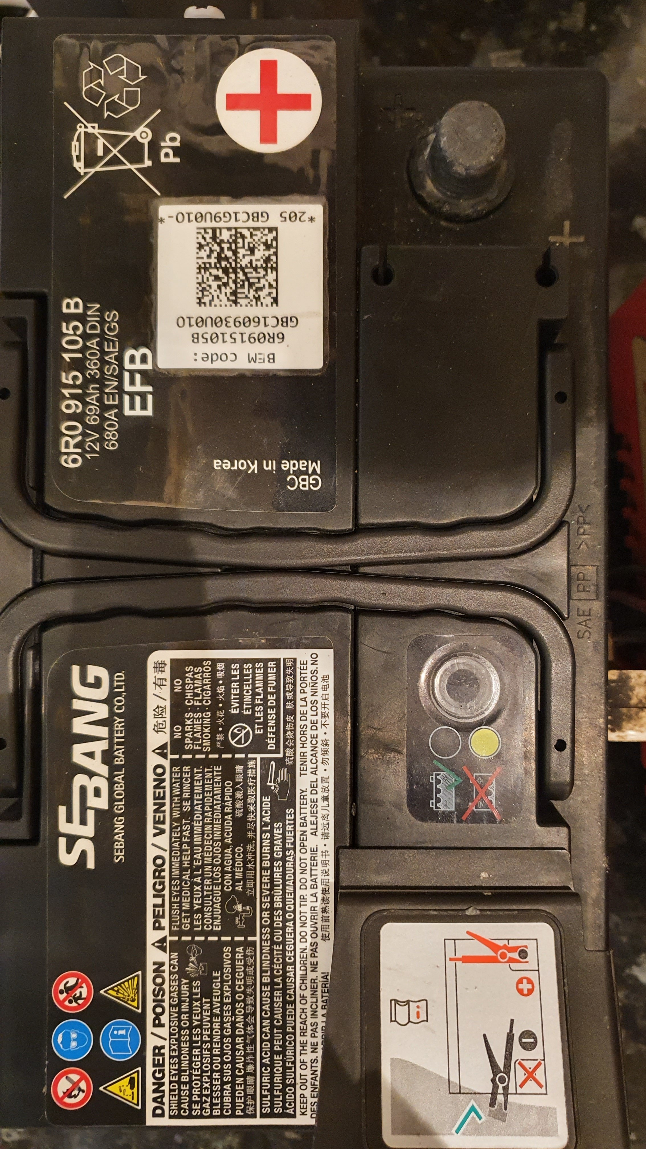

I've since had to take the battery off to charge it another 4 or 5 times, so I think it's time to bite the bullet and just get a new one, can't stand not knowing whether or not the car will actually start! 😡
Can anyone recommend me a battery and a decent supplier for it please? The current battery is EFB, but I'm going to change it out for an AGM.
So am I right in that I'm looking for a 096 AGM battery for a 2017 1.4tsi pre-facelift? Thanks in advance.

My 2015 1.4TSI doesn't have an 096 battery, it's a smaller one - but I do intend to fit a Varta 096 AGM battery when the current one fails, which will need a larger fabric cover to fit (which I already have).

My current battery isn't 096 or AGM, but I think that's the way forward unless someone tells me different?

I replaced mine in a 2016 vRS for a 096AGM Halfords (Made by Yuasa apparently)  battery and it works perfectly. I had to borrow a diagnostic machine to change the coding to recognise the new battery as AGM, but I am very happy with it.
When changing the battery I disconnected it completely and had loads of errors come up, but after driving a short distance they cleared, which is normal :)
I went with the Halfords one for ease of return if it ever develops a fault (Has 5 year warranty). I can get the car started or towed to Halfords and get the battery swapped straight away :)

I replaced the battery for my vrs tsi last week. I phone up Skoda Winchester just for a laugh and was surprise it was only £140 for a battery for them.
bought it and replaced at home. The only thing I had to do is change the Ah rating using VCDS from 69 to 70. The original was 69 so i guess it came out of the factory with that.
Did you reprogram the serial number too, so that the car knew you had fitted a new battery?
correct yes. However I highlighted the ah setting as it was interesting that the car had come out of the factory with a 69ah and now skoda recommend a 70ah.
