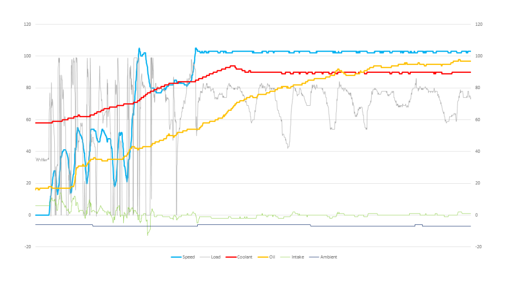

I have to drive to Helsinki Wednesday. I will try to set things up that I can log oil temp. Should be about -5C at start and be below freezing most of the way down. Lightly loaded and with limits at 80 / 100km/h that should give a decent indication of how fast temp goes up and where it gets to. I will see if I can log ambient, coolant and oil temps.
@ApertureS you have VCDS too, no? Could you do the same for a short trip of say 10-15miles at reasonable speeds and post the results? Would be good to see what a higher ambient does. I expect to be towing in the summer 1700kgs of caravan for a while, will attempt to log that too.

So, a log is attached from the first 15-20 mins of the trip down yesterday. You can see ambient was around -7. Aux heating was on for over 20 minutes before getting in the car; load doesn't seem to make much difference to heating speeds. Note also that oil lags way behind coolant. First few minutes is town driving, then onto the motorway, slowing for roadworks and then back to cruise clicked in.
This was made with some excel magic (mainly the formatting of numbers) and Carport's logging. I note with interest that the speed is the correct GPS speed, not what the speedometer says.
