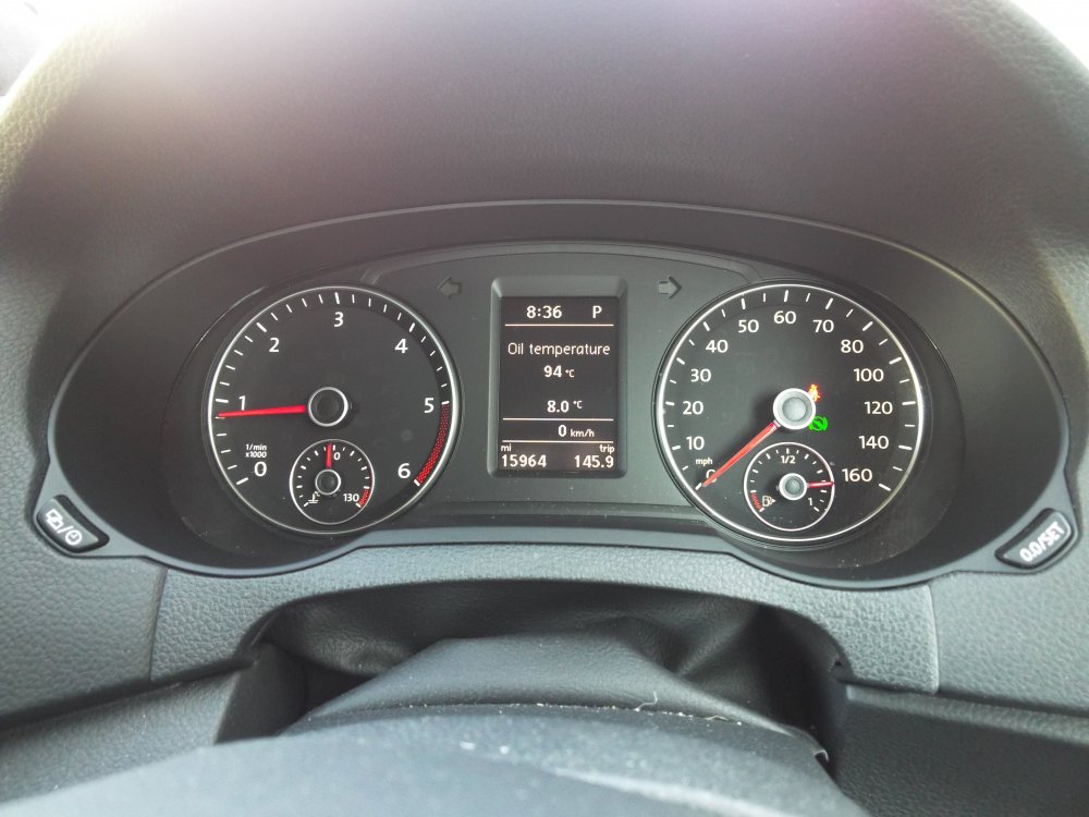

Hi guys, I have a question which bugs me. This weekend I was visiting my sister which is 250km away from me. I took my superb on a nice trip. The car went beautifully and I made it without stop on one take. The thing is, that after I came to the destination I have checked the digital oil temperature and it was saying 102Celsius. I was immediately surprised, as far as I know the oil temp should be MAX 90 degrees. The needle of oil temperature on dash was straight at 90degrees. So I am confused here a little bit, needle show 90 but the digital oil temp show 102-105 degrees.
Today when I was going to work, the oil temp was at 90-92 max. Also I have noticed that often times the needle shows 90degrees but the digital oil temp is still only on 70degrees.
Does anyone know why the oil temp went so high? All of my mates told me that it never should happen even when I am on driveway and running over 2k RPM (2200 to be specific) the motor is 2.0TDI. It makes me worry.
Every help and advice is appreciated, Thank you guys :)
Your mates seem maybe to not know that much about Cars and Engine Oil temperatures.
Coolant is normally a Needle on a gauge and goes to 90*oC. (Unless there is overheating of the coolant.)
Oil is usually a number on the 'Oil Temp' readout after it goes above 50*oC.
**That was the 102-105*oC you read at the weekend.**
How far was 'going to work'  and what was the ambient temp?
No idea where you are!
The normal / efficient oil temp when the oil is up to temp is in the 90-92*oC indicated.
The oil temperature can rise into the early 100*oC -115 or so as the ambient temp and speeds are getting higher.
The coolant at around 90*oC is to cool the oil. So as oil is hot the car / system / coolant / fan / oil cooler is bring the temp down.
If you are driving in normal weather as on above freezing temps, and a TDI's oil is not up to above 80*oC to 90*oC after 15 miles something is wrong.
The temp gauge on the dash is water temperature and normally sits at 90°C it is also normal for the oil temperature to read higher. The highest I ever saw on my previous Yeti was 118° C
If you are driving for many hours on a warm or hot day, then the engine oil will warm up to the temperature of the engine block.
The cooling system is probably running at a similar 102-104c  (its pressurised so will boil at more than 100c), but as metal is a good heat conductor wouldn't expect one part to be significantly different in temperature after few hours
