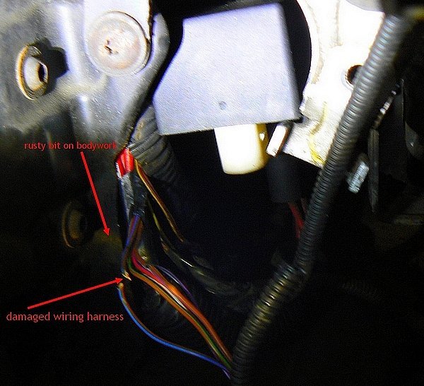

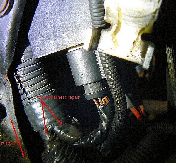

Hi Geof, did not realise that was you! Did you ever get to the bottom of the fan running incident? I was just mentioning the fault on a different Skoda model here.
I usually fit Bosch ones myself, as with oil, fuel and cabin filters. Just a preference. Cheap enough and delivered from carparts4less, with a code.
it was diagnosed as a fan contoller open earth/wiring fault
i got it fixed at my home by a mobile engineer for £125

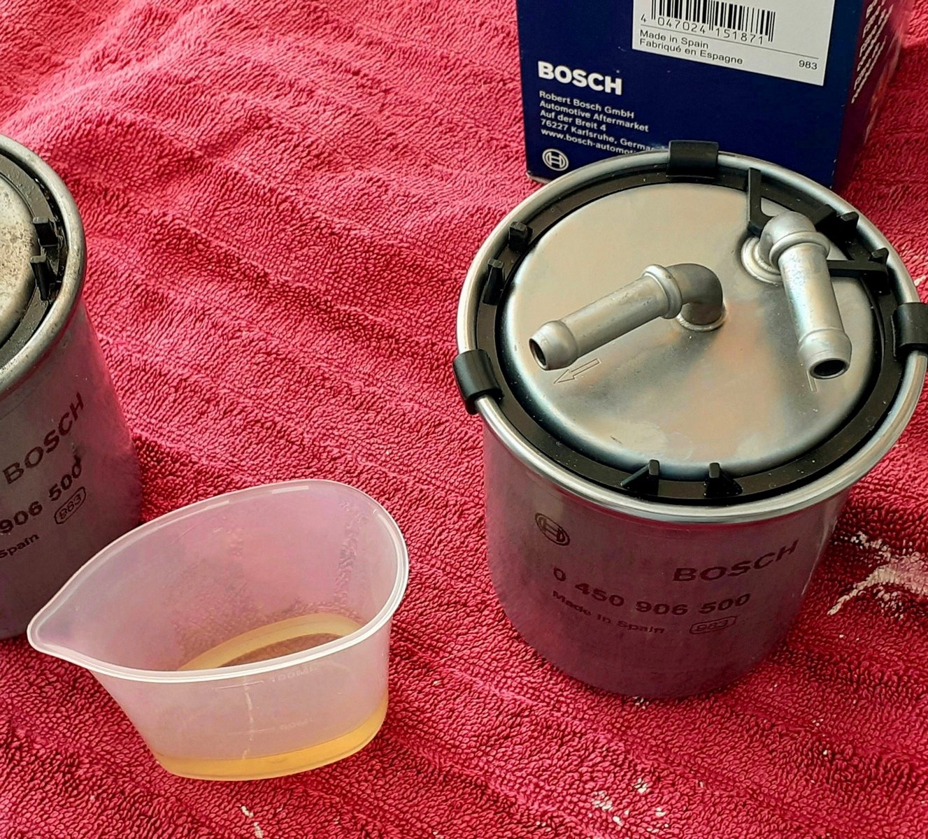

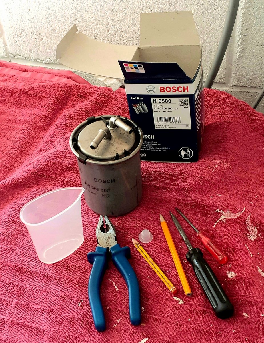

...I think your engine is very similar to mine. If so, the fuel filter is quite a simple swap, with a small amount of mess and no need to bleed the diesel system at all.

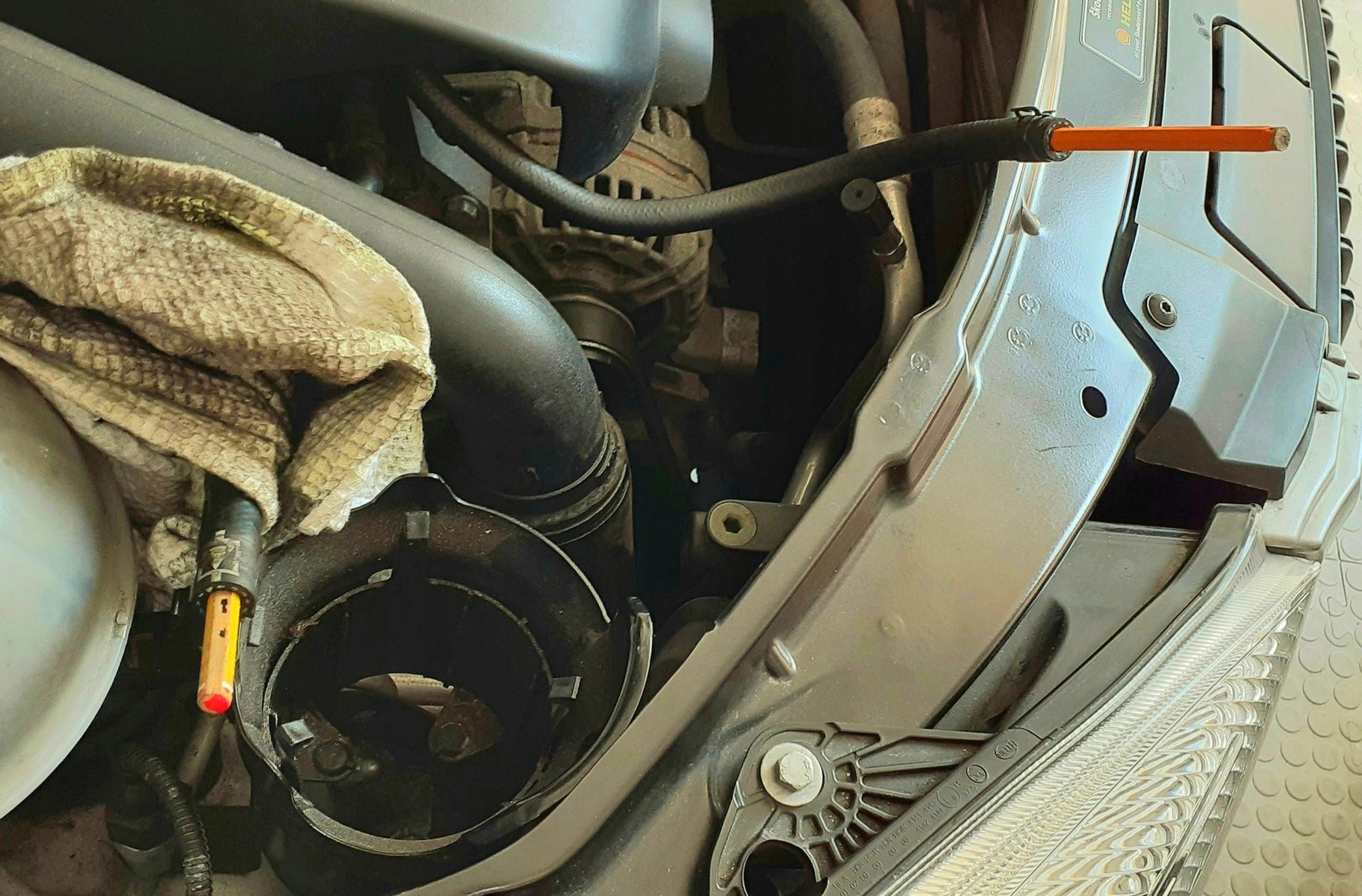

yes.. i was under the assumption that if the new filter wasnt primed then an air lock might occur and affect the injectors....?
i went ahead and with some fresh diesel primed the new filter with about as much as i could coax in with my little jug and fitted it with no issues....
can say priming was easy and a bit of a chore...would be glad not to do it...i didnt three years ago when i first got the car...no problems then...
so
here are my machinations to do the job which is really a lot easier than doing the cabin filter which didnt fit the frame to well and i had to trim off 1/2 a "V" of one of the ends

i used pencils to fuel lines to and from the filter thinking diesel might pour out...another miss apprehension i guess
all done anyway
