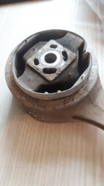

  • Yep, very pleased with it. I think the dogbone mount is 'code F' though, and am waiting on a new one, probably Wednesday arrival/fit. I think then I'll really be able relax, put my feet up and say to
