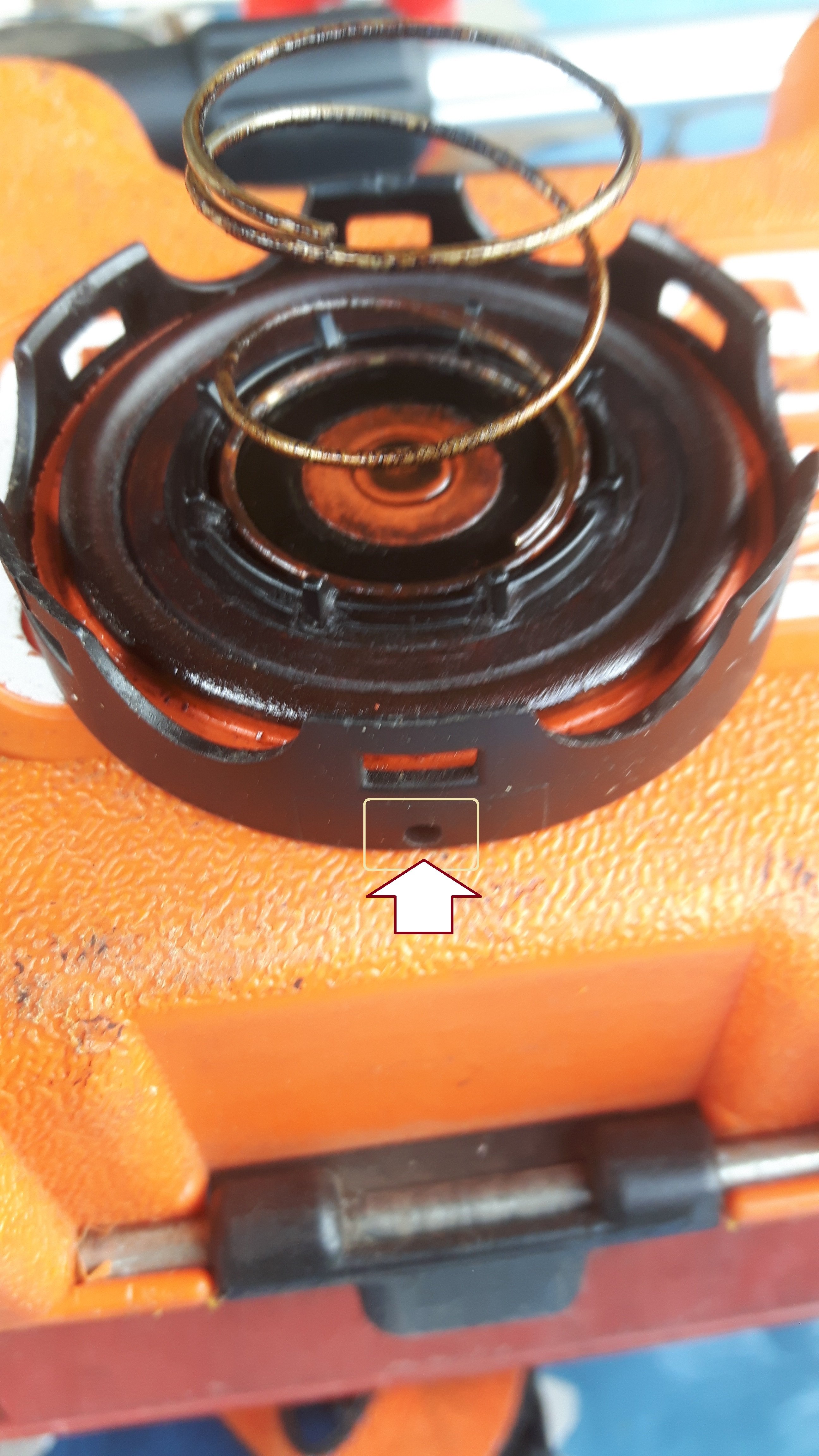

@sepulchrave mentioned air leaks early on, and I didn't do anything with that suggestion except have it in the back of my mind as something I should check.
I found myself staring at the PCV valve and a dead easy experiment occurred to me.  With engine running, I put my finger over the pressure-equalising port, expecting to maybe feel a bit of oscillating air but not to have any effect on the engine.  That didn't happen.  As soon as I put my finger over it, it stared squealing loudly, with frequency diminishing with time, and the engine bogged down and cuts out completely if I keep my finger there.  Veeeerrrrry interesting.  That port shouldn't be sucking, it's supposed to just let the diaphragm move in response to inlet vacuum levels, which would be harder for it if the space above it was a sealed cavity.
So I borrowed the diaphragm/spring/lid off one of my Polos (different breather arrangement, but same type of PCV valve). Bit of a battle to unclip it down the back of the Polo engine, but plug and play onto the Fabia.  Now if I put my finger over the pressure-equalising port, it makes no difference to the engine running. And it makes no noise.
That could be the end of this! Thanks sep.  :)
Lots of test driving to do to re-establish confidence, but I have a good feeling about it.    During a shortish test drive just now, I even think the brake servo function might be better than it has been for some time, possibly because inlet vacuum isn't being spoiled by breather malfunction when the throttle is fully closed? The owner has just taken it on an urban drive; I'd be over the moon if she notices the brakes are working better (and if the car runs OK! :laugh:)

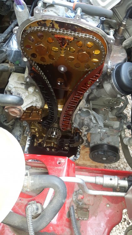

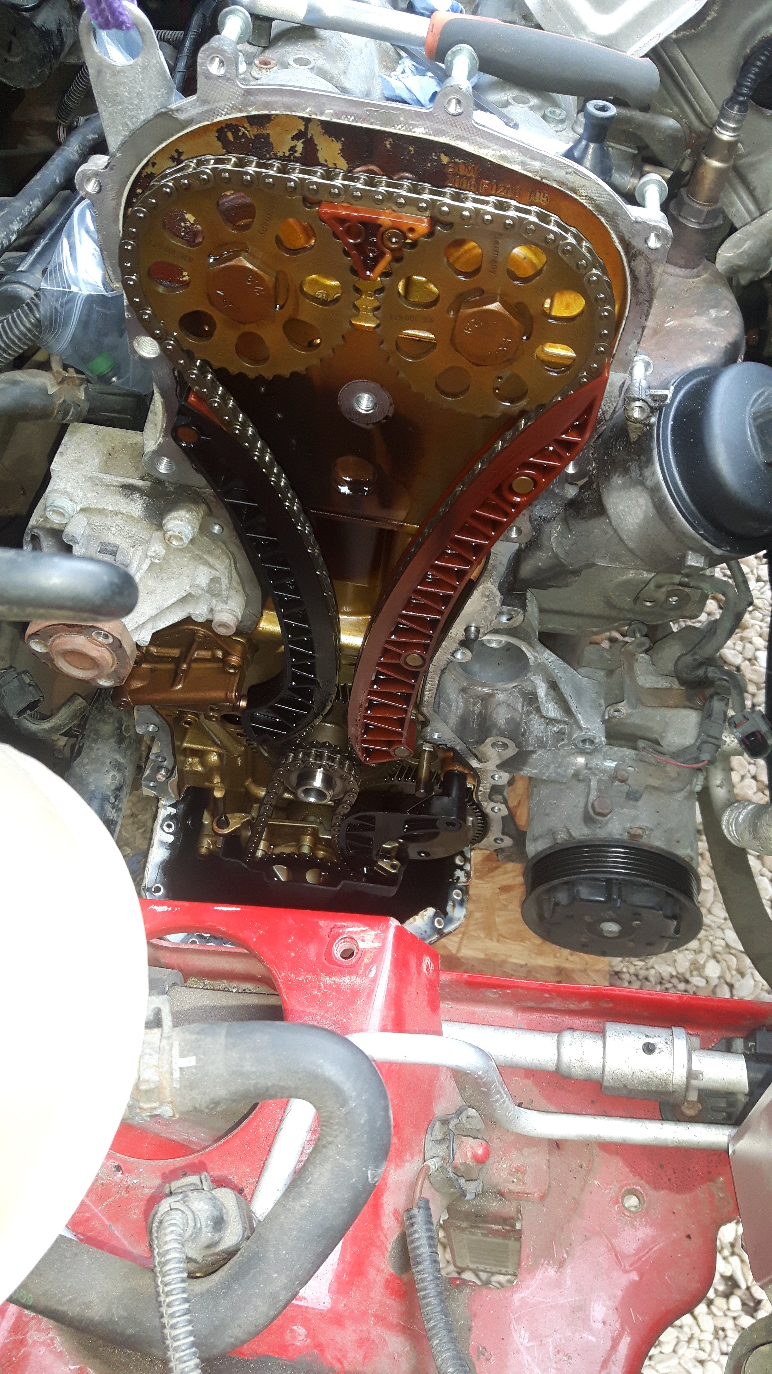

Well overdue for an update on this.  I think it  is going to be time for a refurb, but not the one I expected.
The leaky PCV system fix has made it run without fault codes or warning lights, but the extreme judderiness of moving off unless revs are first spiked remains.  I experimented with blaming the clutch hydraulics but got nowhere fast other than to confirm that for some reason all the clutch disengagement/engagement happens at the very bottom of the pedal travel, for reasons unclear. I (now) don't think that is actually anything to do with the strange behaviour of the engine.  Will be playing about with extending the slave cylinder actuator length in due course as a possible fix that doesn't involve gearbox off.
Endoscopic inspection of the exhaust valves suggests nothing obviously amiss there, but the elephant in the room - I think - might be the timing chain.  At 175k miles with no record of it being anything other than what it left the factory with 15 years ago; surely it's getting tired?
If you've seen one of these chains, and the sprockets it runs on, in the flesh, you'll know that this is barely more robust-looking than something you'd find on a pushbike.  the tensioner is also pretty primitive, with no ratchet mechanism to stop it being pushed back if the forces on it aren't balanced by oil pressure.  I've had the full kit of chain/sprockets/tensioner/seals/bolts kicking about for some time, so there's little to buy.
I've recently stolen from ebay (£12.50!) a much more recent oil pump of the right part number, which incorporates the pick-up strainer and is immaculate, so that will go on too, and a coolant pump that I similarly acquired a while back may be included in the refurb too, although that isn't camchain driven so needn't be done simultaneously.
Got myself mighty confused earlier trying to research the (biiig) crankshaft pulley counterhold tool, which I'd seen used on youtube just this morning by some German fella working on an AWY engine, but couldn't find any reference to it in the erWin literature for this engine (AZQ).  Everything official seemed to suggest that the crank locking tool that inserts where the crank sensor goes was all that is required. Now I've never fitted that tool, but I home-made one about 8 years ago, not long after acquiring the car. It's just mild steel so I'm not sure I trust it against the 150Nm + 180 degrees tightening regime for the crank bolt. I suppose it has a good amount of leverage at the periphery of the flywheel, but I might play it safe and invest £25 in this: https://www.ebay.co.uk/p/1845066239
The reason for my confusion turned out to be that it is specified for the same bolt on the 1.4/16v engines, and had been discussed recently on here.  So I'd have it for whenever I get round to either of the overdue cambelts on my Polos...
@Tech1e, I should just buy that, right? :)
Edited by Wino
  • Sponsor
Made a start yesterday, and I'm glad I bought that counterhold tool.
Early setback hit me when having got the inlet manifold off, and the crank sensor out (with a fair bit of wiggling and wriggling), the locking tool wouldn't go into the big hole in the block.
The aluminium of the casting has suffered that furring/oxidising over the years and narrowed that hole down a fair bit.  Access to clean it up is challenging, even with inlet mani off.
Decided to lock the cams and then feel for the slot in the flywheel with the biggest Allen key I could fit in there. Turns out the slot is about 5mm ahead of correct alignment, as far as I could judge with that crude method. That seems consistent with some, but not much chain elongation.  I carried on and got to this point yesterday:
The sump is loose but just hanging off a couple of screws. Tensioner part number ends in an N, and cam sprockets are date-coded late 2004, so it's fair to assume this is the factory original timing kit.
Big decision now is whether to swap out head and cam stuff while I'm this deep into it.  Have a feeling I'd regret not doing, as the first step of the head job is to get to this point...
