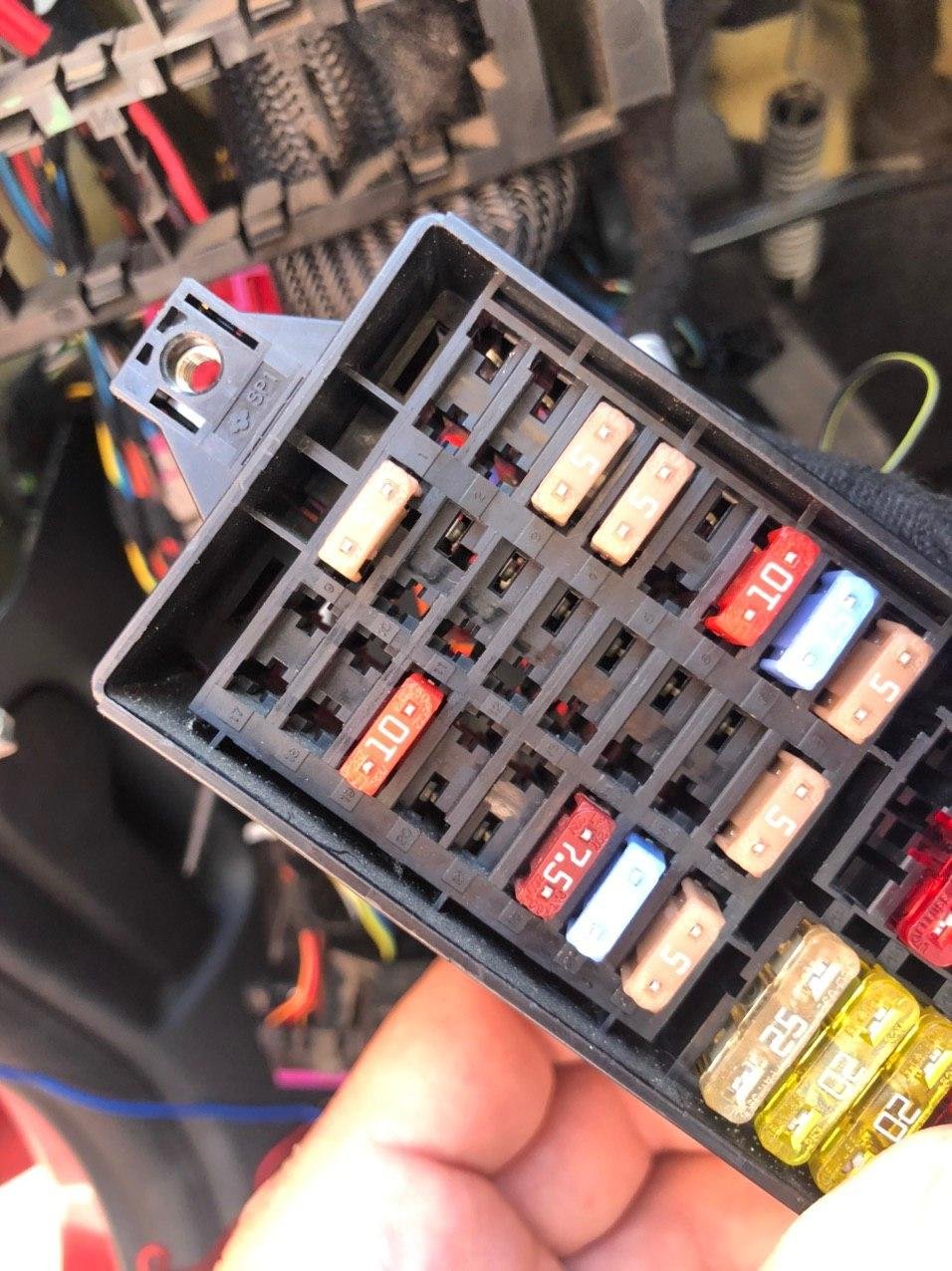

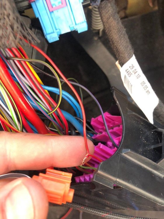

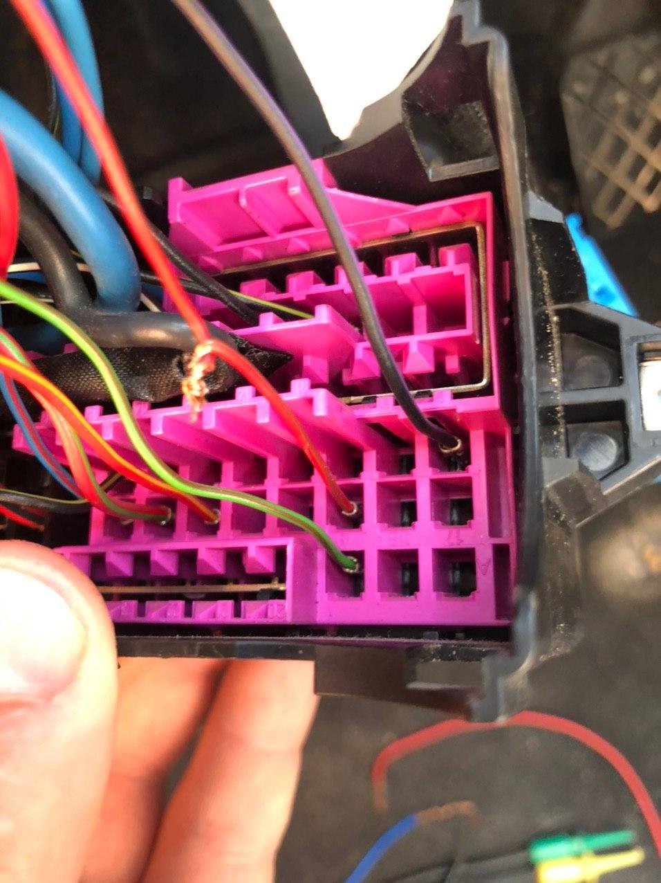

First of all - I found the additional wire, that wired into the Positive 12V ignition wire (see attached image, red repaired wire). I have no idea, what is it for, but the additional wire then goes to audio system connector. I don't think it makes any sense for fuel pump issue.

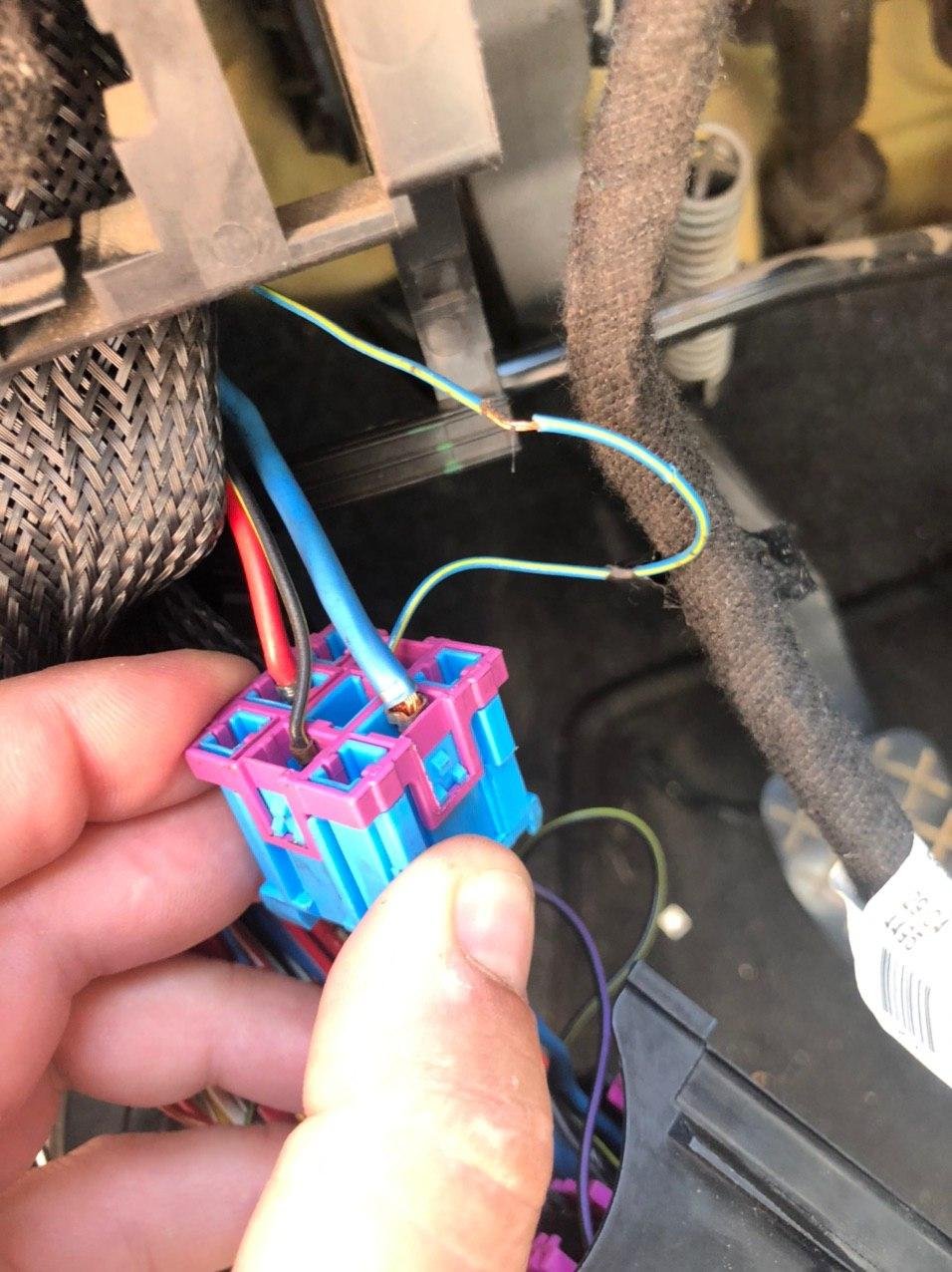

More interesting thing is that I found additional wire  from fuel pump relay ground wire - to ground in audio. What I found now is that when the ignition is ON (key in position 3, but the starter is not working now), we are getting ground on audio system. That means, that relay will be turned ON. But if I try to check the original ground wire on relay - there is no any signal. No ground, no +12V, nothing. That drives me to the idea that my ECM (ECU) died. So, I tried to replace it. But that made no any sense - the problem is the same. I double-checked all wires - all looks good. I also tried to check all fuses, I checked fuel pump (actually, I replaced it), and I also checked relay. So in a short:

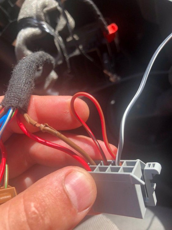

So, I attached the audio connector with all additional wires.
The brown one (with cut) is the one, where ground signal from relay was wired (find blue-yellow wire in photo with blue-purple socket for relay, last one in previous post).
the white-black is the one, which comes from broken RED wire (ignition) from fuse box. (find red broken wire on first photo in previous post. Also, it is the same on third photo - it comes on fuse with '10' in bottom line).
